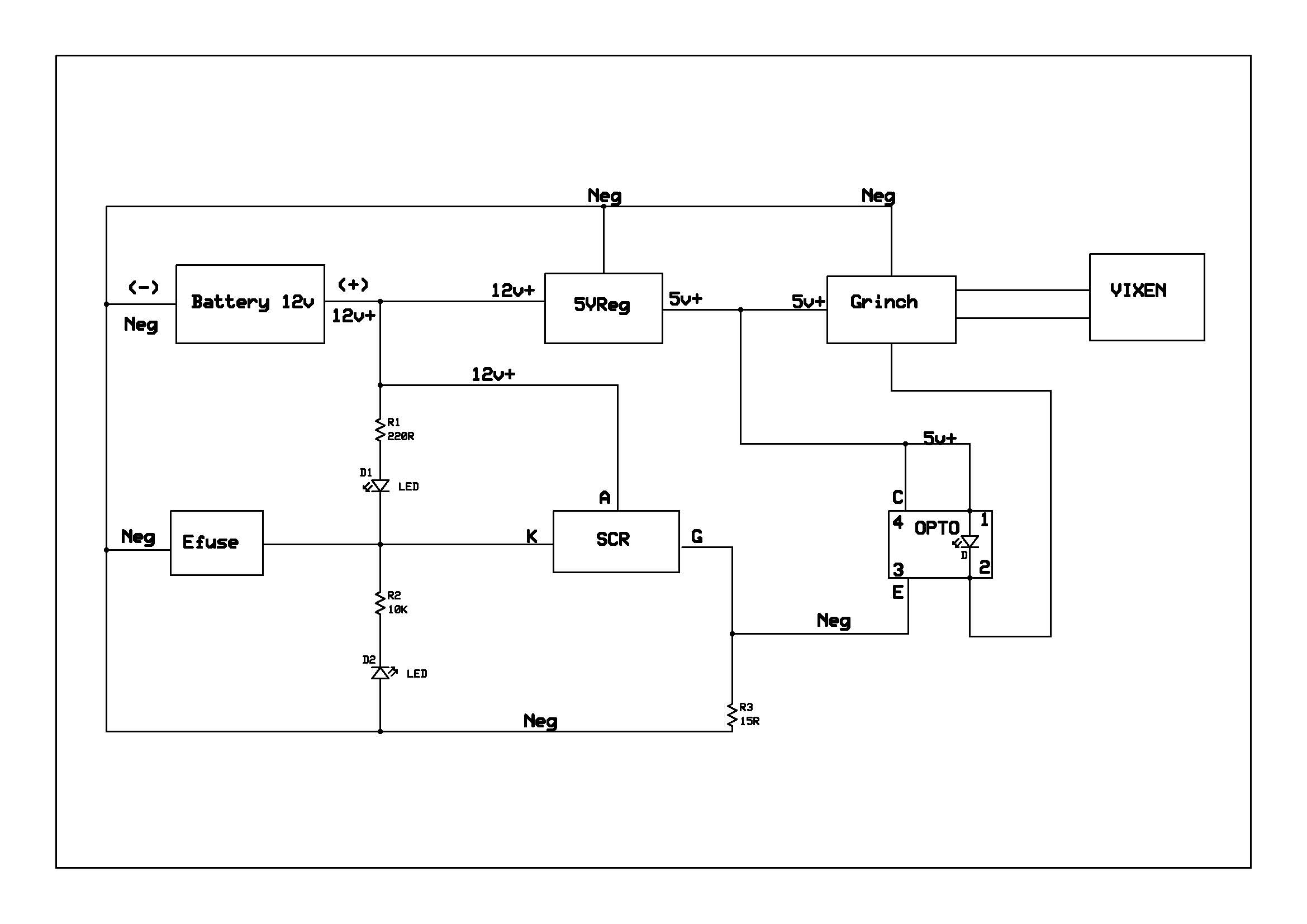

Make Rext 1.5K to 2k ohms and remove any resistor in series with the input to the opto coupler.
the one that can only handle 60mA. I dont have to computer I was using before so i dont remember to part number.
K817P Opto.
Like this.
and make Rext 1.5k to 2K ohms.

With no Rext on the led driver there is no current to turn on the led in the opto. so the scr won't turn on.
Rext of 2k will supply 10 ma for the opto to turn on. (no other resistor required)
The resistor to the gate will limit the gate current.
The opto in your diagram looks like it is wired wrong. Make note of the dot in my picture. That is pin 1.
BT258X = 50 ua typical 200ua max. so we should have >1 ma. with the resistor? Where did you see 330 ma?
As i said a long time ago in this thread the 15R resistor is a bandaid to a problem, and you still insist the 15R is needed.....find and fix the problem and loose the 15R resistor.

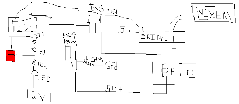

I have not been able to open any of your files to see the setup you have or how you have connected things, but if Ronv has and surgests you have the opto wired wrong than that might explain why it wont work as it should.

Geez??
Its not real clear, so i redraw it just so we can understand if we are all on the same page.
As Memphis has trouble understanding symbols i used a block schematic approach.
Memphis can you check this and comment if it is the same as your wiring at present so we know what you have NOW.

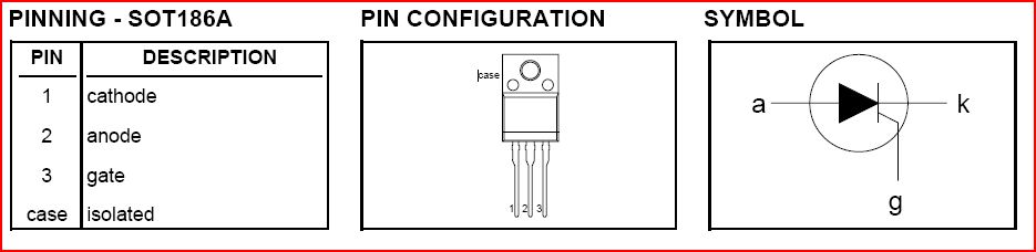

The other thing is if you have wired things as you have drawn them, then the SCR might be wrongly wired on the pins, so have a look at the other snipit from the data sheet i post here and see if you have the pins correct on the SCR.

Ok, so maybe the opto is wired wrong. But i do read 5V+ as though everything is working as it should. I have it wired just like SAborn had in the picture he first put up. Looks as though y'all have both 5V+ coming in one side of the opto, as I have one on one side, and one on the other. I think it just cant over come the 15ohm resistor. Do you see now why I need it? The LEDs make the gate very sensitive.

AND the 15ohm resistor is what makes it turn off..... if that wasnt there the SCR would stay on the whole time.
There must be several problems with your hook up. How about we go all the way back to Grinch and see if all is well there now that you have an Rext. Remove the opto from the circuit and add an led to a Grinch output with the cathode to the output pin. The cathode is the side with the flat on it. Put the other side to ground. No resistor should be required. See if you can turn the LED on and off with your software. If you can we can go forward to the opto.
