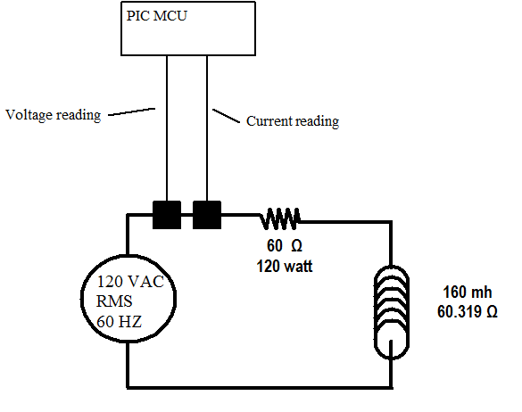

Hello forum,
I have been reading some lectures in this site and I have a question about obtaining the apparent power, true power, reactive power and the power factor of an actual AC circuit.
Basically I am wondering if someone can take a quick look and evaluate or validate that what I am doing is okay.
Let's say I have an 120VAC, 60HZ, RL circuit comprising a 60 ohm resistor and a 160 milli-henry coil. This circuit will have two outputs that will connect to a micro controller. Please view attached schematic. One of the ouputs will read the instantaneous current and the other will read the instantaneous voltage (both at the source of the AC circuit). To read the voltage and current, we will build a small circuit that will convert these values to an analog voltage signal so that the micro controller can read them. Therefore, we do not care about *how* the instataneous voltage and current are read... for example purposes, for now, we just know that the micro controller is able to read those values.
So, if we are able to read the instantaneous voltage and current values into the micro controller, then we should be able to calculate the RMS voltage and currents. So for the sake of this example, lets say we are reading an rms current and voltage of:
I = 1.41A
V = 120 VAC
In doing so, I can calculate the total AC impedence by doing:
ZT = 120/1.41A = 85.10 ohms
By having the total impedence, I can calculate the apparent power by doing:
S = I²Z = (1.41²) x 85.10 = 169.256 va
Also, since we are able to read the instantaneous voltage and current of the AC circuit, we are definitely able to detect the pahse angle between the current and voltage. We can the convert this angle to degrees. Assume we have a 45° angle. Refering to the trigonometric triangle, we can then figure out the true and reactive powers by doing:
119.2 watts = 169.256 * cosine 45° <<< true power
119.9 vars = 169.256 * sine 45° <<< reactive power
Also, we can simply calculate the power factor of this circuit by doing:
0.703 = 119.2/169.256
Is what I am doing correct? All feedback is appreciated.

I need you to think in calculus for a bit.

Another way (easy if you have Polar -> Rect and Rect -> Polar coordinate conversion on your calculator.)
Convert the series equivalent circuit to parallel equivalent current. 60 + J60.319 = 120.639 || j120.
60 + j60.319 = 85.114 /_ +45.176 degs. 1/85.0787, change sign of 45.1519 (inverted sign of polar angle) = 0.011754 /_ -45.1519 deg.
Convert back to rect coord. = 0.008289 - j0.008333, invert each component, chg sign of reactive component = 120.6397 || j120.00
Real power = (120vrms)^2 / 120.6397 = 119.364 watts . Reactive power = (120vrms)^2 / j120.0 = 120 VA.
Appearent power = SQRT( (Real power)^2 + (Reactive power)^2) = 169.256 VA.
PF = Real power / appearent power = 119.36 / 169.25 = 0.705
One difficulty you might find is that distortion of the waveforms due to harmonics and noise in the mains supply will introduce some quite significant errors into the mathematical process.
It should work fine with a pure harmonic distortion free sine wave voltage source, but you are never going to get that from the mains.
Even trying to measure the phase difference between voltage and current will be difficult when the waveforms have humps and bumps around the zero crossing point, and different harmonic frequencies will have different phase shifts and amplitudes as soon as any reactance is added with a less than unity power factor load.
You are likely to see two very different looking waveforms for voltage and current, not just the same waveform phase and amplitude shifted as you might expect.
Don't underestimate the difficulty of doing this with any useful degree of accuracy in a real world environment.

Yes, non sinusoidal waveforms have funny peak to RMS ratios, and harmonic distortion can shift the zero crossings around, which can make a total nonsense out of phase measurement used to calculate power factor.
SCR/triac controlled loads cause considerable asymmetric waveform distortion with plenty of harmonics generated, and rectifiers flatten the peak voltage quite visibly.
When you start to actually do this, you will very quickly discover that your software calculated values end up being significantly different to what you know the test components actually are.
Not sure what the purpose is, but if it is to be a serious measurement instrument, you are going to have to provide very pure sine wave power yourself to drive the test load, to get any meaningful and repeatable results.

There won't be a problem with noise. This is pretty real world when dealing with inductive motors which is the dominate cause of poor power factor to power companies. If you look at utility poles you will sometimes find a parallel stacking of square boxes with two insulator sticking up at top of each box. These are capacitors put on the power line line to compensate for high inductive loads (air conditioners, factory motors).
The other guys are trying to drag you into non-sinewave analysis which you may not have the math for yet. Things like simple rectifier-filter based power supplies only conduct current at the peak of the sinewave to recharge filter cap. These have relatively short current pulses. In this cases the original definition of power factor must change a bit but the effect is similar, not providing the most average AC power for minimal distribution wire loss.
Measuring true RMS power in the presence of distortion or reactive current is not complicated. If you multiply the instantaneous voltage by the instantaneous current (including sign for both) for many samples (sample frequency high enough to resolve any waveform noise or distortion) over the waveform period and average the results, you will get the true RMS power independent of distortion or power factor.
That's even easier than what I am doing.

Anyways... our pet peave with all of this was that it will be difficult to read clean instantaneous V and I values into my micro controller. This is the issue here.
If you analog filter the voltage and current waveforms to remove noise components about the Nyquist frequency (1/2 the sample frequency) then you should be able to measure clean instantaneous values of both with an A/D converter (either an external A/D or one built in to the micro controller). Of course you will need to measure both positive and negative values and multiply them together with their sign.
