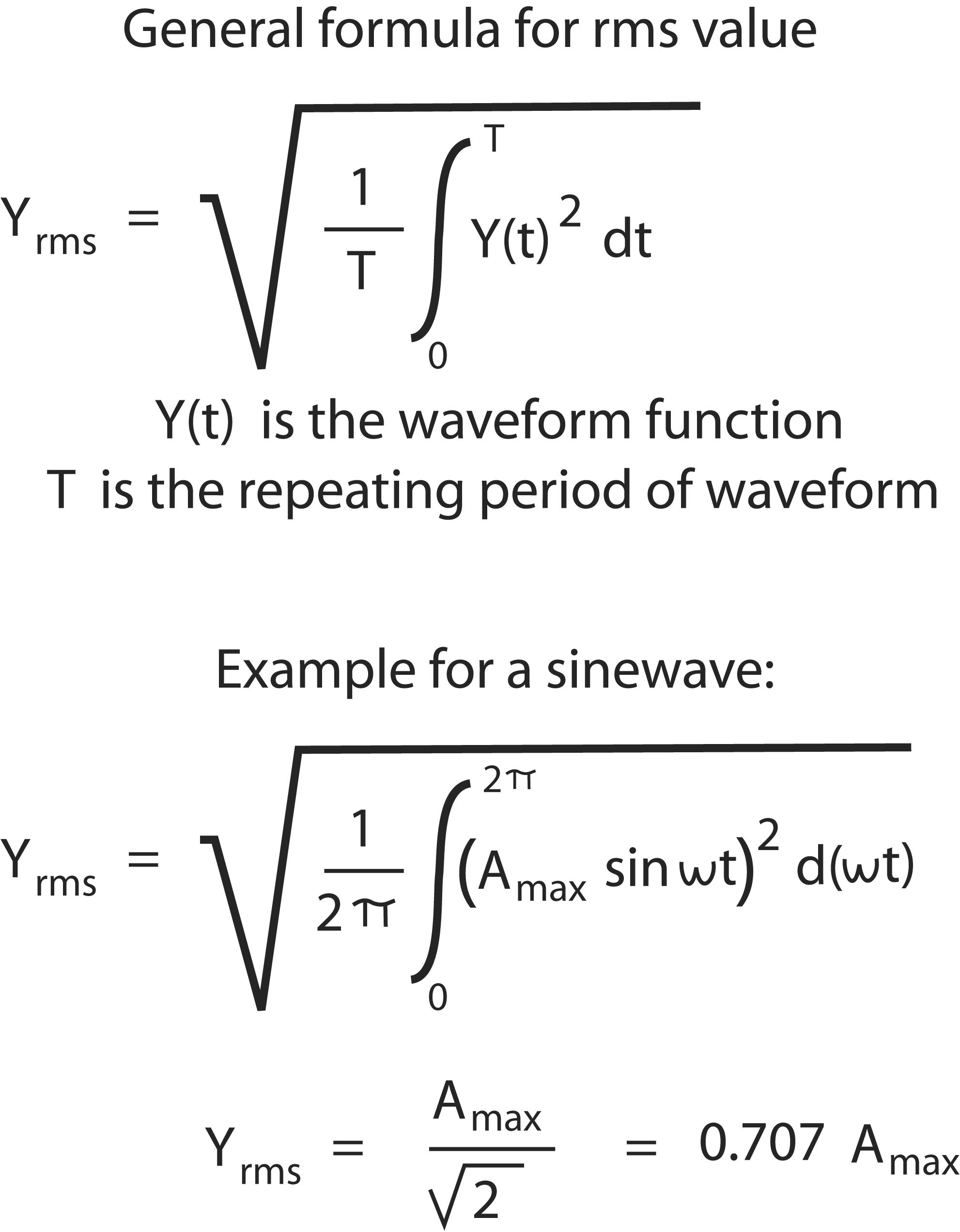

What crutshow said is exactly what I wanted to get you to think about. There is a calculus formula for RMS and it essentially means waht it says: the sqrt of the average of the square. It's done by numerical integration e.g. newton's method of the waveform.
That gets you the numerical value of the RMS voltage and the numerical value of the RMS current. You have to have enough samples to make the calculation correct. Peak detection is going to be problematic.
Phase angle might be a bit harder, but for sinusoidal waveforms it should be easy.
For a sine waves P = V*I * cos(theta).
You should take a look at some of the power metering chips that are available.
I think the quantities your interested in are:
RMS value of V
RMS value of I
and the RMS value of V * I
(Use the Calculus formula for RMS). It has terms like: 1/(b-a) * integral of (something) dt.
Now you can see where real and aparent power and power factor come into play.
General integral for rms.

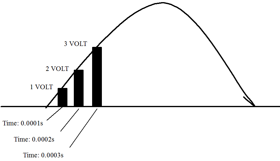

So in my attachment, is pretty much what you have explained. So what is it that I should do exactly?
(1V + 2V + 3V) / (0.0001 + 0.0002 + 0.0003) = 10000 ????
confused???
please get back!
r
Close. Take a look here: https://www.mathgoodies.com/lessons/vol1/area_trapezoid.html at example #2.
Basically flip the diagram so , the base is flat, and the right side is the longest edge and the left side is the smallest edge and the sloped portion is following the sine wave on your drawing.
So, your dividing almost like you did except you need to include the white space. So first slice your drawing in time. and then draw a line from the leftmost top point and the rightmost top point on the actual waveform. These will be you A/D values.
Your approximating the top of the slice as a straight line, so instead of adding areas of a rectangles, your summing areas of a trapezoid. That accounts for the 1/2 (b1+b2)*h
The slices will be right next to one another.
You have the slices drawn where the center is the time. NO. The times are the edges of your slice and will be actual A/D values.
Note that your slice could be wrong at the right edge of your waveform and you need to adjust somehow. If you instead take a reading at all zero crossings, you can adjust.
Your rectangles are rectangles rather than trapezoids. Your rectangles (trapezoids) overshoot the actual waveform and they should not. You show timings from the midpoint of the slice. No- you have values at each endpoint. The top edge of your rectangle will have the values of the waveform at the two time values. The waveform will be approximated by a straight line between samples.
