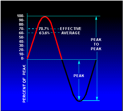

HOWEVER, something still doesn't make sence. First of all, please take a quick look at the graph in my attachment below:
If we go by the method explained in my latter link above, then let's assume that Voltage at 100% will be 100V peak. Now, let's do this:
Step#1 (square all values of the top part of the AC wave):
V @ 10% = 10 Volts ² = 100
V @ 20% = 20 Volts ² = 400
V @ 30% = 30 Volts ² = 900
V @ 40% = 40 Volts ² = 1600
V @ 50% = 50 Volts ² = 2500
V @ 60% = 60 Volts ² = 3600
V @ 70% = 70 Volts ² = 4900
V @ 80% = 80 Volts ² = 6400
V @ 90% = 90 Volts ² = 8100
V @ 100% = 100 Volts ² = 10000
V @ 80% = 80 Volts ² = 6400V
V @ 70% = 70 Volts ² = 4900V
V @ 60% = 60 Volts ² = 3600V
V @ 50% = 50 Volts ² = 2500V
V @ 40% = 40 Volts ² = 1600V
V @ 30% = 30 Volts ² = 900V
V @ 20% = 20 Volts ² = 400V
V @ 10% = 10 Volts ² = 100V
Step#2 (Sum all values):
Sum of all values is: 67000
Step #3(Do the average of all these values):
Average: 67000/19 slices = 3526
Step#4 (Do the square root of the average):
RMS = √3526 = 59.38 Volts ?????
59.38 volts is *NOT* the rms value of 100V peak????
RMS is supposed to be 70.7 Volts ?????
Can someone explaine this discrepentie. Confused!

You calculated the rms value for a triangular wave.
For sinewave you have to take the sine of 100v peak for each of the evenly time spaced increments and it needs to be over a complete repeating segment.
Sorry I think I confused you with one of my examples.
In the spreadsheet, I used 1 to 360. I should have used 0 to 259; but the answer is the same because it's a complete cycle.

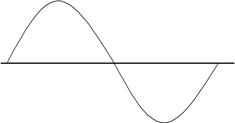

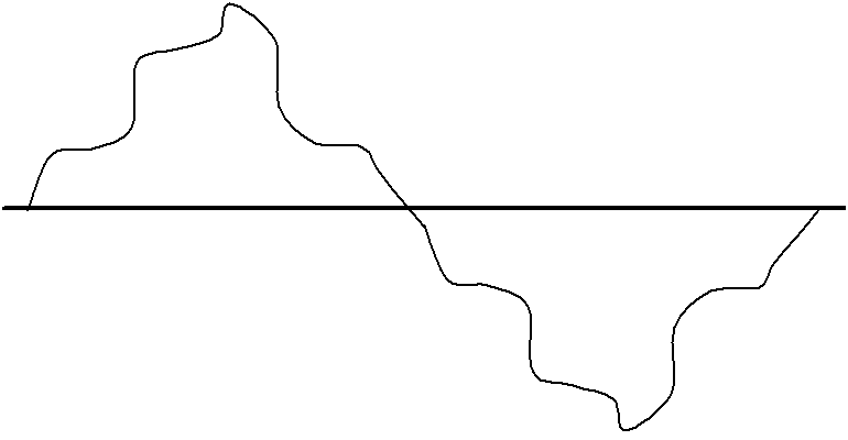

Now one question though! I have 2 attachements below. One of a clean wave form and one of a noisy shaped wave form. The example you showed me in the .xls file will do for the clean wave form. But can it also apply to the noisy shaped wave form?
I appreciate your help... its nice of you.
Regards
Ross
RCinFLA,
Hummm! I did didn't I!!!!
Okay, back to the drawing board.... thanks

OOPS: 359 !!. Since sine is defined at 0, I should have used zero and one sampling point less then than the last zero crossing of the periodic waveform. Include both a positive and negative half cycle.
X-10 and other devices communicate on/near the zero crossings.
You don;t READ the peak voltage. The sin() function goes for +1 to -1, I had to multiply that by the 0-peak value to SIMULATE a 120 V sine wave. What's necessary in the design is to capture a full cycle. i.e. time the zero crossings.
You probably should not assume exactly 60 Hz, 1/60 seconds. You should really be using the leading zero cross value of zero up until the value before the next+1 zero crossing. The important part: is is the waveform periodic?
The power computation is valid. Suppose a spike was in the AC line. It could be missed. I know for many AC voltage instruments, the crest factor https://en.wikipedia.org/wiki/Crest_factor enters into the ability to measure the signal correctly. Fluke and another company in Japan used a thermal bridge sensor which did a really good job of measuring AC signals from DC to 20 MHz.
