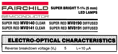

Where did you get that crazy idea?
Of course they have a max reverse voltage rating. My ordinary red LEDs have 5V as their reverse breakdown voltage like all other LEDs.

Crazy idea?
I know the maximum reverse rating is 5V!
The difference is that red LEDs have a charictaristic avalanche reverse breakdown similar to normal silicone diodes while blue and white ones tend to be destroyed, I don't know about the other colours though. I've powerd a red LED with a 47k series resistor from the 230V mains for hours and it didn't blow.
But when an LED avalanches, it dissipates power which makes it too hot.
Not if you limit the current to a low enough level.
Suppose it breaks down at 8V:
And I'll calculate the peek power:
I = (230*1.414-8)/47000 = 6.75mA
P = 0.00675*8 = 54mW
Now 54mW isn't going to cook the LED, and that's only the peak power every half cycle.
