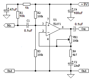

I wanna design a circuit which collects sounds, whose frequency is constant in the range between 1-5kHz ,from the enviroment and filter and amplify this sound with audio amplifier.As you know ,the voltage of mic is in the range of micro volts ,hence what should I use to amplify this input considering noise with the coming input wave?A bjt or mosfet or directly an opamp.Is it necessary to power the electret mic.Can you suggest a circuit to make this job(pre-amplifying the mic output)?

This preamp might have enough gain but it has a frequency response from about 30Hz to about 20kHz.

As I understand from your circuit ,mic require no polarizing voltage, it requires power from preamplifier .And the gain of the opamp is adjusted by VR1 100k.What is the max gain of this circuit and the average load?Because I connect a bandpass filter to preamplifier and I don't want the filter load the pre-amplifier.Also,can you explain more what you mean by

Also,I wanna to ask whether it is necessary to power electret mic.I think in the circuit you send mic is powered.The gain of the circuit is controlled by Vr1 100k what is the max gain of this circuit?AS I mentioned before , I connect the filter after pre-amp.I don't want the per-amp to load the filter.Whta should be the load of filter?You said that how I should change the circuit to make suitable for the 1-5kHz.

Edit: Yes, electret mics DO need power. Typically you'll see a resistor and cap on the positive lead of an electret mic. The resistor supplies the mic with the proper voltage and the cap blocks this supply voltage from the input of your amplifier while passing the audio signal through it.
The preamp I showed has a max voltage gain of (100K/4.7K) + 1= 22.2. You might need a voltage gain of 500 for your application. The TL071 opamp is fairly wideband but frequencies above about 3kHz are reduced when its voltage gain is 500 or more.
Therefore I suggest using two opamp circuits in series, each with a gain of 22.2.
A bandpass filter can be made with a highpass filter followed by a lowpass filter. Sallen and Key 2nd-order or 3rd-order Butterworth filters work well.
