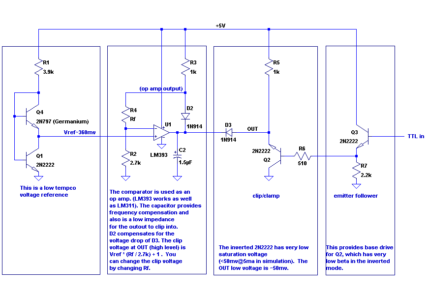

Here is how this circuit really works.
They used a comparator as an op amp because it needs to have very low output impedance at high frequency, and adding a capacitor such as C2 to an ordinary op amp's output will cause most types to oscillate, although there are ways around it.
Edit:
There is something wrong with this thread. I posted a schematic with it, but it fell off. The explanation above looks pretty lame without the schematic. I'll try again now.

great explanation, but i still have 2|3 doubts about the circuit...
1.- the clip voltage (output) is as you point out Vref*(Rf/2.7k)+1 or Vref*((Rf/2.7)+1)
2.- I have problems understanding the function of D2 and D3, the anode of D3 is connected to a fixed voltage (i think) and it only conduces in one direction, from output to the output of the opamp(comparator). About D2 I simply don't know what it is doing there :)
3.- I suppose that R3 is the pull-up resistor needed by the open collector output of the comparator, am i right?
I think that's all, the main problem is with D2 and D3 and how changes the output.
thanks
thanks
You are correct about #1. The voltage at the node labeled "op amp output" is Vref*((Rf/2.7k)+1).
The whole purpose of this circuit is to produce a pulse waveform whose amplitude is precisely controlled. Below is another attempt to explain how it works:
The voltage on the capacitor C2 is one diode drop (V(D2)~0.7v) below the voltage at the op amp output. When the TTL input signal is high, Q2 is on, clamping the output voltage very close to GND (~50mv in the simulation) and reverse biasing D3. When the TTL signal goes low, Q2 turns off, and the output rapidly (tens of nanoseconds) rises until D3 conducts. The voltage at OUT is now equal to the voltage at the op amp output, because both are one diode drop above the voltage on C2. When the TTL input goes back high, the output, of course, rapidly returns to near GND.
So, the result is a pulsed waveform at OUT which is the opposite polarity of the TTL input and whose low level is zero volts, and whose high level is the voltage at the op amp output, which is defined by the equation above. As was noted in the schematic, the high level can be changed by changing the value of Rf. The reference voltage circuit can be replaced with a modern shunt reference such as one of **broken link removed** and a resistive voltage divider.
