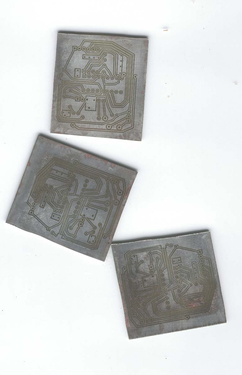

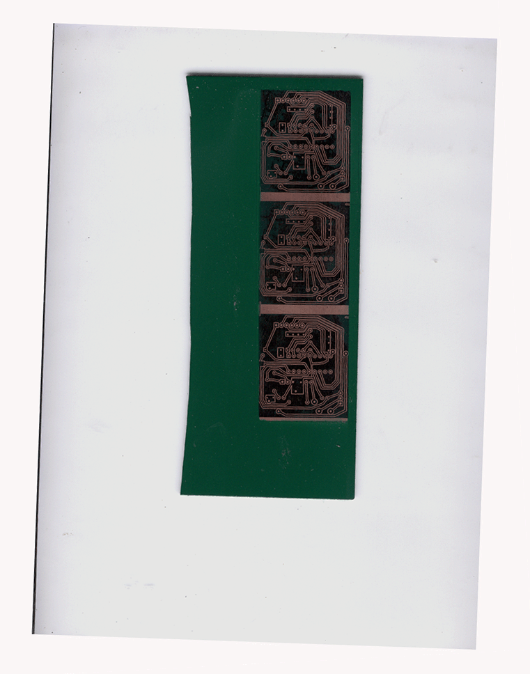

With such problems and the printer shops refusing to do even at % times the normal charge, i felt insulted and went ahead owning HP P1007 laser printer.
Ignorance (India) Unlimited, i used to call these people
I have been trying different methods as per PULSAR
I purchased the Laminator
set the printer to print density 5
warm the laminator for 1/2 an hour before using
use the 5mm setting on the laminator
CLEAN your board with dish soap and a Scotchbrite pad or 600 wet/dry sandpaper
pass the board through about 6 times switching around each time
use the green TFF paper to fill any voids in the print
pass through several times until you can see your circuit traces when you lift up an edge.
remove ink w/ acetone
CLEAN your board with dish soap and a Scotchbrite pad or 600 wet/dry sandpaper again
coat with liquid tin
all my traces are .020 except the one between the ic pins =..010
I filled all the unused ares so they wouldn't etch - not needed anyway.
I now need to drill my holes
