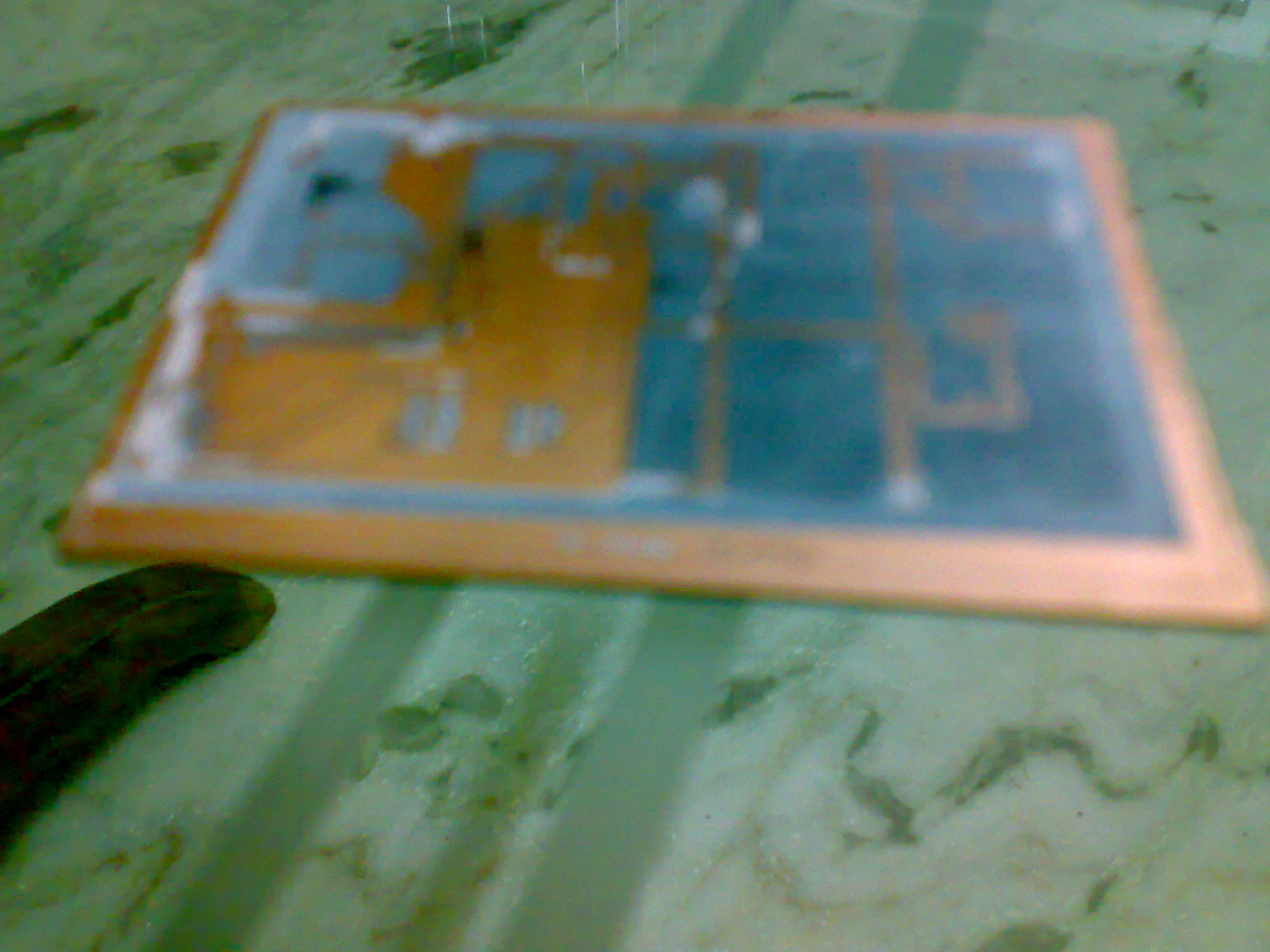

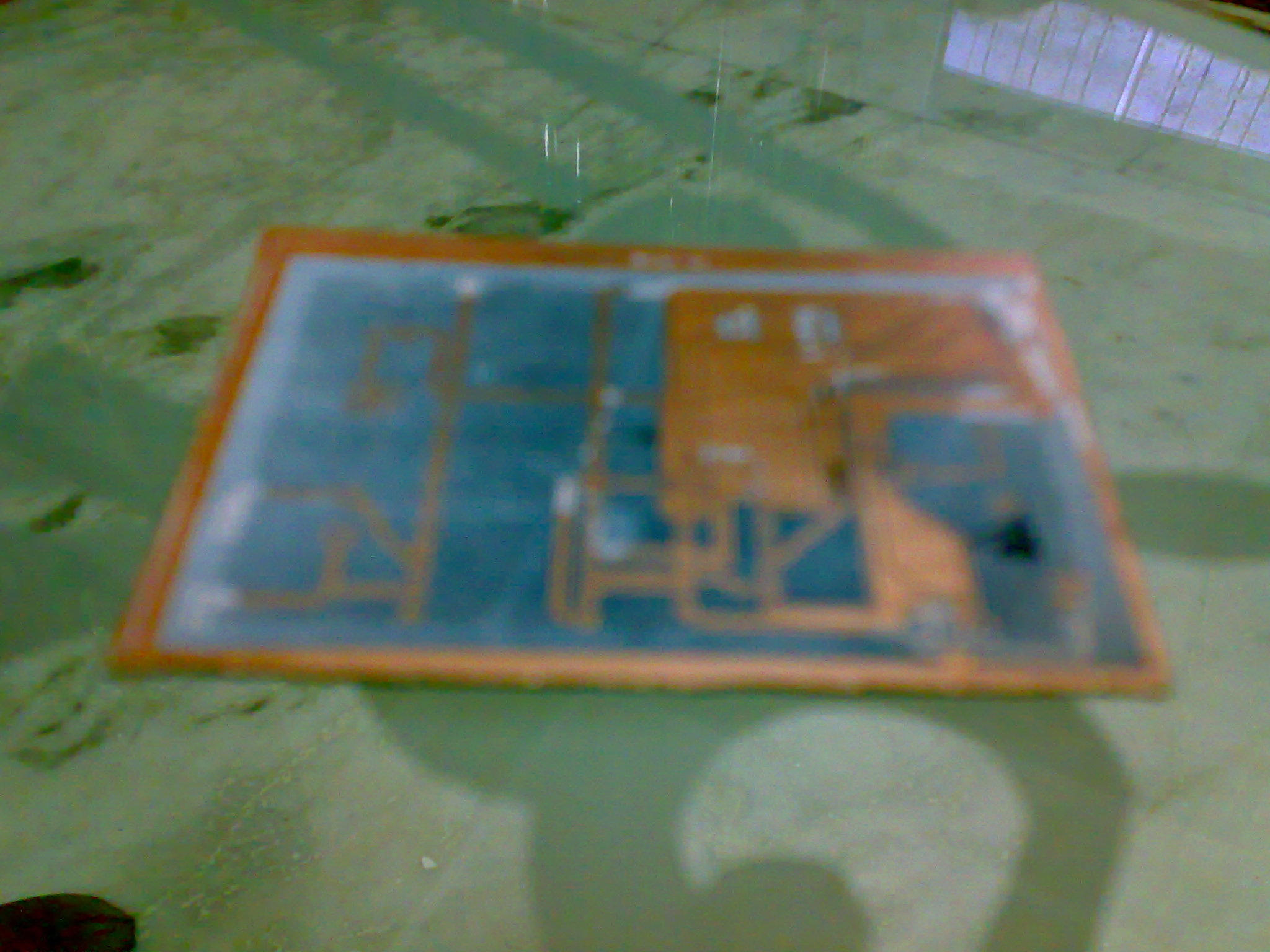

Hello,
I tried my first attempt of making PCB by toner transfer method:) using DESMAT inkjet glossy sheet and press. The transfer is successful. But I got some problems as follow...
1. The copper clad becomes whitish completely when left ideal for 15-20 sec as you can see in image I uploaded.
2. The toner on copper clad get easily removed by simply scratching it... not a strong bond I think:(
So please help me out.
Regards
Gaurav Sharma

The white parts is the gloss coating from the paper.
Use your thumbs and rub it off while it is soaking. It is OK if it's on the toner part but do not leave it between the traces or on the through holes (if any).
Try using your camera's macro setting, that picture is far to blurry to see anything clearly.
In my experience the toner doesn't stick to the board that well but that isn't a problem because it still resists the etchant.
Did you try magazine paper?
I've not had any problems with the white stuff.
If all else fails, try normal printer paper, it isn't as good as magazine paper but at least you can be certain it's compatible with your printer.
