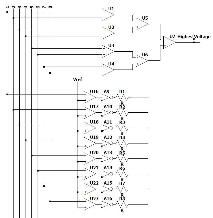

Hello everyone.So I got tasked with a project of creating a circuit , that will use 8 sensors placed in persons shoes, to find the most pressured sensor(spot) and turn on one of 8 LEDs to signal wich sensor that is. Sensors are strain gauge linear sensors with 18kΩ at F=0 with 2kΩ per kg. To create a signal for LEDs professor said I should only use comparators and differential op-amplifiers which will compare 2 voltages with 0 and turn on 1 if voltage V<0 and turn 0 if voltage is V>0. Now I'm wondering what kind of source should I use, and should I look for the smallest voltage since ressistance is going up with every kg?
I tried doing something with comparators but I don't know if this will work since this is my frist time dealing with "real" electronics outside of theory.I don't really know what and how to start this since I've never done this, so any help would be amazing.

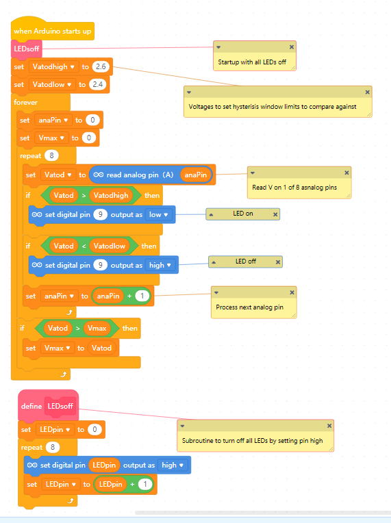

Just for future reference here is code, block language, mBlock, to implement
same solution -
mBlock takes your block structure and generates the C code to program into the Arduino
Nano board. You can look at the code if you are new to C to get a "feel" for what it looks
like.
You would connect a series R and LED to each of 8 digital pins, and a R to Vcc in series with
sensor to each of 8 analog pins.
mBlock is free, a Nano board ~ $ 1 hamburger / 2. Lots of fun.
Regards, Dana.
Lashup, 1 channel, just add the other R's and sensors to do remaining channels.
Regards, Dana.

Thank you Dana, this is a lot of help to me and it means a lot, but I'm not supposed to use Arduino because I need to create my own logic for this circuit. Now I had an idea to use voltage divider for my FSR(to increase voltage when ressitance is increased)
(R2 is Froce Sensitive Ressitor in this case)
and get the Vout signal to go out to
and when I find highest voltage I could maybe use ADC to find which sensor is giving off most voltage and then turn on the LED, but I'm a bit low with knowledge of digital circuits.
The block language can be easily modified to yield the highest V,
although I thought each LED was to be examoned for turn on based
on its V irrelevant of the others. But thats a simple change to the block
code.
But those examples were just for future reference so you could see how
easy and simple designs with a UP are these days.
If you have to use discrete parts and find the force sensor with the most
force then using an A/D certainly appropriate. But then you have to mux
the A/D, more logic, counter to generate address for mux, and then use
an encoder to select LED to light. Along with this a digital comparator for
finding highest V sensor and memory, or flip flops, to set when higher V
is found, and clear the rest. Substantial logic and parts.....
Or you could use a DAC and a mux, and ramp the DAC and do tests, again
saving in some sort of memory the DAC val that tripped off LED, and saving it
and LED # to be examined by another scan thru memory to find the max
DAC value found and which LED it is. Then more logic to turn on that LED.
So only one led on at a time, the one with max force, or any/all turned on if
each F sensor exceeds the reference value ?
I added code to find Vmax, a new variable, but did not do anything yet to
leds pending on your answer to above question.
Do you have a written description of the problem you are to solve ?
Regards, Dana.
The comparators will not work that way to find highest V, they only produce a digital
output, not an analog one. And the tree is not consistent with input polarities.
Regards, Dana.

Only 1 LED or 2(if they have the same pressure) are ever turned on.
Here is the complete problem I got:
Design a device for correcting the patient's gait.
The pressure that the foot exerts on the surface is measured using 8 sensors that are arranged in the insole of the shoe
so that they measure the pressure that the foot exerts on the front, back, left and right part of the shoe and the intermediate positions.
There is also a button that is activated when the patient leans on the leg on which the measurements are performed.
When the button in the shoe is activated measured the pressure on all eight sensors should be measured. The sensors are resistant, linear and identical,
resistance of 18 kΩ when unloaded and with a positive slope of 2 kΩ / kg load. Based
pressure differences should turn on one LED of eight, which shows the approximate position of the foot,
that is, which sensor loaded the patient the most. If the load on the two sensors is equal (in
limits +/- 10%), two LEDs should be switched on. Make a signal to turn on the LEDs
using differential amplifiers and comparators that compare the difference of two voltages with zero, and if
is the difference less than zero, turns on one, and if it is greater than zero, turns on the other LED.
Regards, Dana.
That's what I thought initially but I don't have any resources for better understanding of this and I have been going over many defenitions of not-ideal op-amps and comparators and I guess one of them might have said that it outputs the higher voltage when supplied with 2.
What is stumping me is the implied intelligence that has to exist to
find not only the highest but the next highest, testing if its +/- 10%.
And only using comparators and OpAmps. No logic allowed, no A/D,
no nothing else.
Again this is trivial using a processor with an A/D.
First cut, I am not sure if this helps. A flash A/D looks like this -
https://en.wikipedia.org/wiki/Flash_ADC Description discusses using OpAmps and comparators.
So maybe thats a possible solution, but violating use of logic or processor or A/D.
You have to ID the Fmax and its next closest sensor, then do a test if it meets +/-
10 % and take action to light that LED as well. Also logic to not light not more than
2 leds max if I read project conditions accurately. Sure smacks of a state machine.
And memory elements to hold the state of the led(s) until evaluation repeats.
Or a gigantic brute force approach, using Comparators as logic elements as well.
Looks like I should not have graduated from school.....:(.
Regards, Dana.
