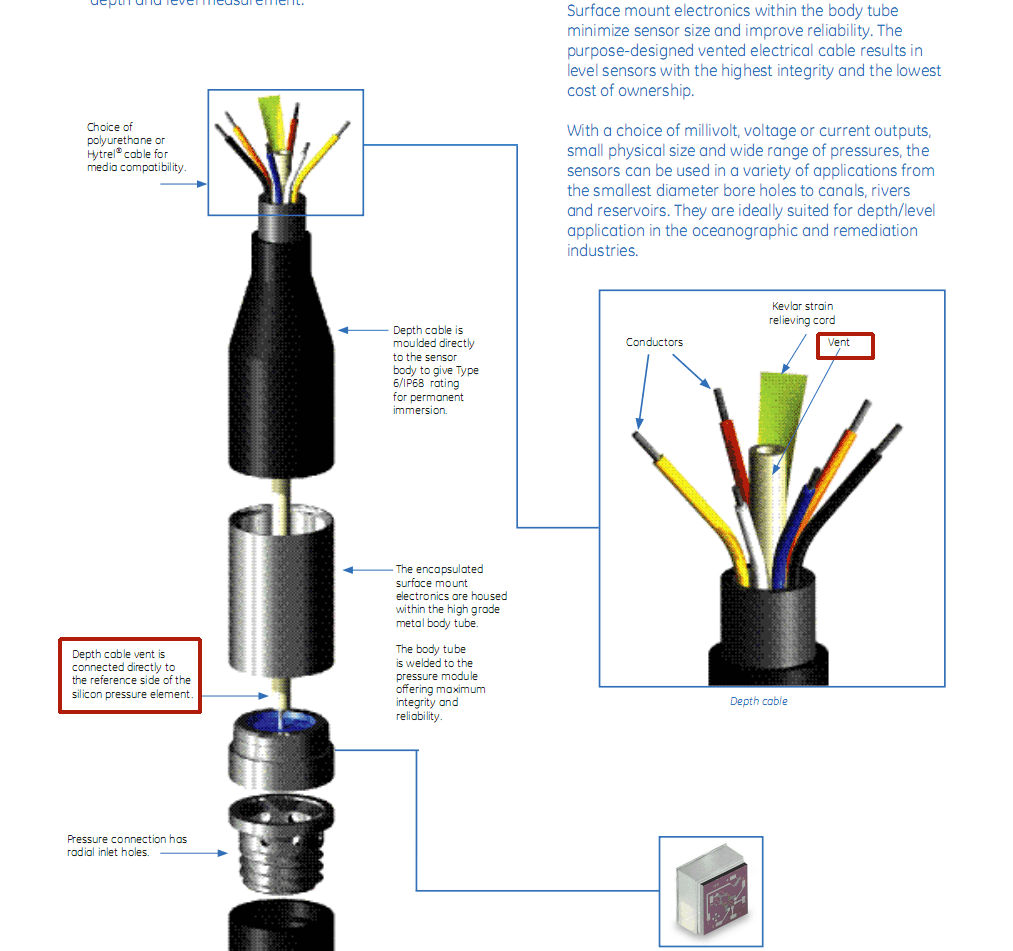

I would say without some direct method for correcting for atmospheric pressure, their 5 methods sound doubtful to me.
Look at this PDF, its the PTX type I have use, I have marked a clip showing the required air vent pipe that is within the connecting cable.

If you have an atmospheric pressure sensor as well as a non-vented water-depth pressure sensor that should be possible. Is your depth sensor the type that is vented to atmosphere, as Eric mentioned in post #11?

So, your first order problem is atmospheric pressure and you don't have a differential sensor, so you have the WRONG sensor. Atmospheric pressure is a huge correction, but it's inherently done using the right sensor.

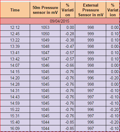

I wanted to send my readings. But when I paste it directly , all borders vanish. When I tried uploading as excel/ word files, I get the message that it is not an allowed format. Then how to send the chart? Pls help.
The readings I got are given below.
My inference from the above is as below. Please correct me if I am wrong
  1. The external pressure sensor and the other sensor do not follow a common pattern.
  2. It may not be possible to derive a correction factor because of reason 1
  3. The pressure sensor variation may be due to other reasons related to the sensor, not because of atmospheric pressure variation alone.
  4. We may have to go for a better pressure sensor.

You can post actual tables, but that's harder.
Tell us a bit about the measuring system. Is this a voltmeter that reads to 2000 mV? Or is it a D/A converter? How many bits? two's complement? What are you using for a reference? V+/2 or a stable reference or something else? Have you looked at the AC noise present?
What I potentially see is a "voltmeter" on the 2V scale that reads to 2.000 +- 1 digit.

In your table of figures, the drift is worse at the start of the test.
Was the DVM switched on immediately before the first reading was taken?
Could the DVM suffer from warm up drift?
In your first post you state that you are looking for a resolution of 5cm in 50m, ie 0.1%
If you are using a 3 1/2 digit DVM, that has at best a resolution of 0.05%, when everything is taken into account in the DVM specification it could be far less accurate that you think. Even a Fluke.
Do you have a better DVM, maybe 4 1/2 digit, which you could try?
Noise on the signal could be a problem.
Try a simple RC low pass filter at the input of the DVM.
I would be inclined to try something with a 0.5s (or there abouts, not critical) time constant, and see if that makes a difference.

The multimeter is likely +-1 digit e.g. 1 mV and your readings are very close to that AND there is a general increasing in the "depth" colum and general decreasing in the "atmospheric pressure" column, so in a sense they are tracking.
This NASA document pretty much spells it out, https://www.grc.nasa.gov/WWW/k-12/WindTunnel/Activities/fluid_pressure.html Depth is proportional to ABSOLUTE pressure not relative.
So, everyone understands each other. What is the pressure (mV and engineering units) read on both gauges when out of the water? Second question, what is your altitude above/below sea level?
Reality says, you should repeat the experiment with a column of water. I agree, it looks like something is seriously wrong from the density of the water changing over depth to the "force of water" over a dam? Two 4" pipes will give you 20' on my side of the pond.
Based on the NASA document, you should be able to compute the absolute pressure.

I found my ADC output also changing in the same way.

I used a 4" of pipe 3Ms height filled with water for testing purpose. The sensor is kept inside. Water level is kept constant
OK, so the sensor is sitting at the bottom or really close to the bottom of a 3 meter vertical column of water that's capped at the bottom, right?
If this was a test was it inside where line frequency noise would be present?
Did you use twisted pair shielded cable with the shield connected at one end only or something else?
