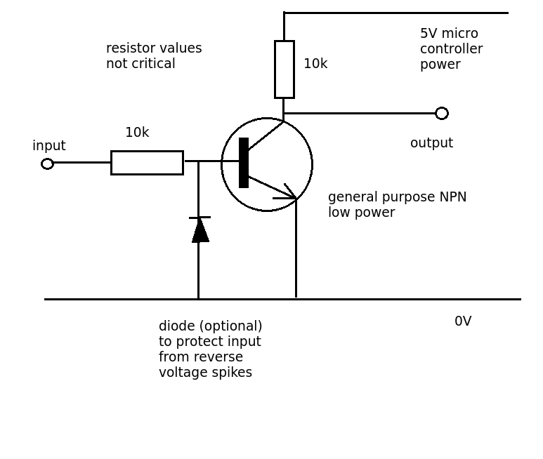

once i tried like this only tries to send some thing...i conected 5v to one pin of encoder and on decoder side i connected one led with resistor and when i turned on the device...there was one button given in encoder i pressed it and the led glows....and when i connected 0v to encoder and pressed the button again the led goes off..i was thinking to get some current from metal detector and give it to encoder like this...i m really blank now now what to do...:( how to make it work now..
i asked with one of my friend in college he told me about this...
Take pin 3 from
metal detector, give to base of transistor with 10k resistor. emitter
is grounded. connect RF trasmitter pin to collector. then collector
is connected to 5v with a 10k resistor.
but i didnt get this....

You do not need an encoder and a decoder. They use data codes that you do not need.
You just want the metal detector to detect metal and turn on the transmitter then the receiver activates the LED and buzzer.
But you do not have a metal detector circuit that works.
i have one metal detector .....its working when it detects metal.....ho do i connect rf transmetter???
How can the circuit you posted work? Are you talking about a different metal detector circuit?
I explained that the oscillator always oscillates and the rectified signal turns on the transistor that turns off the 555 then nothing happens when metal is near the coil.
When metal is near the coil then the oscillator frequency changes a little but the circuit does not detect the change of frequency.

The 555 is the tone generator. When pin 4 (RST) is held low there is no tone and when pin 4 is allowed to go high through the pullup resistor there is tone. So that determines when there is metal detection or not. Pin 4 High metal, pin 4 low no metal. The encoder has a /TE (Transmit Enable) so you should be able to work from there. You say it works so if the circuit works then pin 4 of the 555 OSC is the ball game point.
Measure pin 4 of the 555 and see if it does what I mentioned?

iF i connect that pin 4 to my TE pin of encoder will it work????
No Ron.
The 555 uses a HUGE 100uF timing capacitor so it turns on and off at a few Hz. The buzzer makes the tone.
But the metal detector transistor continuously oscillates and holds the 555 always turned off.
A metal detector is supposed to detect the frequency change when metal gets near the coil. This circuit does not detect a frequency change.
