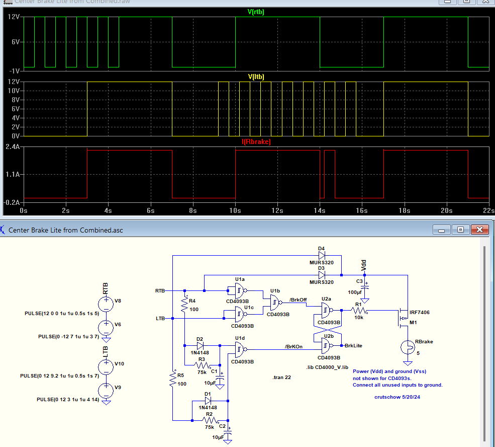

I did learn a bunch and for that i am thankful. Do you feel that the circuit member crutschow designed is viable? It is not that I doubt the design but there was a bit of confusion in the beginning as to how the circuit was to function. He indicated in post #42 the following which seems to be a problem that his circuit solves.
Crutschow said:
"It's not clear to me that any of the other circuits posted here operate properly for the combined signals of one side blinking and the other side steady-on, indicating a combined turn and braking situation.
Below is the LTspice sim of one that does
Your thoughts.
Only way to know is if all states are checked.
Another state to look out for is when removing brake, the third light delays a half cycle.
It should also handle the "emergency" state where both lights are flashing.
Just a heads up, the simulation can be misleading..
Awe man.:arghh:
Your thoughts.
Crutschow's circuit uses a latch, which may or may not be ok. I thought about using a latch of some type in my circuit, but was concerned with a circuit failure causing the 3rd brake light to suddenly latch "on". Another thing that concerns me with this whole idea is the possibility of a circuit failure causing the brake light to suddenly come on, and, in turn, causing an emergency application of the brakes by a following vehicle (potentially causing an accident). Please advise.
Here's the circuit powered from the turn-signal lights:
(The delay circuit causes an occasional extra brake pulse when the braking ends, such as at the 14s time in the sim, but that shouldn't be a problem to those following the vehicle.)
Do you know how much current the brake light takes?
That will determine the required current rating of the diodes.
(The diodes shown are 3A).

I found a problem with the circuit. When both brake lights are on (no turn signals) the third brake light flashes once, but should be steady on. I found this during a bench test.
The way to fix is to make some wiring changes, and use AND (1 chip) and NOR gates (1 chip), instead of the CD4048B. If there is another way to fix, I'm open to suggestions.:angelic:
See below:
Notice that every time the brake is applied (either, or both, inputs steady), the 3rd brake light is steady on. The 3rd brake should only flash during emergency mode (both inputs flashing).
I still need to bench test this new circuit configuration.
Hi TC
I've gone back and rechecked this circuit and it turns out I had a bad CD4025B chip. I must have zapped it. Anyway, the circuit works as intended. I did make some minor mods though.
I removed D10 and R4, not needed. Changed Rx1/Rx2 to 150k each to match the flash period of 705m Hz.

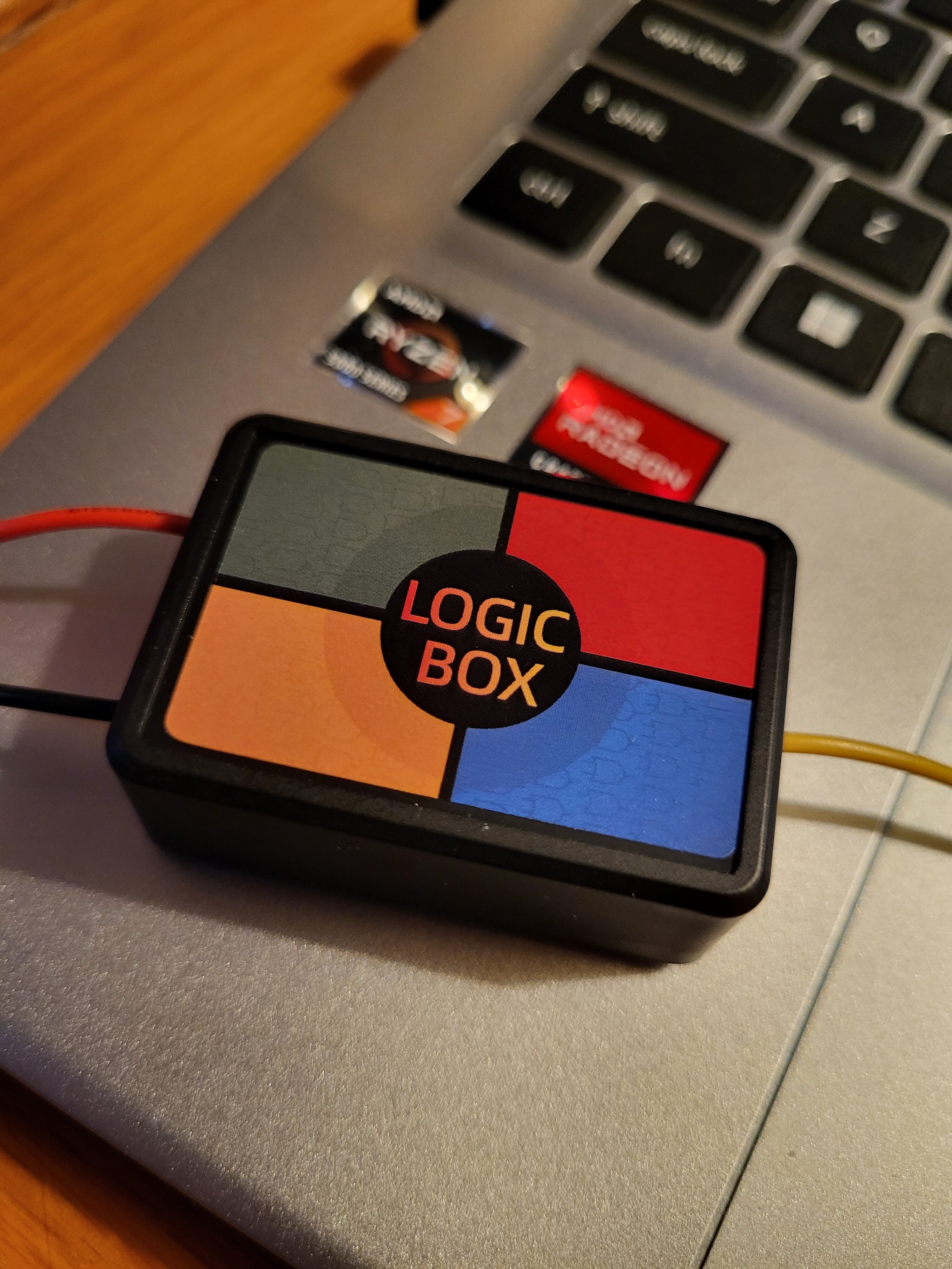

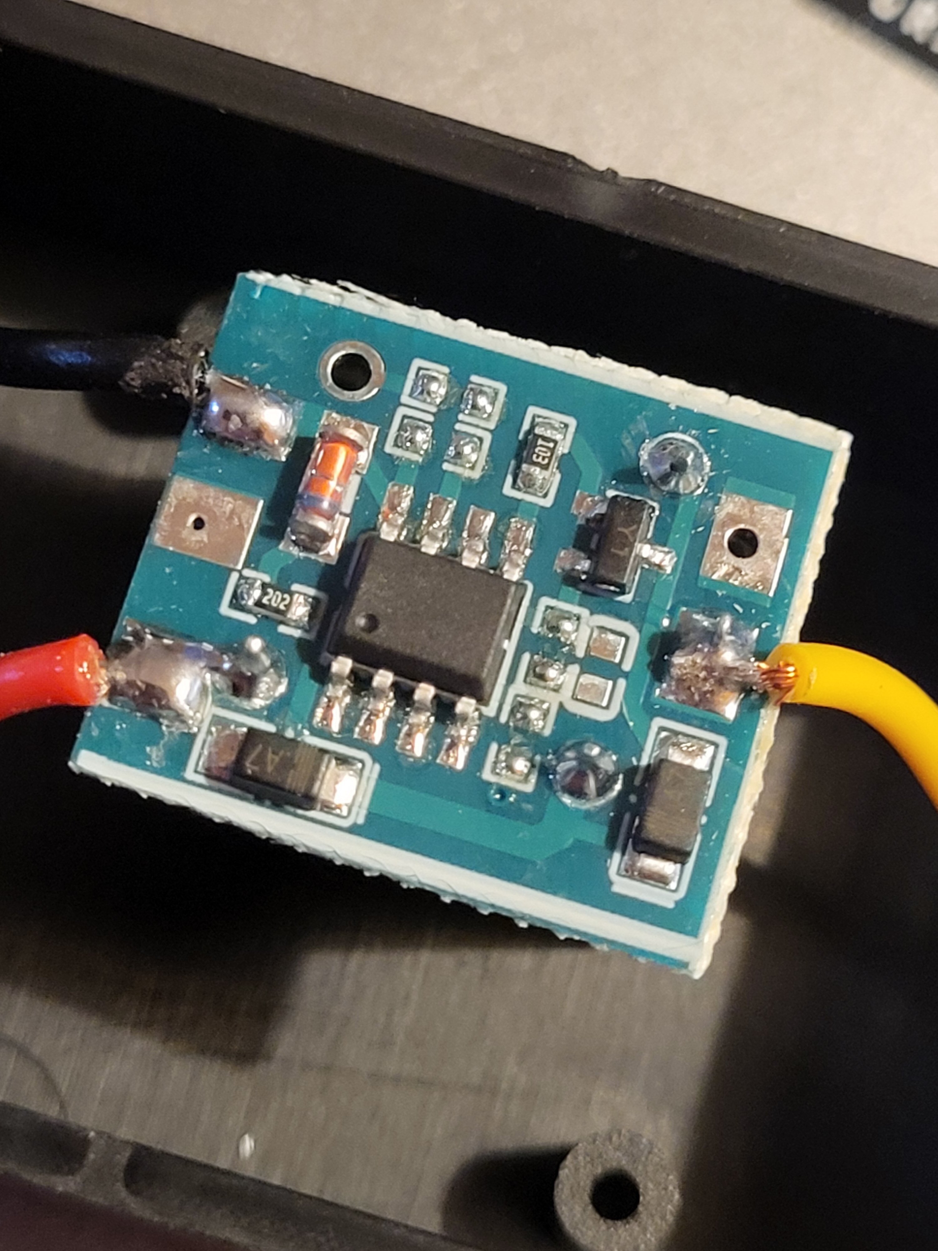

A vendor sent me this. It is similar but it does the logic from one of the brake/turn signals. I opened it up. Very tiny. Its review history says it either does not work or fails after a few days/weeks. It uses a small 12vdc relay. In my opinion it does not seem robust enough to function properly under the required conditions.
View attachment 148210 View attachment 148211
Trailer lights often have a large inrush current from the cold filaments on incandescent lights as they warm up, or from charging capacitors on the inputs of LED light assemblies.
A small relay is likely to fail quite soon if there is a large inrush current.
