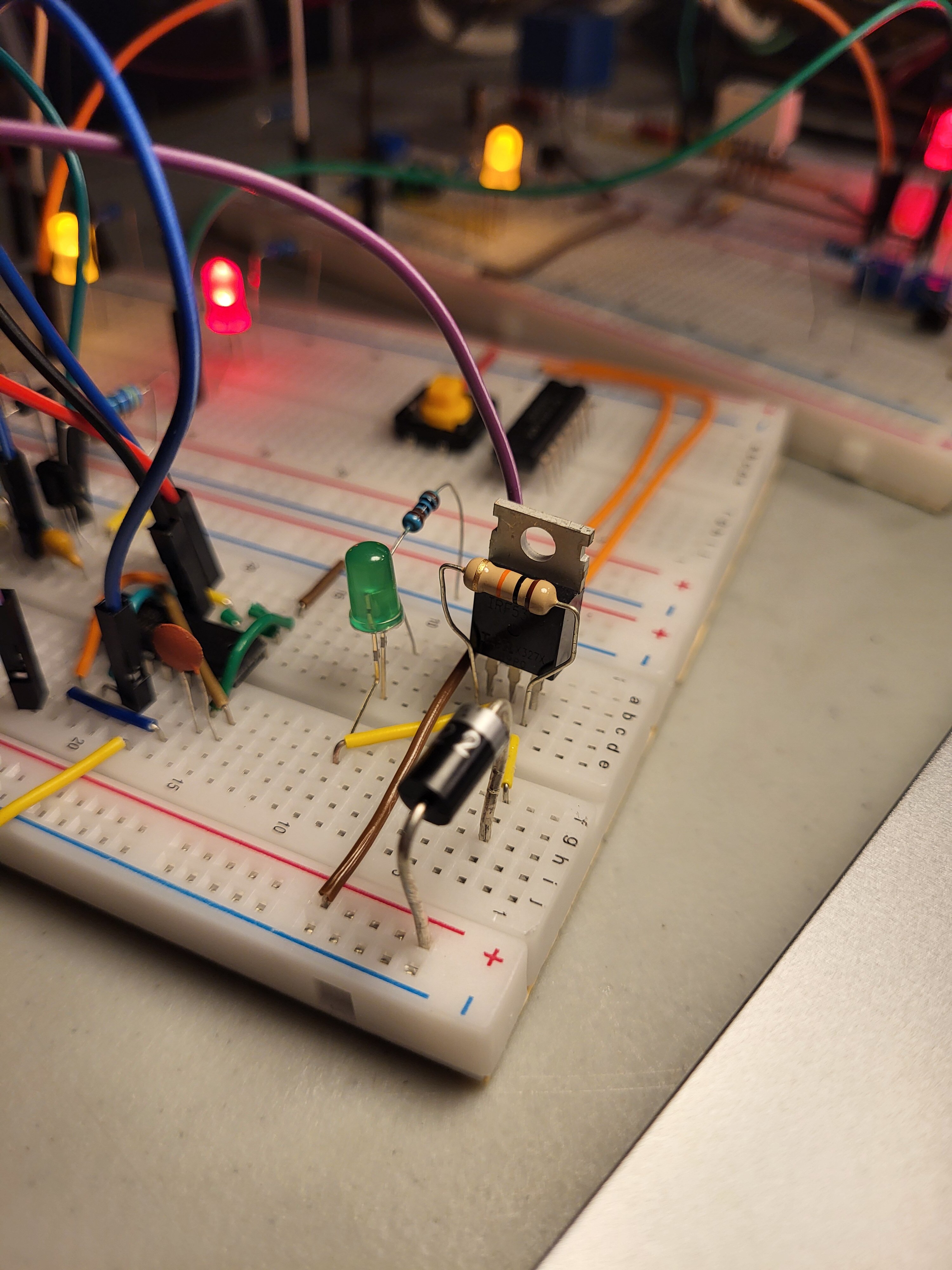

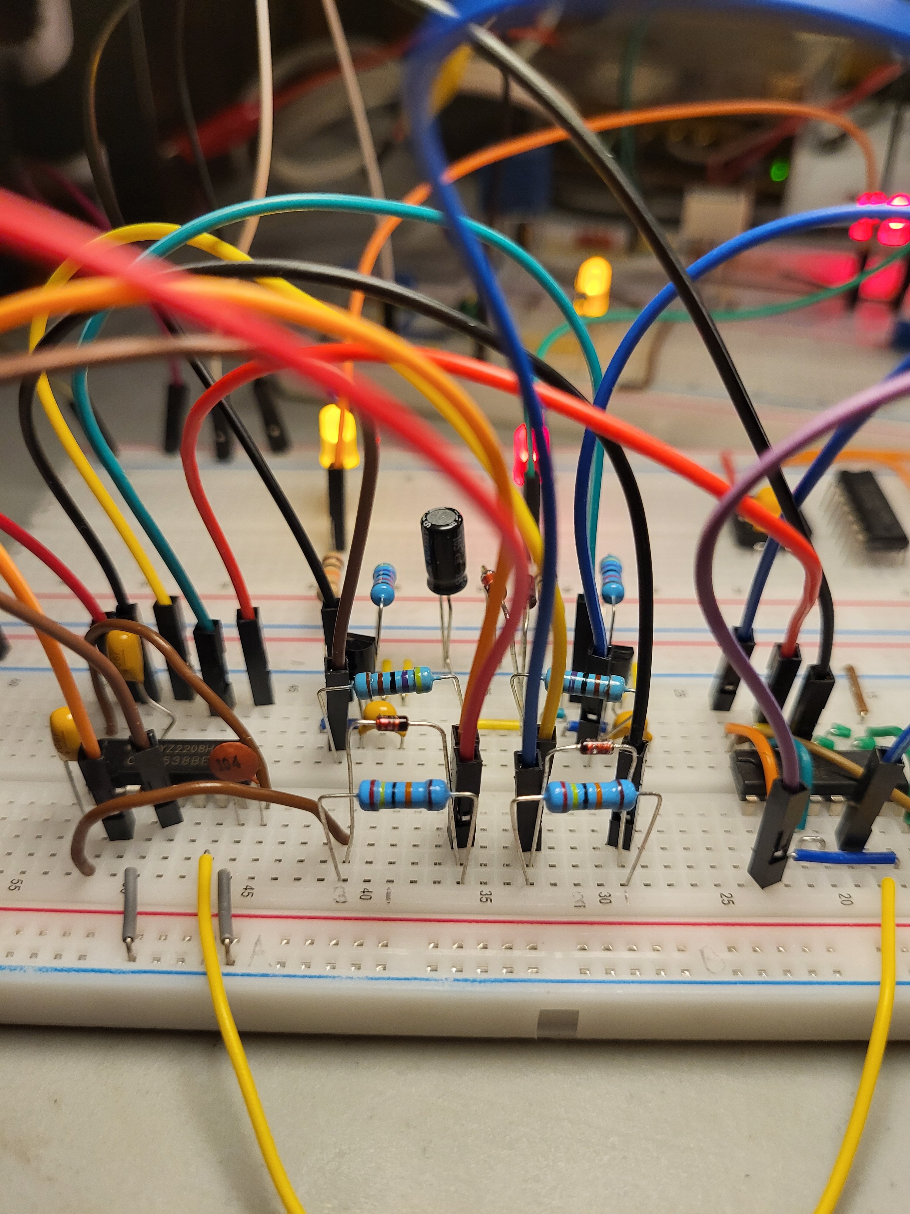

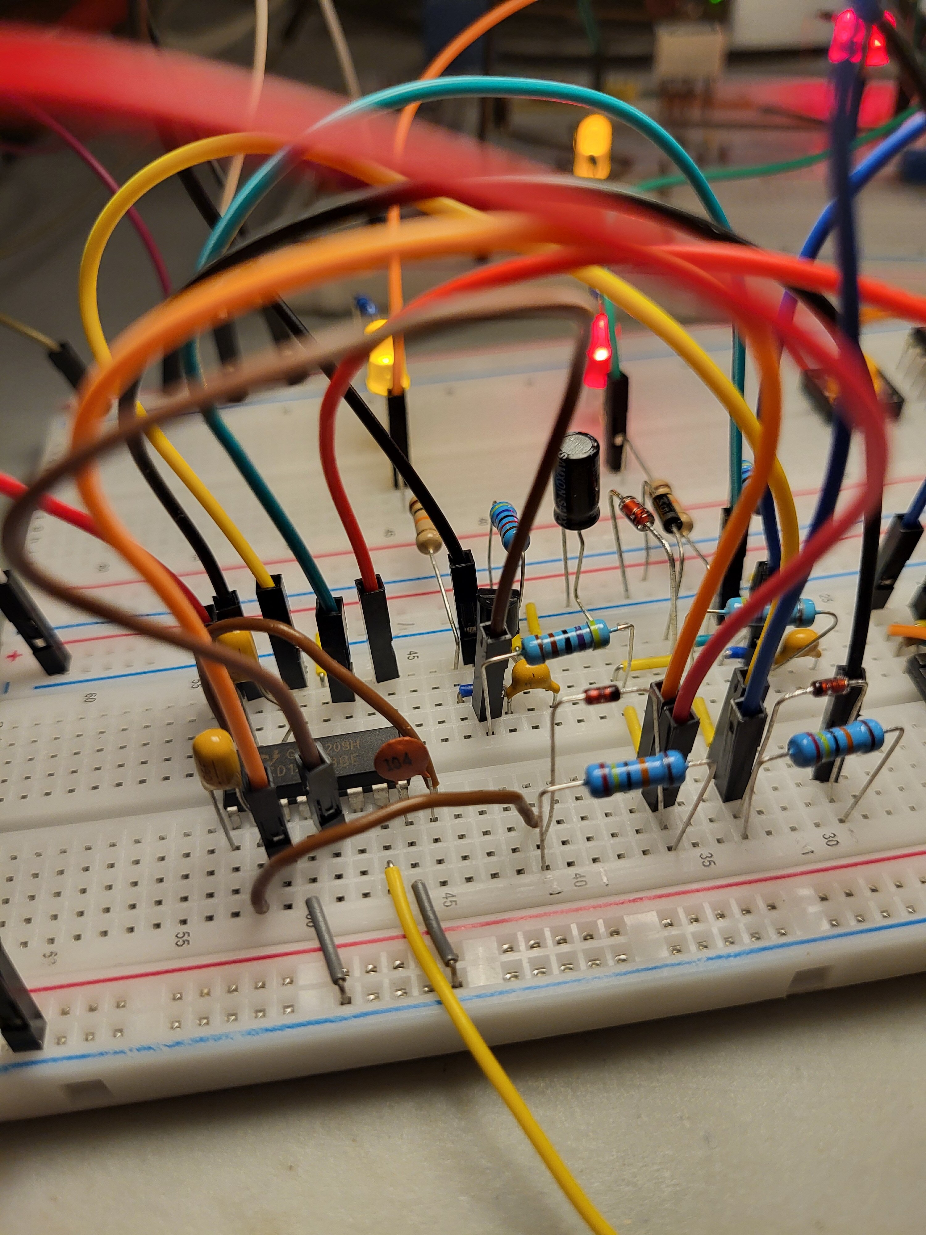

Well the condition is no longer an issue but the output does not respond. I just don't think I have this bread boarded correctly. I have tried for hours and I just get confused on how to convey the schematic to the BB.
Ill post a few pictures and some voltages. Any additional help is appreciated I feel defeated but I won't give up on this.

Can you post a good picture of the top view of the breadboard please?
Its kinda hard to see the connections and trace wires with the pictures you posted.
