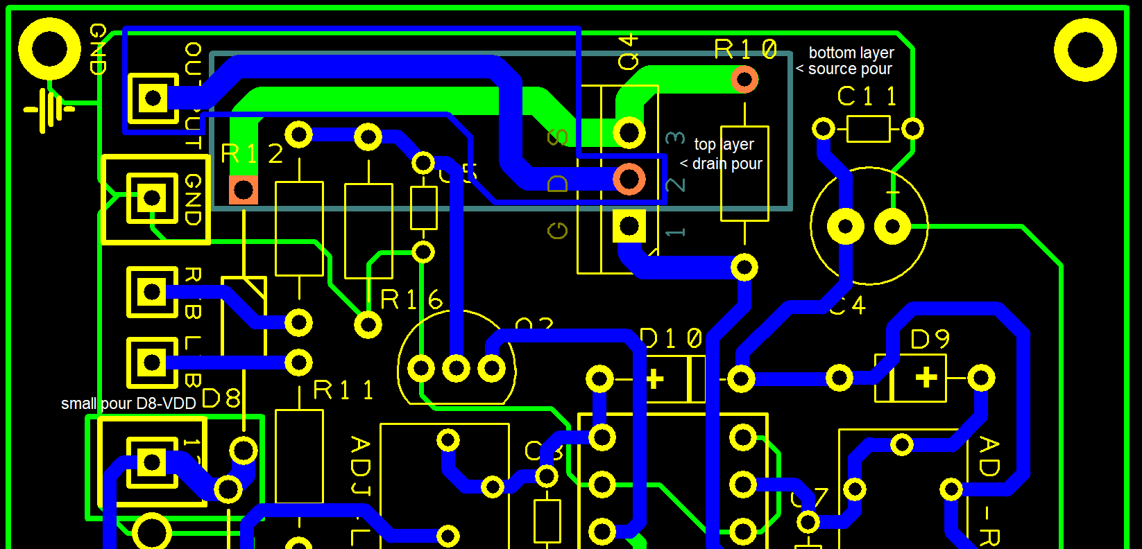

I was able to increase the trace that requires 3 amps to 70
The mosfet gate can be a narrow trace. The mosfet drain and source need to be a fat trace.
The other side of D8 needs to be fat to the V+ pin.
OK got it. I did think that was not right but the images were throwing me off.
So what I did now was
gate: trace is narrow (30)
Source: I moved that trace to the bottom layer and added a rectangular pour
Drain: Left that trace on the top layer and added a custom shape pour.
I also added a small rectangular pour on the other side of D8 where it connects to the positive input also on the bottom layer.

1. I think the fat Source and Drain traces without the pours will be fine.
2. VDD pour: make the thermal pad(s) spokes fatter without violating rules.
I think you can do this in DSPCB by pointing at each spoke and setting the width.
3. Minor details (observations):
a. why the "+" on diodes D9,D10 silkscreen?
The stripe indicates polarity, so the "+" really isn't needed. In addition to the stripe, a square
pad can be used to indicate the "cathode".
b. BJT transistors usually have a square pad to indicate the "emitter".
c. Polarized capacitors usually have a square pad to indicate the "+" pin.
d. IC's usually have a square pad to indicate the pin 1.
e. Might change "OUTPUT" to "+OUT" to indicate it is a positive output when active.
f. The square pads mentioned above help when troubleshooting from the bottom side of PCB.
Section 3 is a list of my observations and don't necessarily require changes to the PCB.

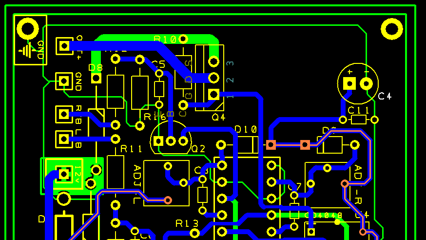

Made the changes. Moved the mosfet so it can be laid down with heat sink facing up. Larger spokes on the small VDD pour and removed the other pours. Altered components so they can be identified from the bottom.
Looks OK.
Don't change anything, but it would make more sense if the mosfet was moved next to the OUT+ terminal (shorter high current S/D traces, long gate trace ok). The shorter the trace, the less resistance, the more current carrying capacity. Maybe pick that up after prototyping.

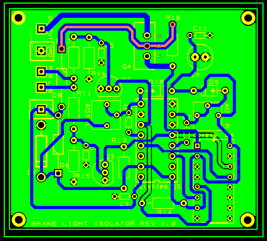

These are ground vias. A ground bottom layer copper pour added the spokes. I don't need these do I? Design Spark allows me to change their isolation so they wont have any. Should I?
Thermal pads are only needed for pins that connect to a pour. Thermal pads are intended to act as a "thermal isolators" so that the pin can be heated enough to be soldered. If there is no pin, and a thru hole connection is needed, then the hole should be an ordinary via.
Thought so. Thanks.
