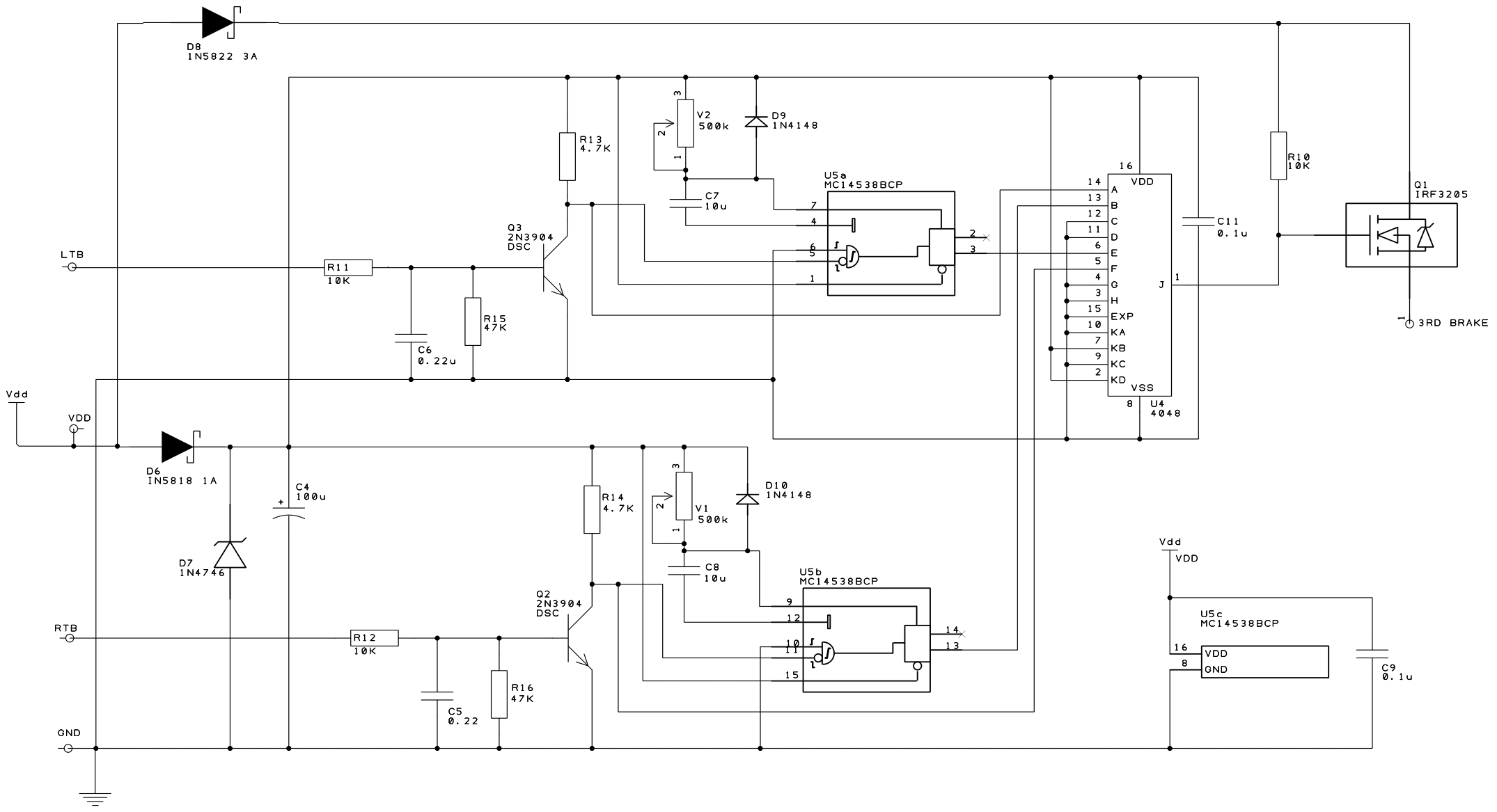

I know its a little late, but here is an alternate circuit.
This uses 1 IC (U1A/U1B, an CD14538 dual timer), two NPN transistors and 3 diode gates.
U1A and U1B are configured as missing pulse detectors to detect a pulse period of 2 Hz.
I've show incandescent bulbs, but LED's can be used.
The waveform graph shows the brake light status in the following sequence: 1)left turn then brake, 2)right turn then brake, 3) emergency flash.
Not an issue. I am so appreciative of this group. I will reproduce this one as well. I see your version has a separate power supply. As common as that is a 4 pin trailer harness does not have an accessory wire. The 5 & 7 do though and my truck has 5 & 7. The 3rd tail light has about 15 leds with a low current draw of about 200mA. Id like to know what M1 is.
Here is a revised version. I've changed the diode "OR" gates to CMOS (CD4071B). The diode gates are sensitive to supply voltage changes. This means there are two IC's in the design now. There is a possibility of replacing the OR/AND gates with a single combinational logic IC (CD4048B), keeping the IC count to two, but I think the diode AND will be ok.
M1 is the IRF7406 mosfet. I'm assuming the 3rd tail light already has circuity to drive the 15 LED's and only requires a 12V input.
I've show only the circuitry and changed the external input connections as an attempt to match post #1. The connector in post 1 shows a +12 connection, this is +BAT in my schematic. I think you should consider a +12 supply wire to feed whatever circuit you decide to use. This way, the circuit will be initialized and ready to operate.
The NPN transistors at the inputs is an attempt to "ruggedize" the CMOS input circuitry.
The circuit below works fine in simulation, but needs a bench test.

Here is a version using the CD4048B OR/AND function.
EDIT: Added U1A/B pin numbers.

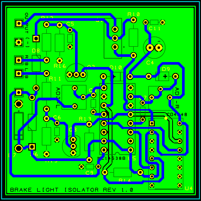

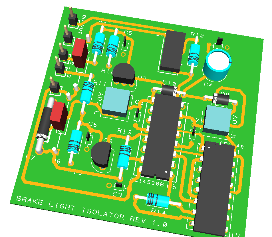

Hi, I created the schematic and PCB. How did I do?
Hi
Schematic comments:
1. Q1 Mosfet should be a PMOS mosfet.
2. The circuit needs a terminal to serve as a ground connection.
PCB comments:
In general, layout looks ok. However...
1. The mosfet routing doesn't look right. Pins might be swapped, please double check.
In addition, the source and drain should be wide traces and a wide track run from D8 to the mosfet source pin. V+ to D8 should also be a wide track. These are carrying a large current to the brake LED.
2. What size track width did you use?
3. The PCB needs a terminal to serve as a ground connection.
4. The PCB needs mounting holes.
Thank you!
IRF5305: Design Spark uses the wrong symbol. I edited the symbol and checked the pin outs. The two fets happened to be correct in pinout.
The traces are 30 and I set the mosfet traces to 50. There is a ground pin and I also added the GND net to one of the mounting holes. There is a GND pour on the bottom layer.

SCHEMATIC. Detail Mosfet IRF5305
