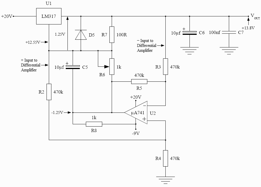

hello,there.I want to make a 0 to 12V variable dc power supply using lm 723.since Vref has to be more than 2V(for diff amps in 723 to work)my o/p is in the range 2 to over 14V. The problem i am having is in finding a virtual ground of around 2V.I put a 741op amp and used it as a unity follower with Vref of around 2V as i/p and +Vcc connected to unreguated supply and -Vcc to ground.Can i use op amp wid -Vcc as grnd this?
With this cofiguration the maximum Short ckt current is arnd 32mA whereas i need it to be arnd 100mA.Also when i short 723 ic's o/p to o/p of 741 the op amp is not working as unity follower.Its o/p and thus -ve i/p goes to the value of o/p of 723 and not of Vref.
how can i increase the current value..even pass transistor isnt helping
Please help .I need to make the circuit urgently.thanks in advance
A 723 is a very old device and a poor choice with which to try to build a 0 to 12V supply. Why not use a modern regulator, which will allow you to go to 0V without added circuitry?
You need a negative power supply.
You can easily create a negative rail by adding a voltage doubler.
Here's an example:
You can also use an LM317 plus a :mu:A741 or similar general purpose op-amp which will use far fewer components.
0 to 13.8V LM317 Power Supply

to Hero999: i chose an op amp jst bcoz a zener wont provide good regulation.And when i performd d simulation it didnt work pretty well.
Can u suggest me a better ckt using 723 ic only(my teacher has told me to use only this ic)??and a proper 2V pt in the ckt which i can use as d -ve terminal of the o/p supply??
Are you talking about my circuit or yours?
In my circuit the zener only roughly regulates the negative input to the µA741. It's not responsible for regulation of the output.
The idea is that you build the zener supply which provides a negative rail for the op-amp. If you power it from a single 20V supply then it won' work.

My circuit works by subtracting the voltage reference from the output by taking the normal normal 0V node below 0V by the same voltage as the reference. U2 is just a differential amplifier which performs the subtraction.
Have a look at the website for more information.
https://www.silicontronics.com/index.php?action=ezportal;sa=page;p=19
My attachment shows the typical voltages at different parts of the circuit when the output is set to 13.8V.
I'm sure you can use a similar principle for the LM723.
