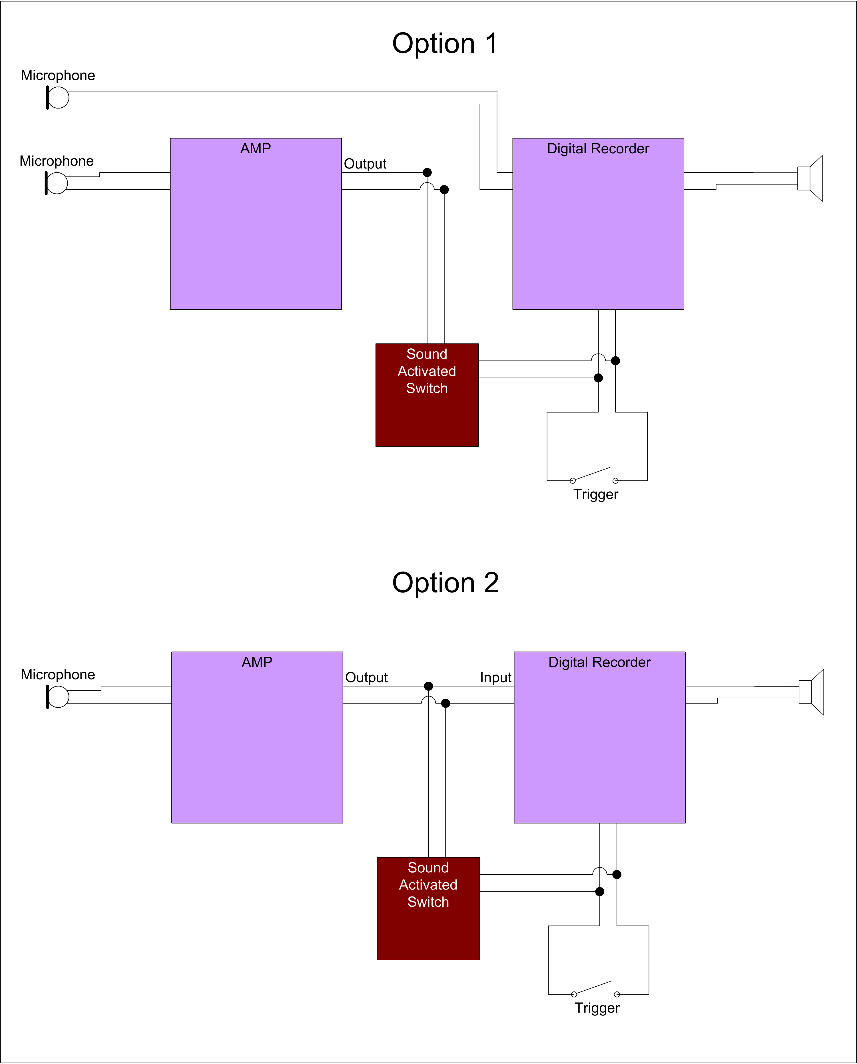

Hi tedsdad,
Unfortunately, I'm going to start with more questions than answers. Let me make sure I understand exactly what you want to do. I attached a drawing that shows two ways to connect the amp to the digital recorder. Does the drawing look like what you want to achieve? And do you already have the Amp and Digital Recorder?
If it is drawing is reasonable then the project has two design tasks and I need to ask a couple of other questions.
Design task #1 - Sound input for the digital recorder.
Let me just ask, have you figured out how to drive the amp with sound and record the sound at the same time? There are a bunch of ways to do this. The simplest is to just speak into both microphones at the same time; Option 1 in the drawing. The most architecturally elegant way is to disable the microphone on the digital recorder and drive the amp output directly into the voice recorder; Option 2. Either way will work; but the approach for Option 2 is somewhat harder depending upon the features of the voice recorder and amp. For instance does the amp already have an "output" jack? and does the voice recorder already have in "input" jack?
Design Task #2 - Create a sound activated switch that triggers the digital voice recorder.
There are a couple of ways to do this and you can probably find all kinds of example circuits. The simplest method would involve a circuit that drives an electromechanical relay to short across the digital recorder trigger switch. With more effort it might be possible to use a simple transistor or MOSFET on the output of the voice activated switch in place of the relay. The reason this is harder is because you will need to reverse engineer the trigger circuit in the voice recorder to see exactly how it works. If that circuit is something simple like shorting the trigger to battery minus or plus, then a transistor based solution would be very easy. Otherwise the relay might be easier.
Voice activated switch - Circuit claims to use a detector that only activates on voice and ignores background noise. Might needs a small addition to drive a relay.
Ramsey VS-1 VOX kit - Complete kit. Even shows a hookup for a radio (similar to a voice recorder with trigger switch). They show that their circuit has enough gain so that you could eliminate the amp all together. This is probably your best bet. I saw it on ebay for ~$7.

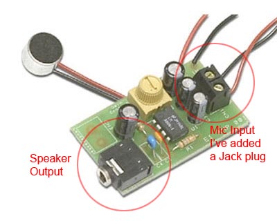

Yes, I have both the 1w mono amp and the 20 second digital voice recorder / player (I'll refer to it as DVR). Presently they have their own speakers and battery packs.
You're diagrams are very close to what I want to do – impressive. I've attached images of the modules I'm trying to use.
More info:
The amp, has a jack input / output for mic (I've added a jack plug) and speakers.

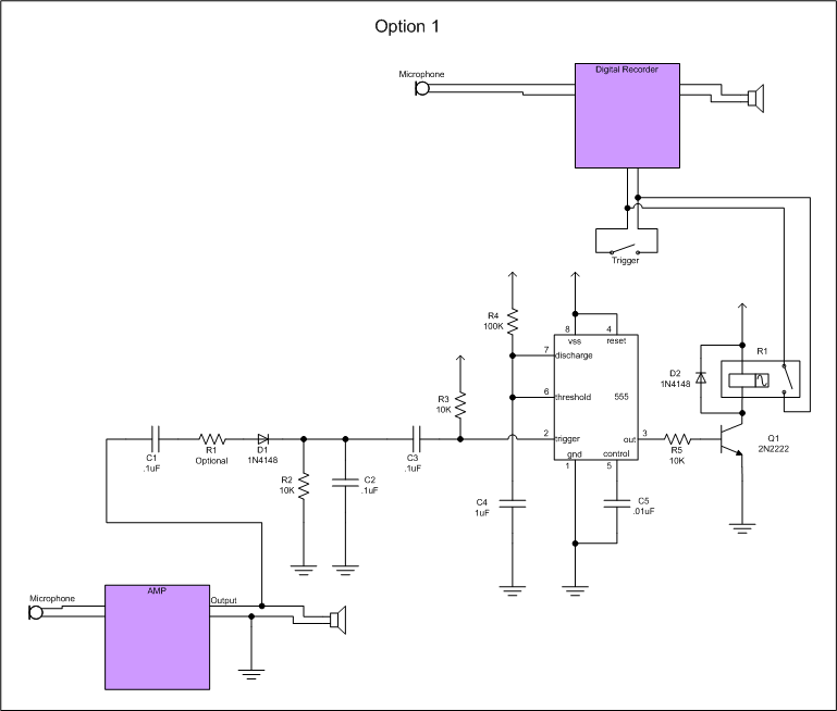

I suggest that you hold off on the power supply and single speaker requirements. You can get a functional prototype working if you just get the trigger working. I've attached a new drawing that shows two independent amp and DVR modules where the DVR is triggered by the transition from an AC signal to silence at the amp. That should be a reasonable place to start.
Theory:
Amp output is A/C coupled to the detector by C1; this ensures there is no DC current path into the detector. This may not be needed if the amp output is a simple transistor output or already has an AC coupling capacitor. The AC coupled amp signal is then rectified by D1. R2 and C2 form the peak hold circuit where R2 determines how fast the circuit responds to silence. Raising the value of R2 will make the circuit less sensitive to short silence intervals in speech or music. Initially an AC signal from the amp will charge C2. When that signal stops (silence) R2 discharges C2. The falling edge is AC coupled through C3. C3 is necessary to ensure that the one-shot does not continue to trigger. The 555 will continuously trigger as long as pin 2 is held low. R3 will eventually charge C3 enough to keep from triggering the 555. R4 and C4 form the timebase for the 555 one shot. The forumla is 1.1 * C4 * R4 in seconds (~100ms). You can adjust those values to make the trigger longer if needed. The output from the 555 is feed to a 5V relay. If you figure out exactly how the trigger input is wired internally in the DVR then it might be possible to make this work without the relay. I've also seen circuit examples where the relay is driven directly from the 555. You can try that if the relay is very small.

Whoa, what a circuit. My sincere thanks for providing a schematic. I now have to get my head around it and get some help to understand how to build it. I understand (in principle) how this works.
I'll try my best to build this on a breadboard and get it working. I would rather use a PNP transistor instead of a relay due to size. This gadget needs to fit in a small box!
