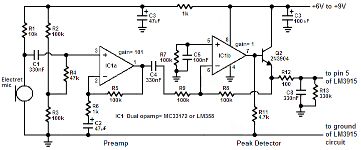

The LM3915 and LM3916 display audio signals much better if a peak detector circuit is used as shown in their datasheets.
In my Sound Level Indicator project I used a low voltage, low current single supply dual opamp to be the preamp and peak detector. I used a 9V supply but it will work fine with a 3V to 30V supply.
I used an MC33172 dual opamp that has a full power output of 35kHz but if you don't care about high audio frequencies you can use an LM358 dual opamp that has a full power output of only 2kHz.

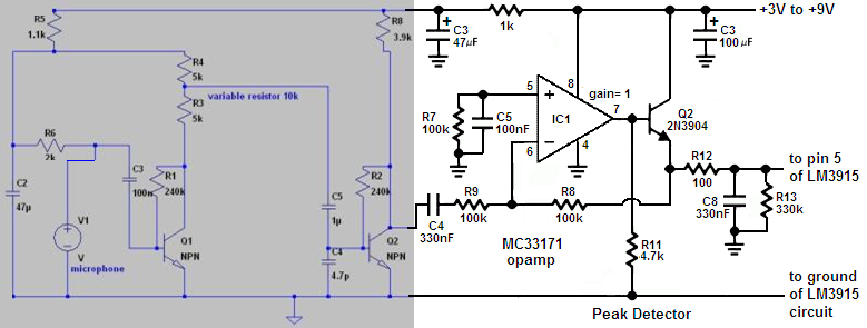

would it be possible to keep my microphone circuit and at the end attach the peak dectector section from your circuit?
because im doing this for college and ive allready spent a load of money on this
also if i can attach the peak detcector to my microphone circuit can i use a lf351 opamp
because i have quite a few of them
in the lm3916 data sheet on page 11
im thinking of using figure 4 a half wave rectifier
but i like your one better because it does not require diodes and the diodes used in the data sheet are specialised one and in your one it only requires resistors and capacitors that are generalised
Yes if you use an MC33171 opamp for my peak detector.

ok on the left i will have the whole of my microphone circuit
and on the right i will have the peak detector section from your circuit but instead of using a mc33172 i will use a mc33171
do i copy it from C4 330nF and work right
ignoring C3 47uF and the 1k resistor above it
also do i attach the peak desteactor to the top of the capacitor on my circuit
and do this should hopefully get my project finished?
i looked for the mc33172 and mc33171 in my local electronic stores and i can not find them i realy dont want to spend extra money on postage
is there a close alternative or is the circuit around the opamp baised around the opamp
I don't know why you want to use your transistors preamp that will have distortion and poor low frequency response.
If you cannot find an mC33171 then use half an MC33172 or use half an LM358
that has poor high frequency response.
