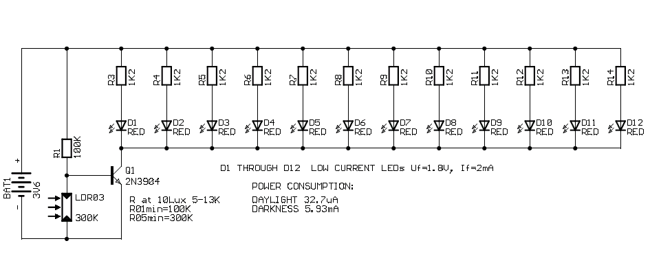

I would forget the big ugly solar panel, and stick 2 more AA batteries hidden behind the clock, with a LDR and a little FET to switch the LEDs on at dark. The batteries should last many months, and you have to eventually change the other battery anyway.
I have to agree with you, for this wall clock, that would be the right solution, but I'm interested in seeing how small I can go. I definitely am realizing that a rechargeable battery is a better idea than a capacitor.

Using an LI-ion battery of 3.6V and 500mAh the LEDs could be on all night long if you give the battery the chance to charge during day.
Use low current LEDs (full brightness at 2mA) and dim them to draw 0.5mA.
Since a voltage drop of the battery below 3.6V cannot supply two LEDs connected in series they must be connected parallel.
The suggested circuit has a current flow of 32.7µA at daylight, increasing to 5.93mA at full darkness (using an LDR03 as specified).
Even in periods of no sunlight the battery should supply the circuit for 84hours and 18minutes with a fully charged battery.
Boncuk
P.S. For the LED placement use a position underneath the hour hand. That way you can at least see the full hour.
