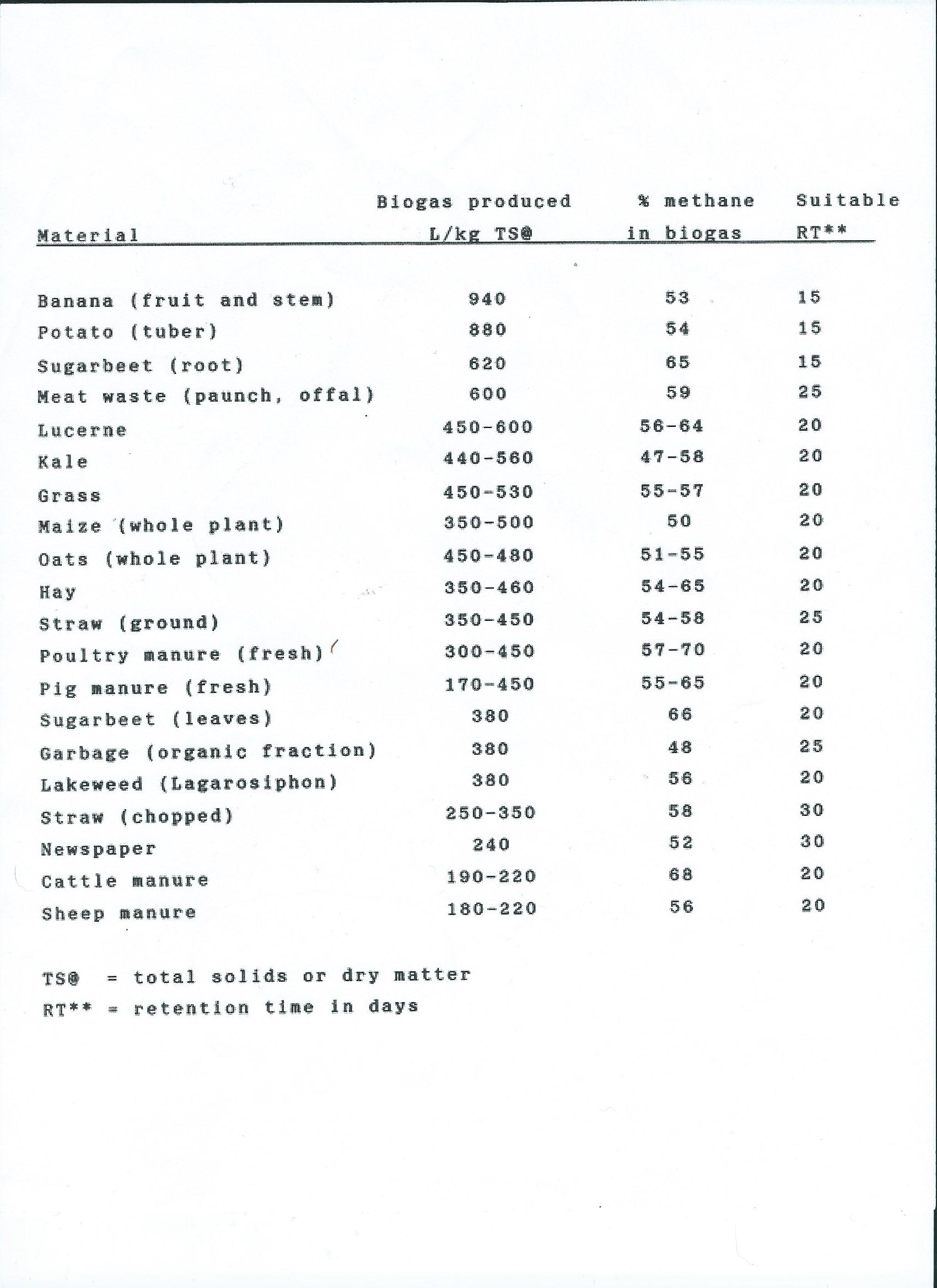

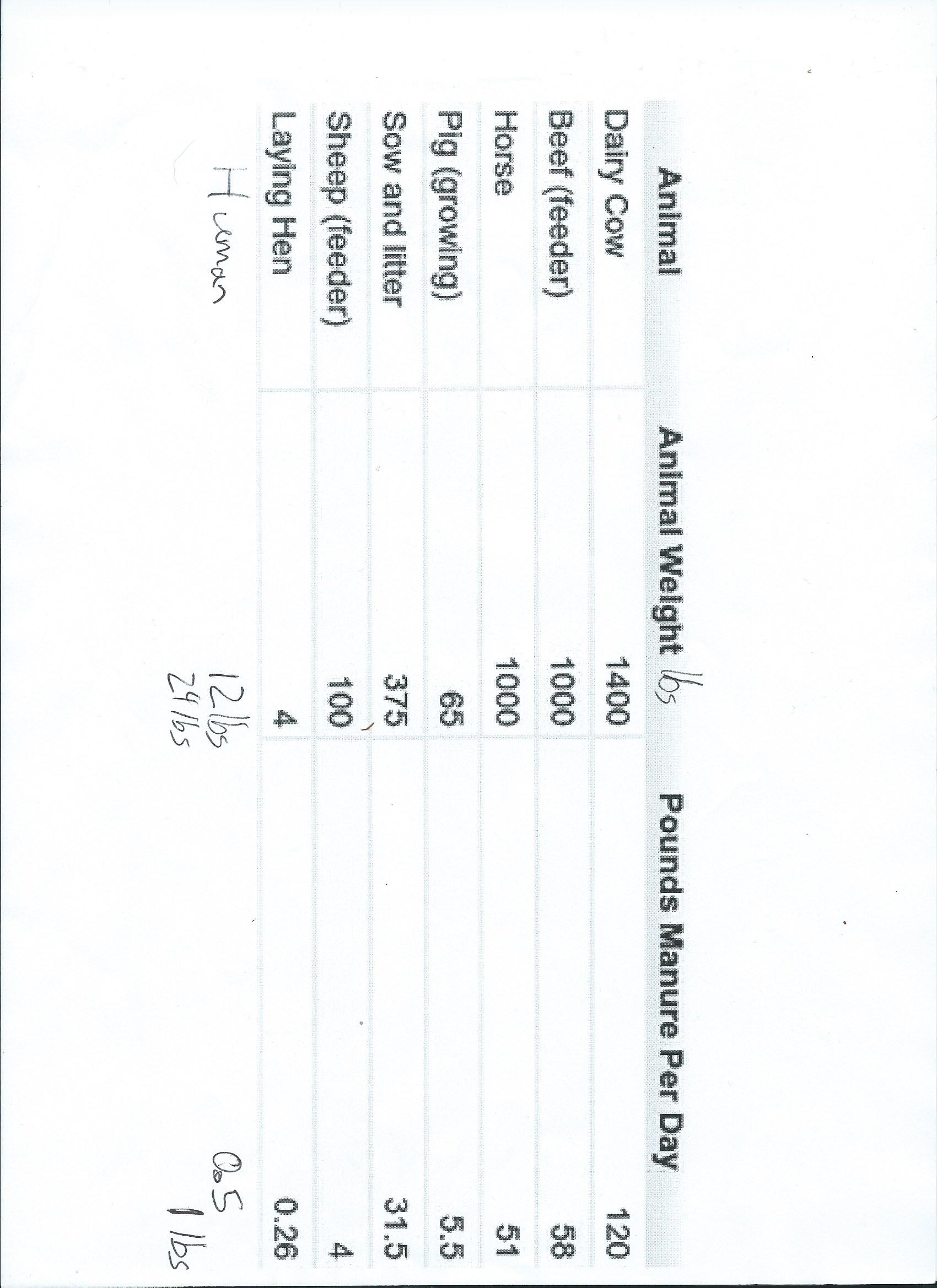

Infact I recently wondered how much cow farts depleted the ozone layer, although i wasnt able to get the volume of farts produced per day, but i was able to get some dung calculations
pretty much , a full sized cow is about 2400 lbs, and poops 240 lbs per day
cow dung holds about 200L of BIOGAS per 2.2lbs or 100L/lbs
so we have about 24,000 L of bio gas for 1 cow per day
for cow biogas 68% of that is methane, so we get 68L/lbs of cows waste
which works out to 16,000L of pure methane per cow per day
OR 7L of pure methane per pound of cow you own.
OR 0.007 m^3 per pound of cow per day
so to generate 100kw each hour per day we would need 37000 lbs worth of cow, or 15 cows.
again if you look at the figures, the biogas isnt the part of the equation that makes this valuable. As the machine only needs 11m^3/hr of gas or 1.21$/hr of gas. to generate that 17$/hr revenue (15.8$ running off the pipe)
Also it was interesting to look at the charts of all the things that do produce biogas, and which ones had better co2 ratios
I think the gas numbers are off by a factor of 100 or more and the poop numbers by a factor of 10 at least.
At 24,000 liters a day that would mean one cow has to pass something like ~16.6 liters of gas a minute.
As someone who has been around cattle I can assure you they dont even breath 16.6 liters of air a minute let alone fart that much and for an animal that eats at most 30 - 50 pounds of grass a day I am doubtful on can make 240 pounds of poop from that and 5 - 10 gallons of water.
