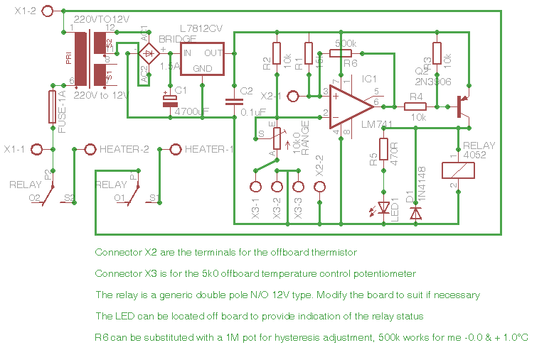

Hi
Thermocouples are fairly old technology and are not noted for their accuracy. I speak under corrrection but would doubt if your thermocouple is able to offer ±0.1°C tolerance. If you T/C is located someway from you circuit you will also need to use compenating cable. PT100's or Thermistors are in my opinion a more elegant solution.
I have just completed a project which controls an element and uses a thermistor. It consists of a LM741 configured as a comparitor, it works very well. The circuit is equipped with a pot to set the hysteresis, a tighter tolerance up to ±0.1°C is possible. As mine drives a relay I kept the tolerance wider to avoid excessive switching. I don't know if it can be adapted to drive your PWM module, I simply don't have skill.
Have a look at the attached schematic and see if it gives you ideas.
Regards
Andrew
PS: I am curious as if it works would like to adapt mine accordingly.

You know what...... I am getting mixed info then... Some people say TCs are superior and more accurate than Thermistors and then I hear vise versa.
In any case....
Its a good thing I have collected a range of parts for this project.
I have also purchased some very small/quick responding thermistors as well and am more than willing to play with that circuit you posted... Thanks much for that..
I will let you know how things go.
