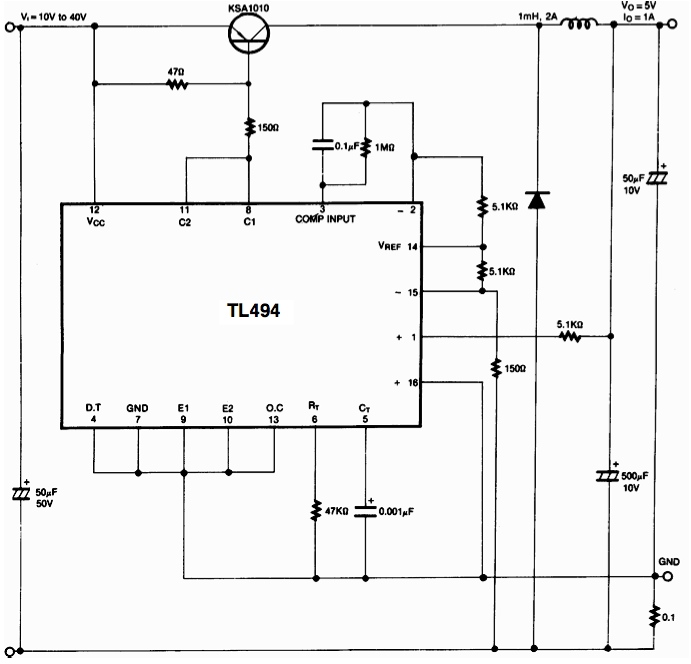

Another thing that I have really been thinking is that I need to start designing a new control circuit with the TL494 that you mentioned duffy..
Would it be possible for me to design a circuit with that TL494 in a electronic circuit design/simulation program?
Otherwise... what would be my best first step? Is there any PWM tech literature online that can read to help me design it? or anyone with some tips?
You could certainly simulate it if the program has the model for a 494. It's a pretty common chip, and not terribly new, so the odds seem good.
If no, you could still model it off the functional block diagram on the spec sheet using comparator blocks, flip-flops, an oscillator, three voltage references, two drive transistors and a handfull of gates -
- but that's going to be a bigger pain than just building it. Let me see if I can find a suitable example online....
Could this be made to work like the 555 PWM circuit? But with more flexibility and options?
pwm494-jpg.26139
That's pretty close, except that transistor is only rated for 7A, and your thermal sensor would connected to pin 1 instead of that voltage sensing arrangement.
Do you have a spec sheet for the thermal sensor you decided to use?
You said you got a PWM kit, and it works - how about posting a schematic? Simplest thing to do would be to connect whatever thermal sensor you want to use to that.

The schematic to the Kit i am currently using us on page #2 of this thread...
Here is a link to the data sheet for the thermistor that I have. HERE
Its the "1,000Ω @ 200C" Model: GB2315R-3-200
SteveB: it must be some sort of proportional control. ON/OFF is unacceptable....
Rolf: Its not overkill and quite necessary as one of the requirements is that the heating system is that it needs to turn on, be able to deliver the desired heat(with decent precision) with in 5 seconds of operation signal, maintain the target temp range while the flow rate of the air changes slightly, and immediately begin cooling when the operating signal stopped. I highly doubt a house thermostat can do that..
Also... I want something thats fairly simple and cheap that is home made. I'd like to be at least semi original.
So far I've accomplished a few of my requirements. My current model simply runs off of the PWM circuit and I've adjusted the power so that the once the air is flowing, the circuit is powered on, the target temp is maintained only because the air flow rate is constant, and when I power it down, the little element cools quickly.
What I have in my mind is just setting the power a little higher than i need to get to target temp.. then using the thermistor somehow to bring the power down to when the temp goes above 'target'. So I would have to add some kind of loop with the thermistor that, as the resistance decreases (increase in temp), the pulse width decreases.

PID control with carefully adjustment of the tuning variables under actual operating conditions. It's the method the control pros use and anything else you kludge to work will still be a kluge. ;)
Lefty
We still don't know what this is for. If he's heating a platinum catalyst, a proportional controller is probably enough. If he's growing crystals, it probably isn't.
