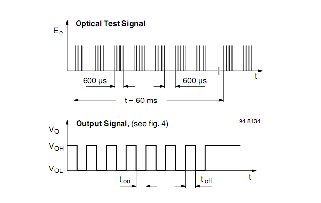

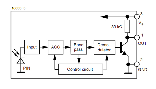

Sorry for any confusion about the requirements. I am basically trying to recreate what is being done with a vishay tsop 4838 or panasonic pn4612 ir receivers. Figure1 shows their functional diagram. Figure 2 is the a 38khz modulated signal and its demodulated output.
I need to be able to change the modulation detection frequency from 38khz to a custom frequency such as 9khz.

I suspect that the 38 kHz is preset inside the IC, no-changeable.

This is exactly my problem. I need to recreate the demodulation that is being done by these IC's at different frequencies such as 9khz or as high as 500khz.

Simply put i need to recreate the functionality of above stated devices (tsop 4838 or panasonic pn4612) at different frequecies. Anywhere from 9khz to 500khz.
From what i have been reading, it looks like my best bet is to use a PLL being fed a reference frequency(possibly PWM of micro) and then reading the VCO error voltage? I could use a comparator to interrupt a micro to tell me that there is a carrier frequency within range of my reference frequency. It appears that by using a PLL i would be able to detect different modulation schemes such as FSK, Manchester, Pulse position coding or Pulse width coding.
Based on the figure of modulated - demodulated waveform, do you think this would be a good method?
