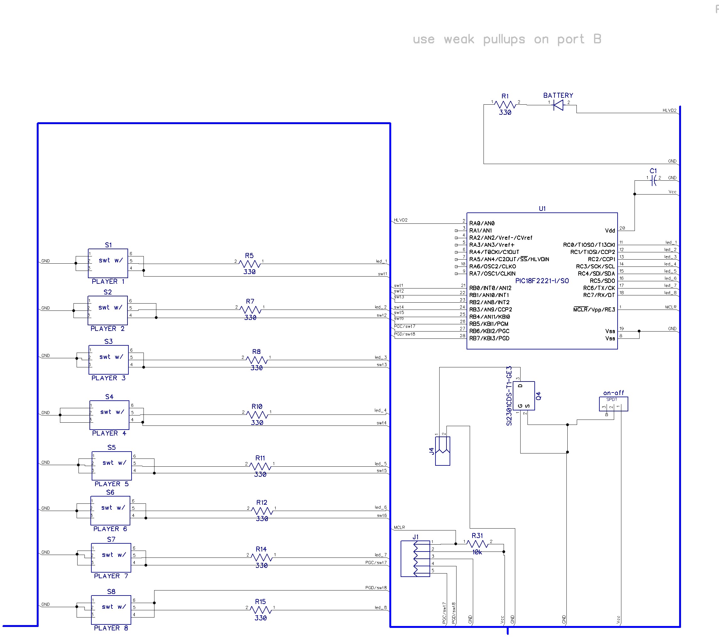

Working on a simple battery protection (reverse) using a P chanel mosfet.
Using octopart to locate and most suppliers have no stock.
Even went to Ebay.
battery source is 6v
amperage draw under 1 amp (300-600ma)
still searching wanting to avoid outside the USA

yes I watched the video, thanks very informative.
I redid the schematic and need to recheck if the pins are connected correctly.
Here is a redo of schematic using the LIBRARY LOADER for the correct pattern
Remove the connection between the fet gate (G) and source (S)... you're shorting the output (S) to GND (G).

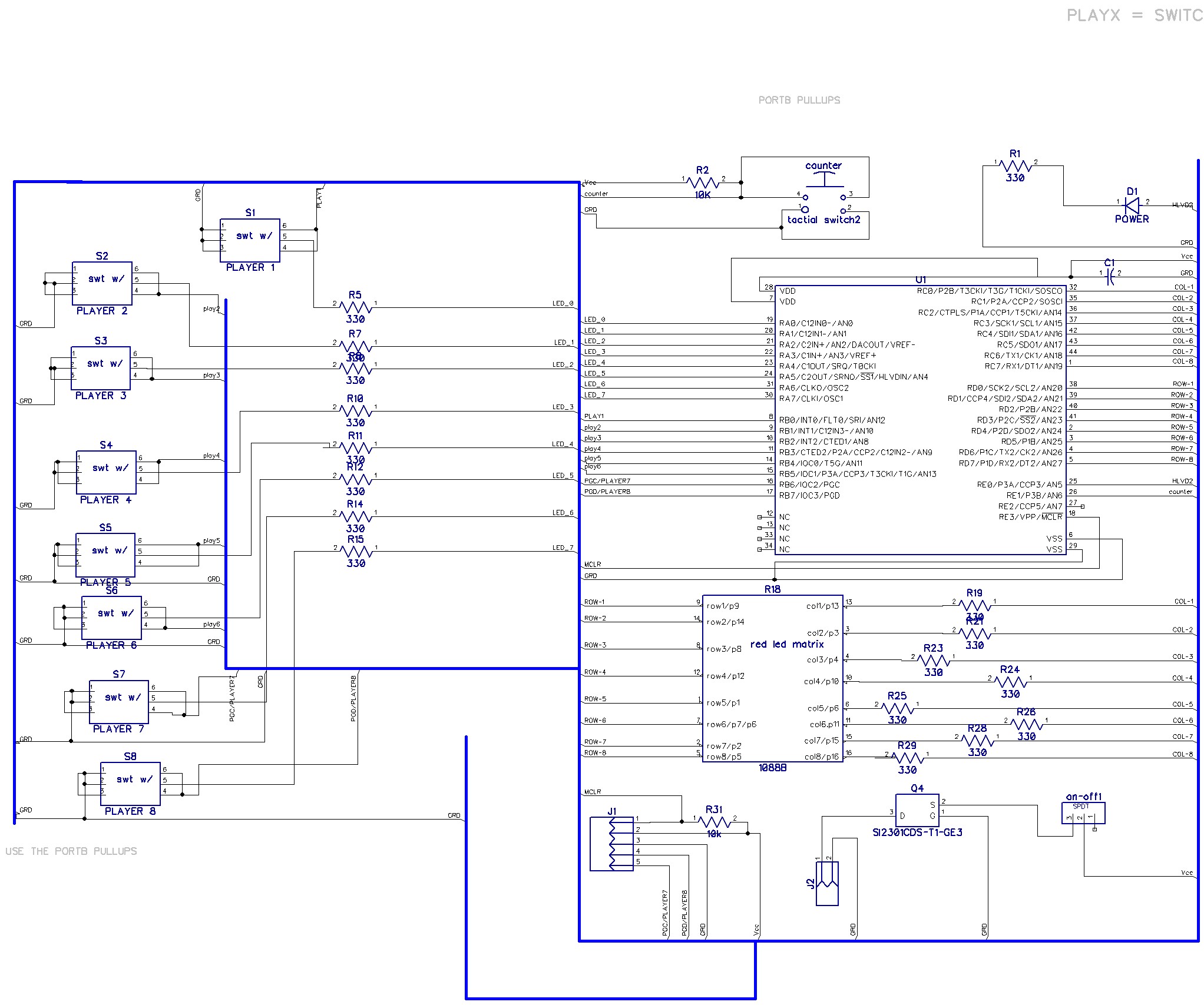

Well finally got my mosfets and soldered one on the board.
Now It won't program.
Thinking back to a discussion with Tumbleweed, I may need to connect a jumper from Vcc to the Drain on the mosfet.
or pull the mosfet off and see if I can program.
WAS working before I put the mosfet on the board.
