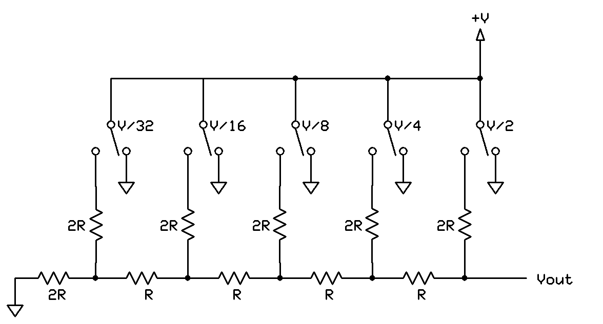

I have 5x pushbuttons and any one can be pushed at any time I want to capture "button pushed" with a cheap datalogger like OM-EL-USB-3 0-30vdc single channel. It will record only every minute so I need a circuit to capture the button push. I was thinking of 5 x 555 1.5 minute monostables with a differant voltage devider on each output and this connected to the logger via diodes. Any better ideas please?

It looks like your logger will resolve 600 levels at 30V. I might suggest an R-2R ladder digital-to-analog converter. Each switch represents a binary bit of a 5-bit word...32 levels. By pressing a switch it outputs a specific voltage. Only five specific voltages are valid...plus zero. If more than one switch is pressed a non-valid voltage is outputted. You would need to sort the valid from non-valid in a database after the download.

Yup, you missed the earlier posts. The logger is acquiring brief voltage readings at 1 minute intervals. A button push (voltage) would only be detected if it were held down for a minute or longer. The R-2R ladder would differentiate which button was pushed, but the voltage level would have to be held "accurately" for more than a minute, like a sample and hold. Any ideas? :)
