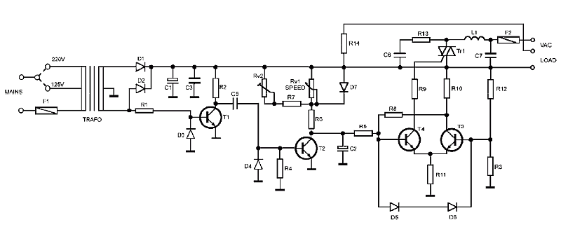

Can anyone help me with this circuit.
I would like to know how this works.
I intending to try out this circuit and build it myself.
Can anyone help me explain on how this circuit works.

The circuit loks like a dimmer. You got a triac together with something that looks like a simple diferential amplifier circuit. But there is no sign of voltage levels or other component values.
The circuit controls both low voltage (from 24VAC to 240VAC at 5.5A) AC motors and mains voltage (110VAC or 220VAC) loads.

T1 is just a half cycle 60 Hz amp.
When T2 shuts off the variable resistors and cap C2 determine the turn-on cycle delay to trigger the Triac.
T3 & T4 is a voltage comparitor with R12 & R3 providing the reference.
The Triac shuts down on zero current crossing.
L1 & C7 just EMI filter. R13 C6 is snubber across Triac to prevent false trigger by inductive load.
What does D7 do?
Also, doesn't appear to be any bias on Q4 collector circuit. I don't think it will actually work.
Even it it did. There should be a much easier way to do this.

The only thing you have to do is delay the trigger signal to the triac. Look at this linked webpage. This is a very simple circtuit. The resistors, capacitors and diac determine the trigger phase, and thus the power delivered to the motor.
I reached this site by goggling "triac motor control" There are lost more.
