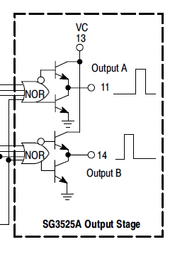

On the SG352x series of chips there are two outputs, each capable of 0% to 45 - 49% duty cycle. The only problem is the is a dead time between the outputs, they are not 'seamless'. They say the minimum duty cycle is 45% of each output but can be up to 49%. If you look at the timing diagram, in the block diagram on page #2 of the data sheet https://www.google.com/url?sa=t&rct...51P7VtFlavz3ekKTZUwHvlA&bvm=bv.76802529,d.aWw you can see it. The end of the first duty cycle does not coincide with the start of the second. In the circuits the chip was developed for this wouldn't be a problem. I tried to use it as a PWM to drive some logic and the dead time caused a problem. I wasn't saying Ronv was driving logic or a motor, just making a comment about the SG/KA 352x series of chips. Sorry I broke into the grownups talking. :)

I have a dumb question about a wired 'or'. with no diodes. How will that work, being that the SG352x chips are of the totem pole output type? With out diodes in the 'or', when one is on the other will sink its output. That is the reason for using two diodes to make the 'or', at least that's how I understand it.
The outputs of that series of chips(SG/KA352x) alternate they have a "small" deadtime between them. I know I'm far from the rest of you guys level of understanding of this stuff, that's why I'm asking.
It's really kind of sneaky. :eek:

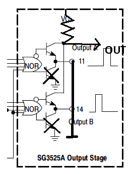

If you ground both outputs and add a pull up to say +12 to Vc, the bottom transistors still switch, but they are already at ground. So the only thing doing any work are the top ones.

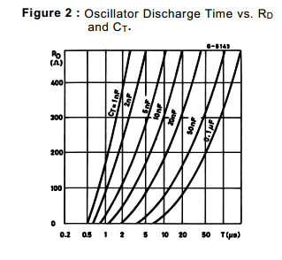

I had written a similar reply earlier, but was waiting to see whether I had a chip I could test for the effect of the deadtime. I didn't and the time got away from me. However, looking at the deadtime resistor value vs. discharge time figure, we can see that deadtime does not go to zero.
I am not certain how that would effect the OR'd output in real life, but it may cause a glitch in the output. For example, at 10 KHz, the period is 100 µS. A 1-µS deadtime when both of the top output transistors are off would limit the theoretical duty cycle to 99%. Perhaps more important than that "glitch" would be the heating from turning the power mosfets on and off.
John
OK, another dumb question. If the outputs(pins #11&#14) are grounded, where does the output come from then?

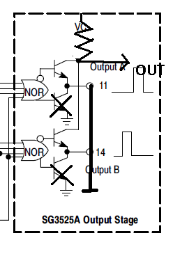

I have tried to draw the changes with Paint -- not very good.
By grounding the outputs, you effectively remove the bottom two npn transistors. The remaining two are open collector. Add the pull-up resistor to a source (VC) and take the output where I have the arrow. When either or both are on, output will be low.
John

Thank you John! After asking the question and thinking about it while working later I came up with the answer on my own, just like your answer. If I keep at this long enough I'll finally understand more about it. Hard to learn something new at my age, especially something this complex.
Another dumb question about this. When grounding the output pins and using the Vc pin as the PWM output, doesn't this mean that the voltage used to the PWM is then reversed/inverse? Buy that I mean, a lower control voltage gives a longer duty cycle instead of a shorter duty cycle. Sorry if I seem to have hijacked the thread, just trying to learn more.
Yes, that is true. So in some cases you might need to reverse the input or invert the output.
