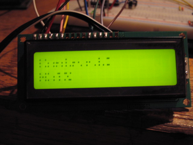

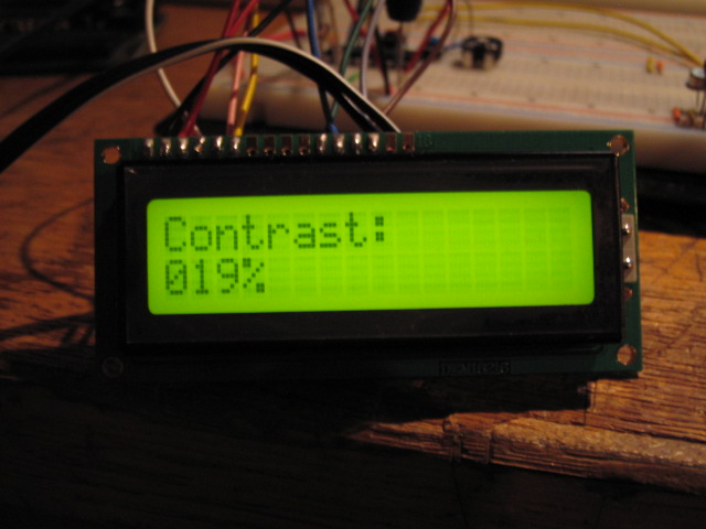

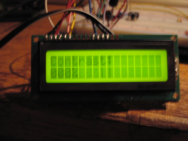

OK my initial tests show that filtering is definately required.
Here are som pics. There is some distortion that doesn't show well on these pictures.

That's pretty cool. 8) What was the PWM rate for your contrast signal? And what kind of filtering did you have to apply?
100% is 100% PWM and 0% is 0% PWM, so actually it should say 'PWM' instead of 'Contrast'
I did some experimenting. Used a 330ohm and 10µF as a lowpass filter. It showed some distortion on higher PWMs. After increasing the capacitor to 100µF the distortion dissapeared. So a capacitor between 10µ and 100µ would be optimal.

Actually, I just meant the wave period in general. Was there any flickering that was noticeble to the naked eye?
Umm... YES! as you can see from the pictures (without the filter that is).
Or am I not still understanding your queston? :)
