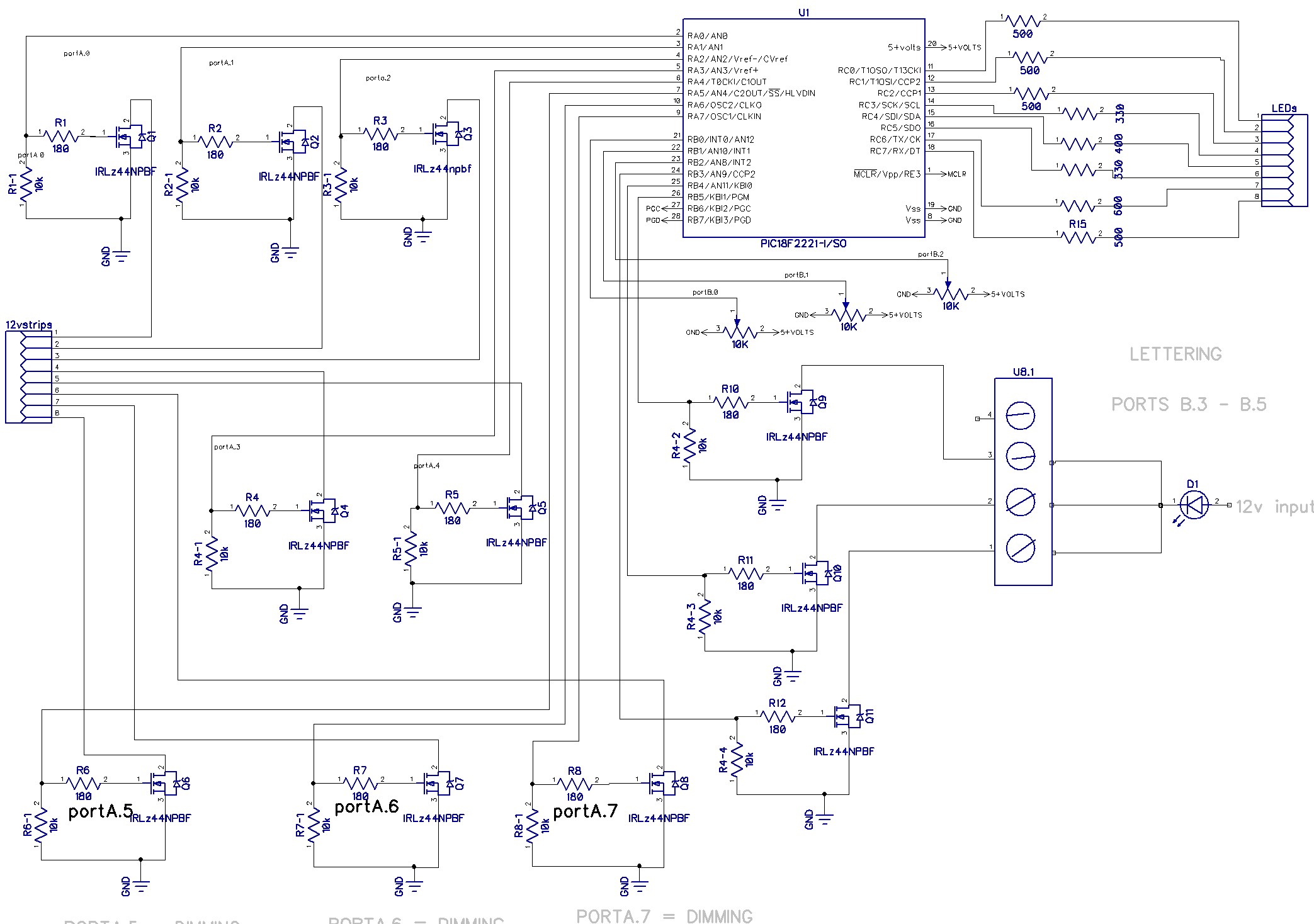

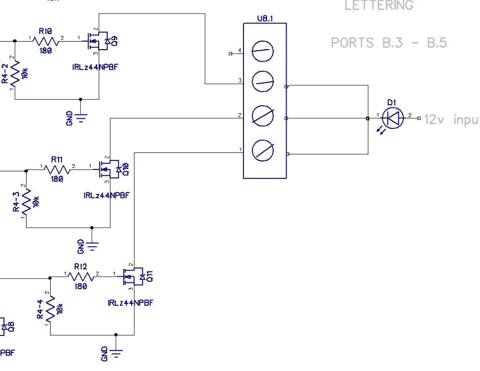

I breadboarded this circuit and it seems to work driving just an LED but I am driving a 12v led neon strip.
The circuit flashes the strip slowly to fast as per pot adjustment.
The 555 circuit works as planned with one LED (it is supposed to change the duty cycle
Thinking the two different supply voltages has something but what to do? Any suggestions?
NOTE THE 7555 IS POWERED BY THE pic
the MOSFET is logic level

thinking about going back to the schematic in post#45 using the 555 timers as the PWM suggested by tumbleweed is good but I need to have DELAYMS() to simulate drinking straw and glass being filled.
several corrections to schematic in post#45 eliminate the 9v regulator
here is basically what I am trying to do but all the DELAYMS() will mess up the PWM section. I tried adding a second timer but no can do. I tried post 14 and it works as planned but need the drinking simulation
Sounds like a good idea to change direction again.
I don't know why I do this...
No it won't. The only thing the delayms() calls will do is make it difficult to adjust the PWM since it delays reading the pots. The outputs will still pwm just fine.
Did you ever make the 'straw_x' and 'drink_x' pins outputs? (answer: no, I didn't).
Also, you have 'Drink_5 as porta.5', which is the same pin as PWM1 so 'Drink_5' is going to be pwm'd.
Here's what #142 might look like if it was written to work, keeping in mind I have no idea what you want to do...
(This doesn't fix the 'Drink_5' and PWM1 conflict though. That one's on you)

If popcorn looked, I stated delays are a no-no right next to the while true statement BUT in tumbleweeds suggestion it has a delayms??
will make corrections and run it today thanks
Here's what I think you might be after...
it has the animation, and it allows you to use the pots to control the Drink and Straw outputs which are pwm'd.
POT1 controls 'Drink' outputs, POT2 controls the (unused) PWM7 and PWM8 outputs, and POT2 controls 'Straw' outputs
Because of the delayms() calls it may take a second or two to react to adjusting the pots, but that won't stop the pwm.

using this schematic with 3 MOSFETs in parallel. need to keep the MOSFETs from getting too warm. I really should redesign the board and use the PCboard as the heat sink. Trying to keep the current per MOSFET below 2 amps and the lettering has the most draw (I need to remeasure all the circuits)
hopefully this should work?
If this is what you're talking about (hard to keep track of the differences in the dozens of schematics you post).....
... the answer is bad idea. TI's Application Brief Tips for Successfully Paralleling Power MOSFETs explains:
The current in each FET is proportional to the inverse of its on resistance, RDS(on). Naturally, the device with the lowest RDS(on) will carry more current. As it heats up, its RDS(on) increases, shifting some of the current to the other FETs. The junction temperatures of paralleled FETs with good thermal coupling will be roughly the same. Current sharing still depends on the relative on-resistance of each FET and will be within the RDS(on) tolerances specified in the MOSFET data sheet.
During dynamic operation, the FET with the lowest threshold voltage, VGS(th), turns on first and turns off last. This FET takes more of the switching losses and sees higher stresses during switching transitions. To some extent, the thermal sharing effect balances out the switching and conduction losses, and the FETs will operate at roughly the same temperature.
Best Practices When Paralleling Power MOSFETs
Here are helpful tips when using FETs in parallel:
• Each FET needs its own gate resistor with a value from a few ohms up to tens of ohms. This helps with current sharing and prevents gate oscillations.
FETs need good thermal coupling to ensure current and thermal balancing between devices. They can be mounted on a common heat sink or copper plane to maintain equal temperatures.
• The placement and layout of each FET should be identical and symmetrical, within reason, to equalize parasitic inductance in the critical gate-to-source and drain-to-source loops.
I guess MrDEB doesn't like my answer, since he didn't even acknowledge it. *shrug*
I don't know why there is even a discussion about heat of that mosfet, heat sinking it, or even paralleling it. These are beasts and, with an R(on) of only 22milliOhms, will generate only 88mWatts of heat plus switching losses (I doubt will be over a half-watt (which is my advice for using a heat sink).
My advice would be to set it up with a single mosfet on each string of LEDs and feel if they get warm (I doubt it). If (IF!) they do get warm, not many big concerns because these beasts can handle a max junction temp of 175°C. Good luck, MrDEB. No need to help the OP over-over-engineer it.
ZipZapOuch – The QUESTION was asked and answered with an authoritative reference – will MOSFETs work in parallel.
I don't know if MrDEB thinks the MOSFETs are getting too hot or if they may actually be too hot. I don't know how much if any heat sink area they have on the board (although I do believe I mentioned it with illustrations). I don't know what current is being drawn – I believe there are specs for some LED neon in the 8 pages of this thread or in any of the 3 or 4 equally lengthy threads, but that may or may not be accurate in any case. The question ASKED was answered.
I don't read many of your replies in this forum, but in the few I do read, you're ALWAYS argumentative. Whatever gets you off I guess.
Or, you could have just clicked, "like".
In response to post #154 I just got back on my computer today, Monday February 4 2024
Hopefully, my PCboard enclosure gets here today, then I can test all the strips as well as the current draw and heat of each MOSFET.
I will post the measurement data after I get the board mounted etc.
