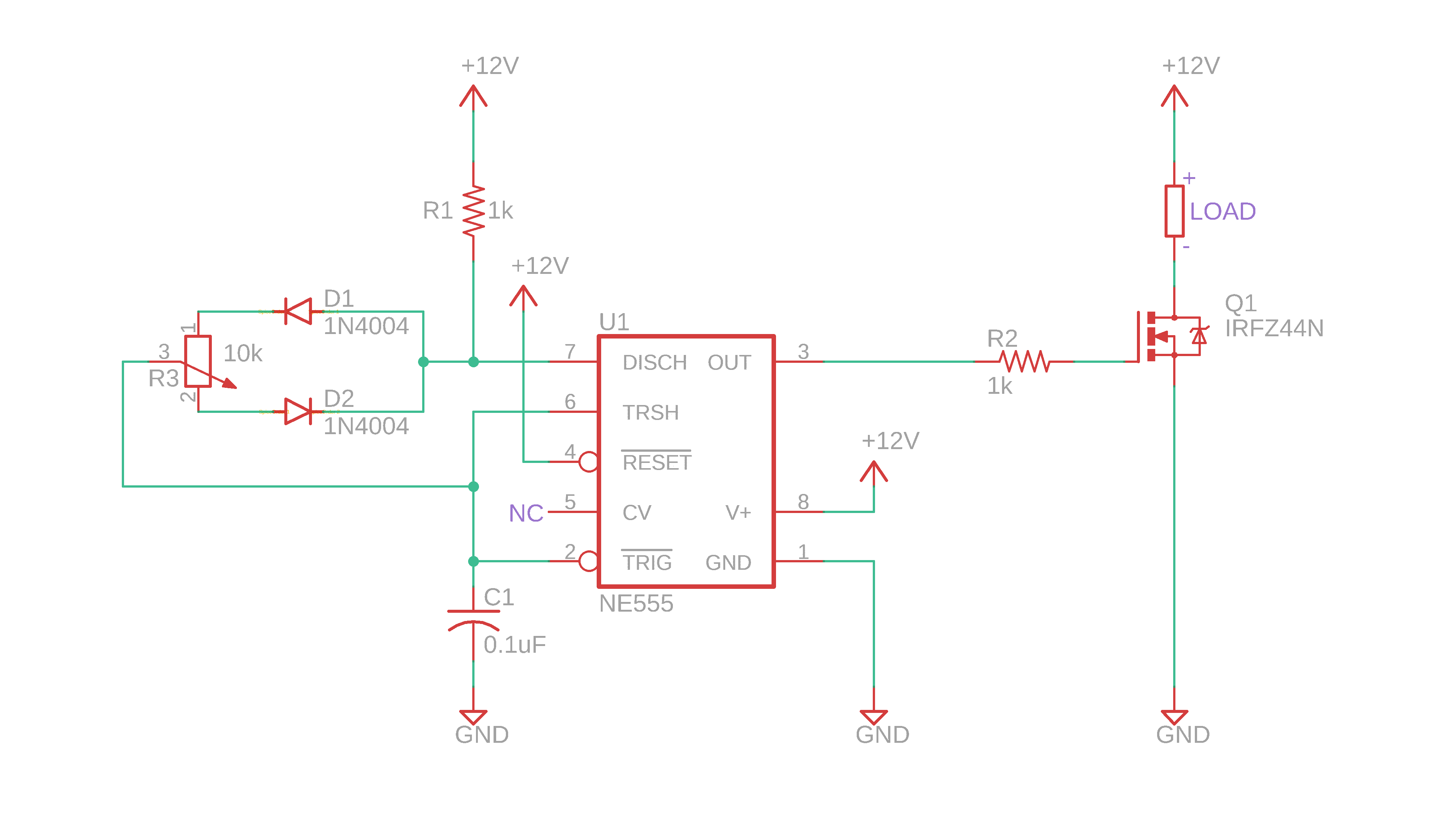

using PWM to dim LED NEON STRIP
MrDEB
couldn't locate this thread but here is the issue
I breadboarded this circuit and it seems to work driving just an LED but I am driving a 12v led neon strip.
The circuit flashes the strip slowly to fast as per pot adjustment.
The 555 circuit works as planned with one LED (it is supposed to change the duty cycle
Thinking the two different supply voltages has something but what to do? Any suggestions?
NOTE THE 7555 IS POWERED BY THE pic
the MOSFET is logic level
Well after tracking down all my wires etc. then testing I get too much flicker using the PWM that Tumbleweed provided. I can adjust the pots some what for less flicker. Need to look in to a faster clock speed?
using the schematic in post#152.

No I am using the schematic in post#152
One mosfet per pic output.
Attempting to just turn on each MOSFET separately.
Using the code you provided seems to work, BUT lots of flickering and adjusting each pot separately changes the output on all three separate LED strips.
Thinking of maybe a software dimming as I did on my Christmas stars??
I don't know why I think of this when I read these threads?
Before I try and decipher what you did, back in post#150 you said this:
the code in post#146 works pretty good but will run post#148 and move/ re-lable some things, plus add 3 more mosfets if needed but not sure.
Is that true? The code in post#146 worked ok?
You can't just randomly start twiddle the PORT bits directly the the loop and still have things work.
post#148 and post#167 have issues with excessive blinking regardless of the pot settings (ports (B.0, B.1, B.2 ). I adjust one pot and it changes what the other PWM ports are doing.
I am going to rethink this setup.

after thinking about post # 170 using only a pot, a cap, and Mosfet, the example on YouTube is way out of touch. The Mosfet WILL get hot as it is never fully turned on.
I plan to build a circuit on a perf board using a 555 and the 12V supply for PWM to get a higher-frequency output for dimming the LED strips instead of using the 5V supply on the PCB as before.
If this works then will add 2 more 555 stages for 3 channels then attaching to the PCboard.
The code and added suggestions are too erratic. The strips blink, and then one channel blinks momentarily for 1/2 second. Adjusting one pot affects the other two channels.
Switching inputs is why I am considering a separate circuit using a 555 to generate the PWM then use the pic to control the 5v LEDs on portc and the porta outputs for controlling the dimming of the glass, ice and red straw only.
Plan to assemble the 555 circuit on a separate perfboard
