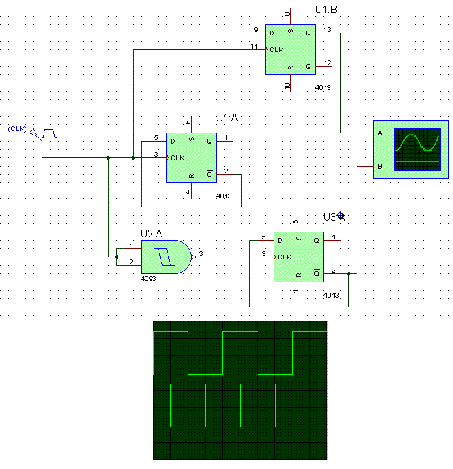

Is this what you want?
CLK can be from a 555 or ? Should work from >0 to 100k no problem. (remember output frequency will be 1/2 of clk in)

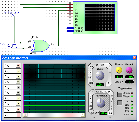

Ok, well you say 0-1000Hz well, phase doesnt make sense down at 0Hz.
Are these digital signals? You need 90 phase shift on digital pulse train from original signal? And both the freq can be 0-1000Hz? Do I understand this correctly?
If so:
1) create a circuit with 2 555's that with one pot you generate frequency F on one and 2F on the other. Maybe pot can generate 2F and make a divide by 2. lots of examples on the web....
2) Take 2F signal and XOR it with F. The output will be at frequency F but phase shifted by 90 degrees from the one input that is at frequency F.
3) this thing will maintain that phase shift while you adjust base frequency.
Do you follow? I'm too tired to draw a ckt.. but lemme know if this sounds like what you need........
Optikon's method may seem to be an easy (text book) way to do it, but due to the "race problem" you may have unwanted glitches on the output like is shown in the simulation. Happens when the 2 inputs are changing state at the same time.
Race conditions should be avoided in circuit design primarily for the unpredictability that will be created. One way to avoid such a condition is to insert a time-delay into the circuit
https://www.electro-tech-online.com/custompdfs/2004/12/EXPT170.pdf
You need to fix that with a few extra buffers or delays. Where as clocked sequential logic is clean.

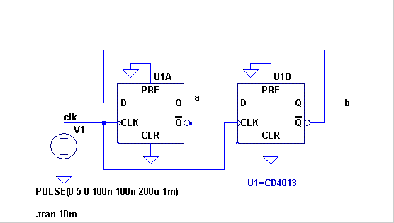

A 2 stage Johnson counter is a little simpler. Outputs "a" and "b" will be in quadrature.

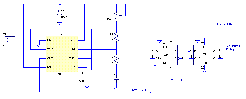

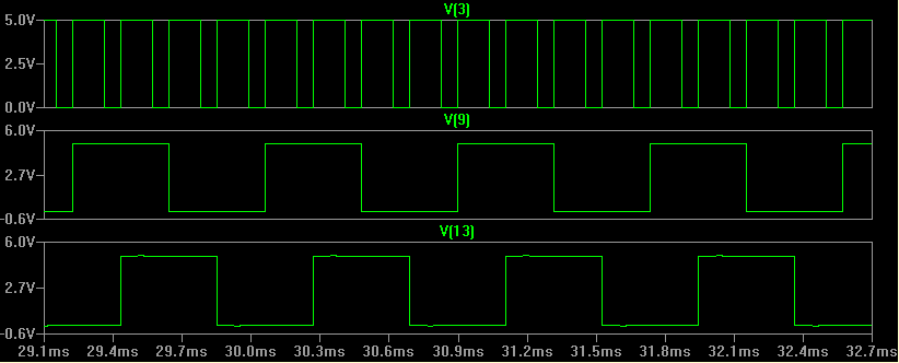

Here is a useable schematic, with waves. Post any questions you have.
Hi Ron, I wonder what those small bumps are on the V(13) trace?
It's definitely not glitches. I can't reproduce them on my program. Just curious? Maybe it is some artifact of the model.
The flipflops are behavioral.
I reran the sim, this time specifying a maximum time between samples. The artifacts were present for any specified time greater than 1usec. The bumps were caused by the simulator.
Thanks for that Ron, this looks to be exactly what we are after.
How will the amplitude of the wave be affected by using 12V supply ??
birdleg said:
A 12 volt supply will make the amplitude 12 volts. Be sure you put current limiting resistors between the outputs and your PIC inputs. Why can't you use 5 volts?

Hello Ron
We have just spent some time building the circuit you posted up and have so far got no satisfactory results.
the 555 timer part of the circuit is virtually identical to three PCBs we have already made up which give us our frequencies in the right range. The only difference between yours and the ones we have is that pin # 7 is not connected at all on the 555.
When we built the two stage Johnson circuit however there appeared to be some confusing results I was hoping you could maybe clarify.
Pins 6 & 7 on the 555 had a voltage present of around 6V varying up to 6.2V through the 1M pot. We have point to point tested all the circuit and it appears to be fine. We initially thought that the 555 was inserted incorrectly so we tried putting it in the opposite way this then gave us a voltage at pins 6 & 7 of between 0.75V to 1.2V but the Cd4013 U2A got hot real quick so we shut it down and replaced the ICs back to how they were previously.
