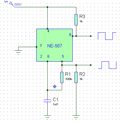

Here is yet another way of getting two quadrature outputs using a tone decoder. Frequency set by R1,C1
