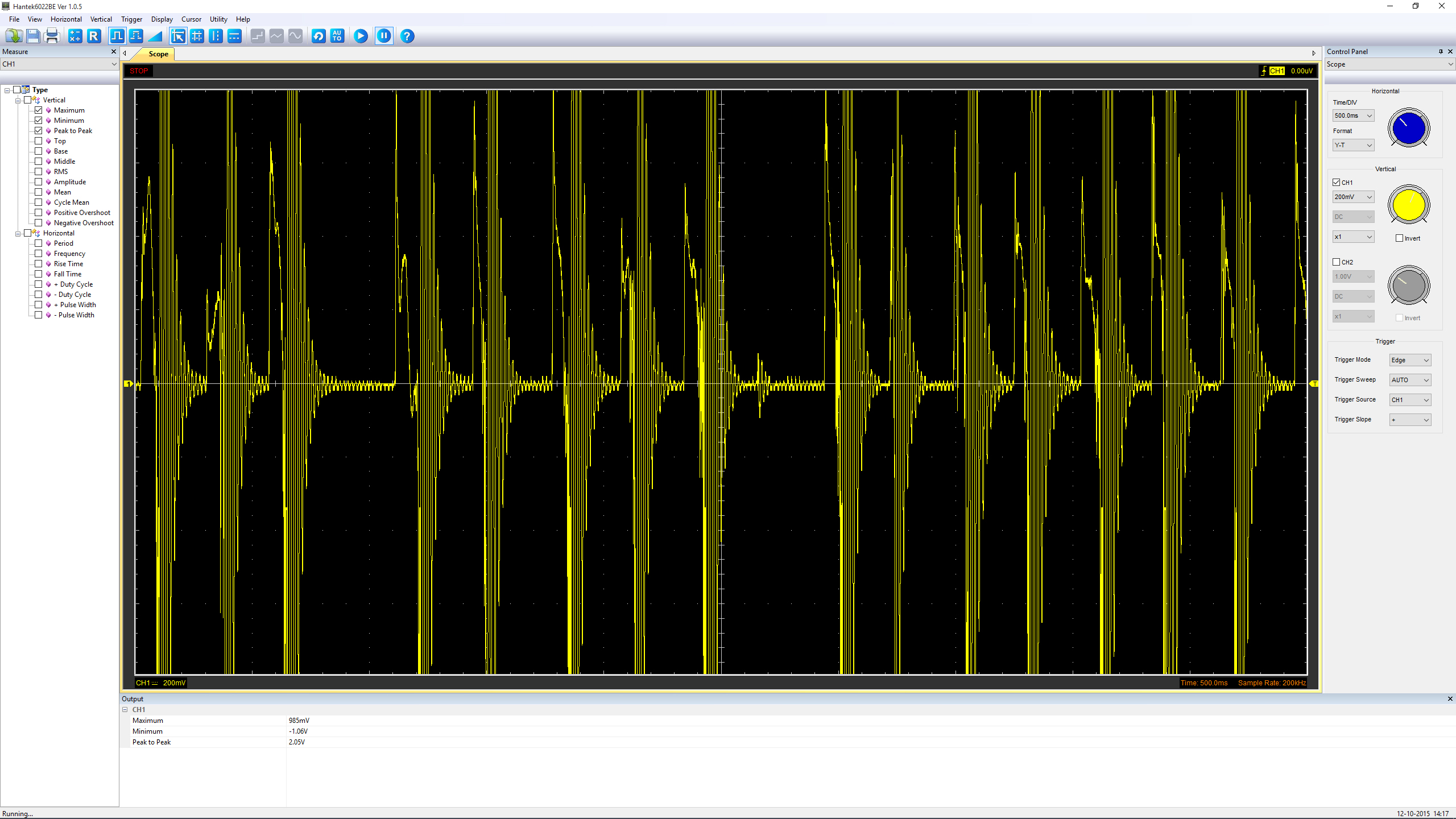

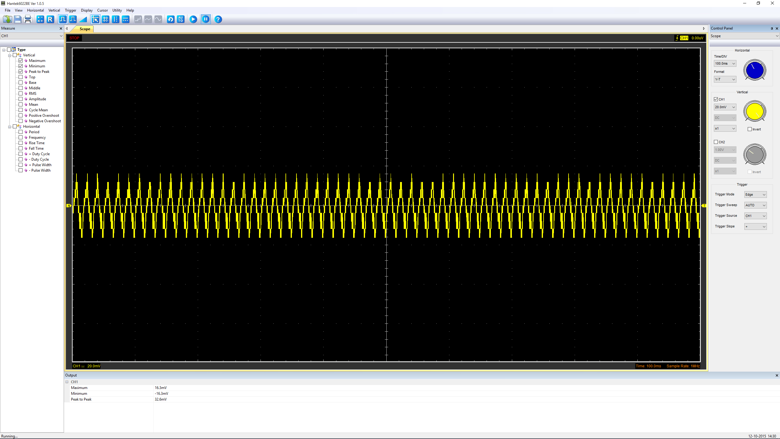

Yes the sensors do show a nice curve in the Oscilloscope but only when sampling over 500ms to 1s. I connected the sensor to the probe of the Oscilloscope (cheap Hantek 6022BE, which for my purposes at the moment is more then enough) ans tipped slightly on the sensor ans there is a nice shaped curve which is very high at the beginning and has a slow downwards. The period is very very fast. I will try to catch via screen shot such a curve and post it here.
Here are some samples with the Oscilloscope
Picture with the nice even curve is base noise = +-16.3mV
Below a curve when I really tip strong with the finger. Every rise is a tipping on the sensor.

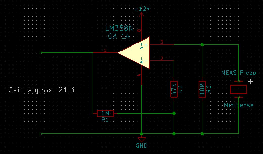

EUREKA
it is working. The trick was to use a 10mΩ resistor parallel to the outputs of the sensor. The chip is the LM358
Circuit schematics

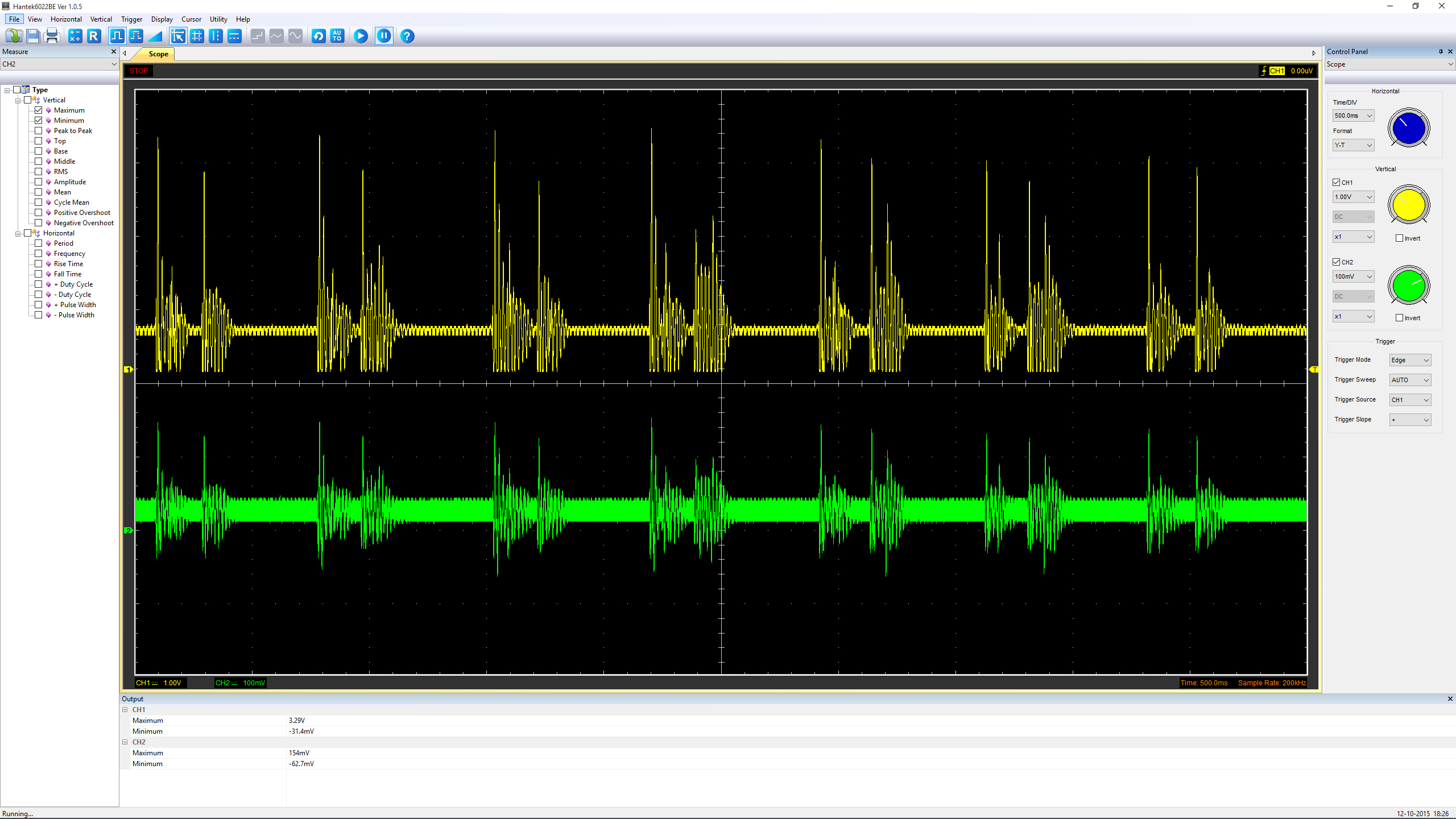

Input and Output at the Oscilloscope

It looks like we are seeing the artifacts of a digital oscilloscope instead of seeing the sensor signal. What is causing the repetitive signal and what frequency is it (I cannot see the 'scope setting)? Is it mains hum picked up?
The maximum input bias current of an LM358 is 0.25uA which in your 1M input resistor will cause the input voltage with no signal to be up to +0.25V. The opamp amplifies it and its output can be 21.3 x 0.25V= +5.33V. An LM158A has a maximum input bias current of 0.05uA. Or if you do not want this offset you can reduce the 1M resistor to 100k ohms or less.

Hi audioguru,
The signal is from me drumming on the breadboard with a finger. Look at the attached image. I drummed with the finger 2 times quickly with a pause inbetween.

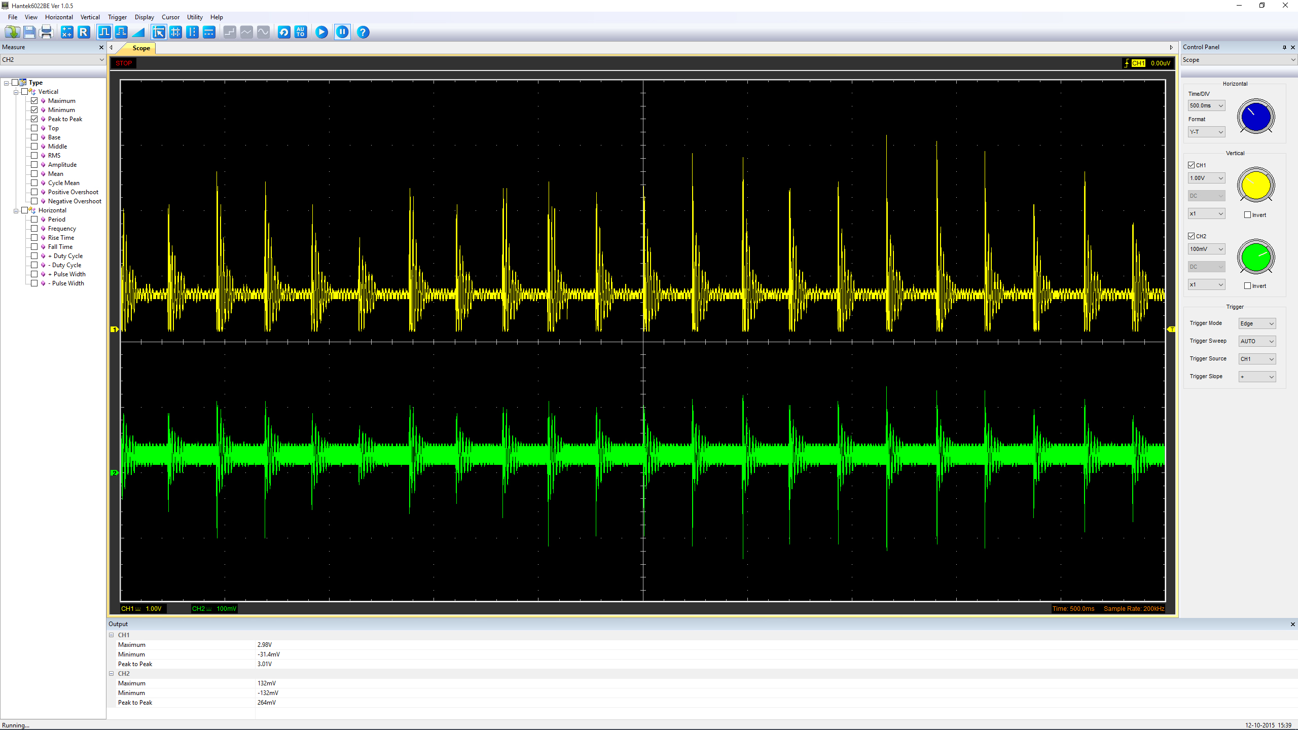

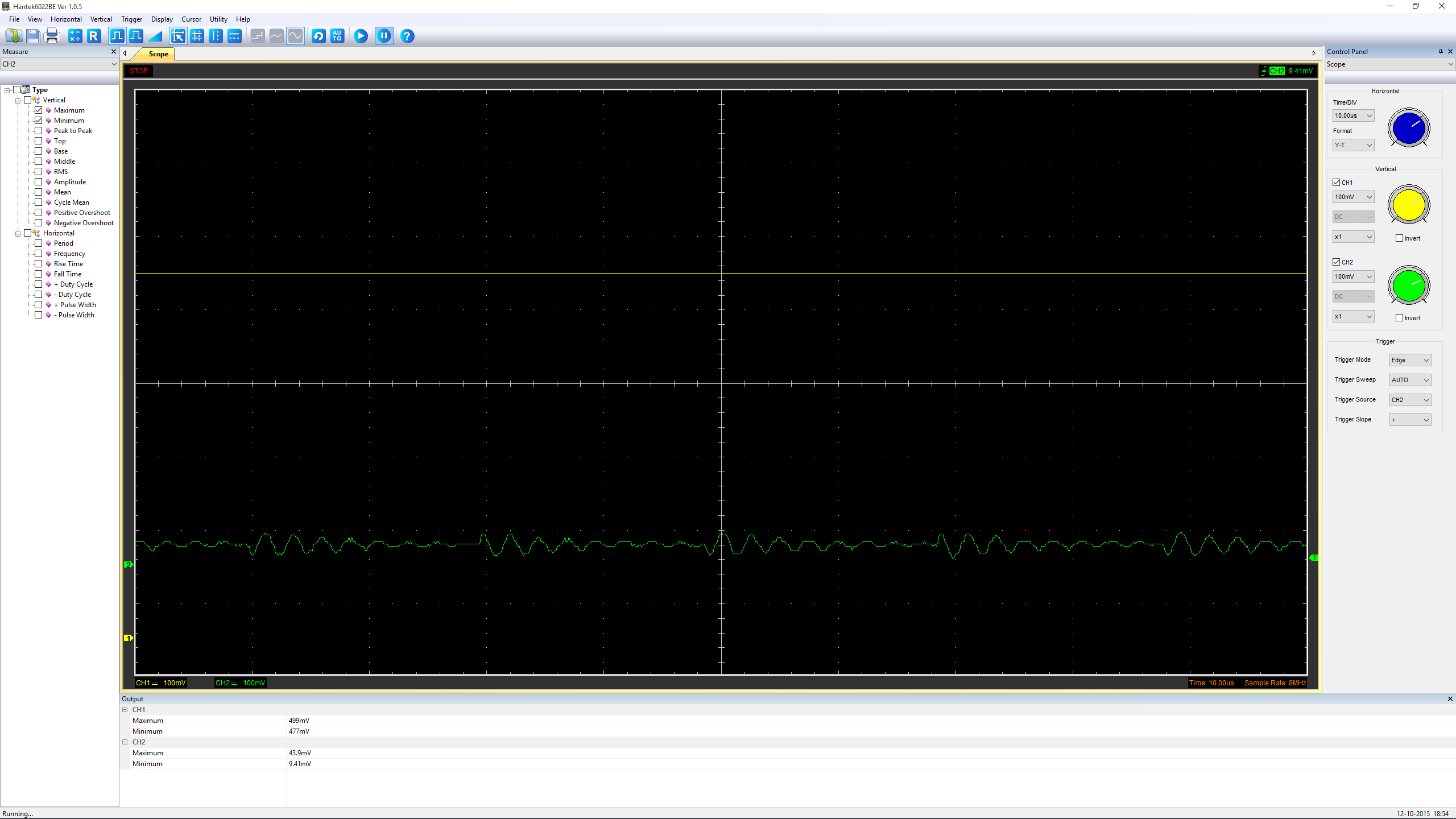

On the attached image you can see the output when the piezo sensor is not being excited.
The yellow line is the LM358 output and the green line is the input signal into the LM358.

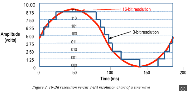

Here is a digital trace with high resolution for a good 'scope and low resolution like yours.
To assist in calibrating your circuit, I'd suggest replacing resistor R1 (1MΩ) with a 1M linear potentiometer, wired as below:
This will allow you to more easily adjust your gain as you find the "sweet spot" for your system where average pier vibration generates an average indication level with your (eventual) LED light bar.
