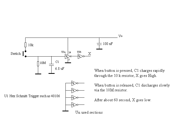

I am working on a project where I need a delay between switching polarities on a motor when reversing direction. The carriage needs to stop, perform a specific function, then return to original starting position.
The motor will be used in 2 different circuits of opposite polarities and voltages. the seperate voltages are for controlling the speed of the carriage. I realize that I will need a delay so that first circuit can shut down before second circuit energizes.
My question is, "Can a 555 timer be used in this application or is there a chip that would be better suited?"

The 555 is still a pretty neat gizmo. It's not used as much today because of shrinking electronic geometries, but remains a decent way to get a delay when needing to wire up something quick and dirty.
There is also the CMOS version which is the 7555 which draws less current in the quescent state.
You can also use CMOS Schmitt Triggers such as the 74C14, 40106, etc. which consume < 1 uA in the quescent state. But they have a wider spread of threshold voltages than the 555s. This means that you may need a trim pot to trim the timing since there will be more spread in the calculated delays than with the 555s.
However, you may need a trimpot with the 555s also since they do have some spread. Also, the resistors and capacitors used for the timing have a spead, particularily electrolytic capacitors.
Attached is an example of a Schmitt Trigger delay.

John,
There is no argument.
The data sheets clearly show that the CMOS Schmitt Trigger ICs have a wider spread than the 555.
Here is a copy from the 74C14 data sheet
VT+ Positive Going Threshold Voltage
VCC = 15V
min = 9.0 typ = 10.0 max = 12.9 V
Spread = 12.9 - 9.0 = 3.9
VT- Negative Going Threshold Voltage
VCC = 15V
min = 2.1 typ = 5.0 max = 6.0 V
Spread = 6.0 - 2.1 = 3.9
And this is from the 555 DS
VTH Threshold voltage
VCC=15V
min = 9.4 typ = 10.0 max = 10.6 V
Spread = 10.6 - 9.4 = 1.2
VTRIG Trigger voltage
VCC=15V
min = 4.8 typ = 5.0 max = 5.2 V
Spread = 5.2 - 4.8 = 0.4
As you can see, I've calculated the spreads & posted them in red.
The 555 has significantly less spread than the 74C14.
