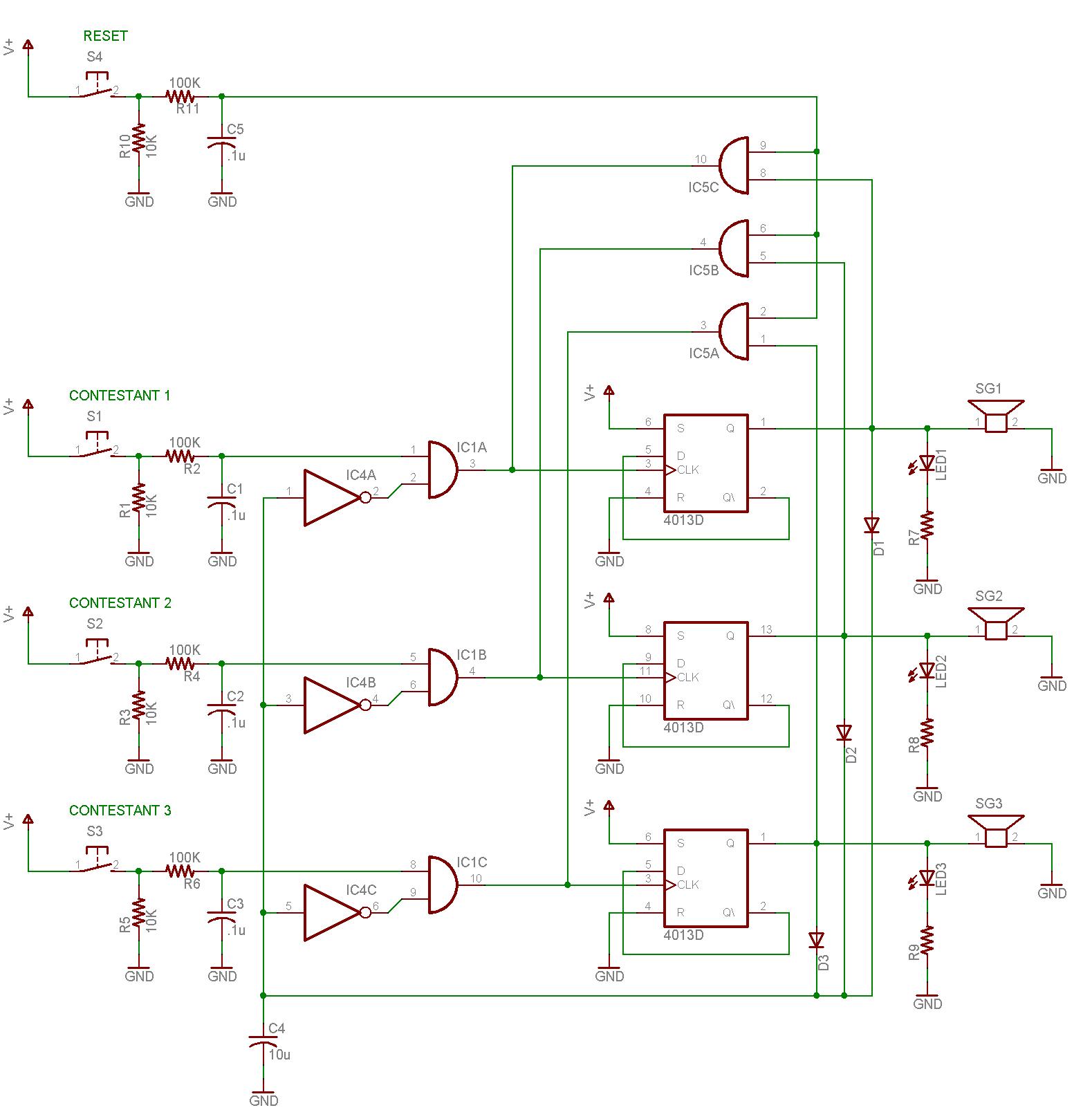

I wish to put together an electronic controller which when asked a question the contestant pushes a button thus activating a light and buzzer, but also eliminating the other contestants. This then is reset for the next question.
I am a total novice and also this probably has been answered previously but there is a lot of threads to review. I did down load a project from RSH electronics and reviewing their diagram. Any easier projects will be appreciated.
Thank youΩ
The simplest way to do this would be with a microcontroller but if you are an extreme novice it could take you a while to get up to speed. Don't get me wrong, I encourage you to learn and if you want to go that route there are people here who can help you. However, if you would like to pursue a solution other than the microcontroller, what you want to do can be accomplished by using standard logic ICs. I threw together a circuit that will probably work for you and you can scale it up or down for as many contestants as you'd like. Someone please double check this for me.

the schematic that VNE147 posted????
won't prevent the other contestants from sounding the buzzer. At least after lookng at it several times??

The circuit that vne147 shows does not cancle out any oher input.
I don't think this is true. The outputs of the 4013 D flip-flops are dioded, tied together, and then inverted before being fed into AND gates that are between the pushbuttons and the 4013s. If the output from any one of the 3 4013s goes high, it is inverted into a logic low which makes the output of the three AND gates to the left of the schematic go low. The output of these AND gates will remain low regardless of additional button pushes because one of the required 2 inputs will remain low as long as the output from any one 4013 remains high. That is how I intended it to work anyway. If I'm missing something please let me know.
I'm sure this circuit can be improved upon. It's just something I threw together quickly after a minimum of thought. The OP doesn't have to follow it verbatim, I just wanted to give him some ideas. One issue I have realized since I posted the schematic is that the buzzers will continue to sound until the reset button is pushed. You may want to tie the output of the 4013s to a 555 stage so that the buzzer only sounds for a second or two but the light stays on until the reset button is pushed.

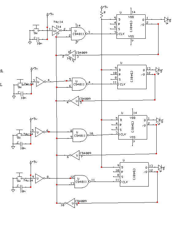

here is BASIC idea
I recall when I built similar circuit.
Basic idea is when a button is pressed it clocks its separate D flip flop.
upon clocking on rising edge the /Q output disables all the other push button inputs via NAND gate (HIGH(button), HIGH(/Q output) = LOW clock for all other push-buttons(clk inputs) which prevents all other D flip flops from clocking.
I may not have the schematic right but general idea.

I did test out the schematic that I posted in a circuit simulator and it seems to work. There are a few things that I've realized I can simplify since I originally posted it. If you decide to go with my idea, I can send you an updated schematic.
