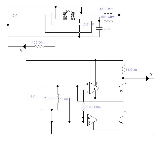

i've tried this circuit, and i connected a LED to the pin 1 of the op-amp and ground to the cathode of the LED. when there is no signal, the LED is high.
Post detailed schematics of the transmitter and receiver that you are using, with component values.
yes.. the 555 is the tx and the LM393 is the rx.
the 684R is a 1K VR.
the LED's are connected to see whether it receives signal or not by blinking.

What are you using as a transmitting antenna? Forgive me if you've already answered that question.
You can't make a decent receiving antenna with a 2200uF cap and a 10mH inductor. The Q of the inductor is much too low. Seeing a blinking light should not be your primary goal here. :roll:
You would be much better off trying 10kHz, like Russ suggested. If you want to make sure your 555 is oscillating, touch a 10uF cap across the .01uF timing cap momentarily, and see if the LED flashes.
BTW, if you have an LED in series with your loop antenna, that will reduce the current in the loop, which will reduce the sensitivity (which you may or may not need). You could use a separate LED and resistor, to either GND or +5V. you don't need much LED current. A 300 ohm resistor should suffice.
the 100 ohm as transmitting antenna.

i don't get this, how to touch a 10uF cap across the 0.01uF? in series or in parallel and the other pin connected to the ground?
and.. for the receiving part, i get a 1 when there is no signal, it shouldn't be, right? i connected a LED from output of the rx and ground. but it gave 1 when there is no signal. how come?? :roll:
There is one mistake.
According to the Receiver circuit the "tank" circuit you made is connected to the input of the amplifier. This gives the indication that you are trying to receive your signal through radio waves.
But when I look at your so-called transmitter, it actually isn't a transmitter which works for your circuit, because it sends output to either an LED or an infrared light.
Did you look on the internet for FM transmitter schematics?
And, I have to agree that your inductor value is very high.
For better performance, you should try lower inductor values. If you must keep the same frequency, just increase the capacitor value.

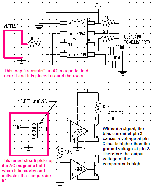

my output of the receiving part is always high. it should be low if there is no signal, right? but how come?
Look again at my explanation:

okay.. thanks!! u mean, if there is no signal, the output of rx is high, and if there is signal, the output of the rx is pulses. am i right?

'bananasiong' , it has been already explained in the forum that the system is not entierly RF , actualy it uses magnetic induction(weak) between the loop (ant) and the i/p of op-amp. since basic principle is magnetic induction ,higher the freq better the result(refer:-rate of change of magnetic field) , The tuned ckt is used to reject other interferece emf that occur like the mains power supply freq..etc.also there is no need to use the LED .
