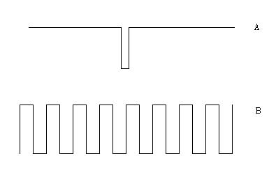

these circuit can be said that almost completed, but i found another problem. when there is no signal, yes, the output is high, but there is a low in very short time (i used cro to measure), as shown in A.
when there is signal, yes, i got square wave from the cro as shown in B.
my problem is, my microcontroller will keep reading to the output of the receiver. if there is a low (0), it will response to it and turn. but if there is a low when there is no signal, and if the microcontroller "assume" that it detects the signal because of the short low, then it will turn without any signal.
do u all get what i mean?
The random pulses are probably due to noise. You need to add some software filtering. Look for at least ten (or whatever) consecutive pulses before you qualify it as a command to turn.

I'll say it again:
You have to incorporate this into your program in your microcontroller. You know what the pulse rate is. When you get a pulse, look to see if another one occurs one pulse time later. If it does, look again one pulse time later. Do this in a timed loop as many times as you think is necessary to qualify the receiver output as signal, and not just noise.
There may be a much better algorithm that one of the other guys can suggest. This is just an idea to start you thinking. Or maybe it will work just fine. :roll:
good to hear that it works :)
for the noise problem , as ron suggested , that will be the cheapest solution .
in ur micro start a 'window' timer when a pulse is received , and count the number of pulses received during the 'window' period, and u know what will be the count when an expected signal is received.

Do you understand how powerful a microcontroller is? Spend some time learning to program it. As we have told you, it is the answer to your noise problem. You could spend months farting around with different kinds of comparators (a comparator is not an op amp) and filtering schemes. Also, if you get your transmit and receive frequencies to match, you will get better noise rejection. If you want to learn from a project, one of the most important things you can do is understand why it doesn't work the way you think it should. We always learn more from our mistakes and failures than we do from our successes.

It makes no difference what processor you use, if there's a spurious short '0' do as already advised and software filter it - basically don't respond unless the '0' lasts more than a certain time.
yes, i do agree this one.. but i have only the basic knowledge of controlling this microcontroller.. so, i need time to figure it out.
