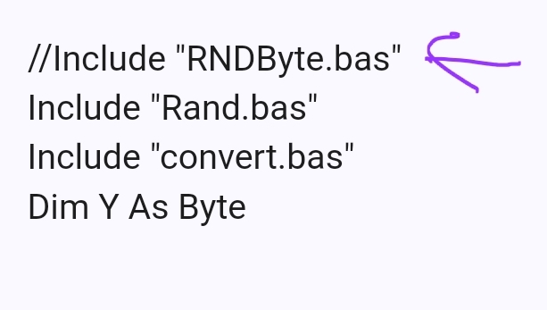

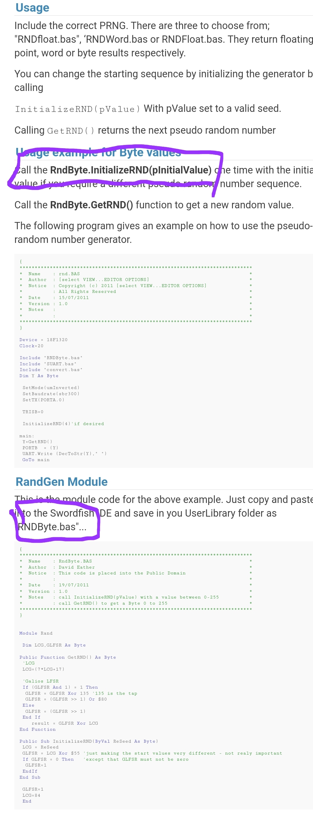

Have you ever considered – [cont]
Following the very explicit directions to use the module?
You did not follow the directions in the wiki about saving three versions of the include file depending on the variable type, so when the example code looked for the include file, it wasn't found.
Rather than spending a few minutes READING and UNDERSTANDING the "usage" part of the instructions, you ASSumed the example code was wrong and changed it.
Typical great job [/sarcasm]
I read and followed the Wiki instructions but the results were not what I am after. I even followed the post about the random number for 5 but couldn't get it to display on the LCD.
the only code that I got ANY results from is this code but it fails to display anything below 6. Only 255 or less Going to look at using a const array instead of a random number,

I think you misunderstand what the module does.
It doesn't give you a random number from 1 to 5, it gives you a random byte value 0-255.
There's no provision for getting a number limited to a range of values.
That said, it's pretty convoluted to have to use different code modules. I'll combine all that into a single module and let you pick the output datatype.
