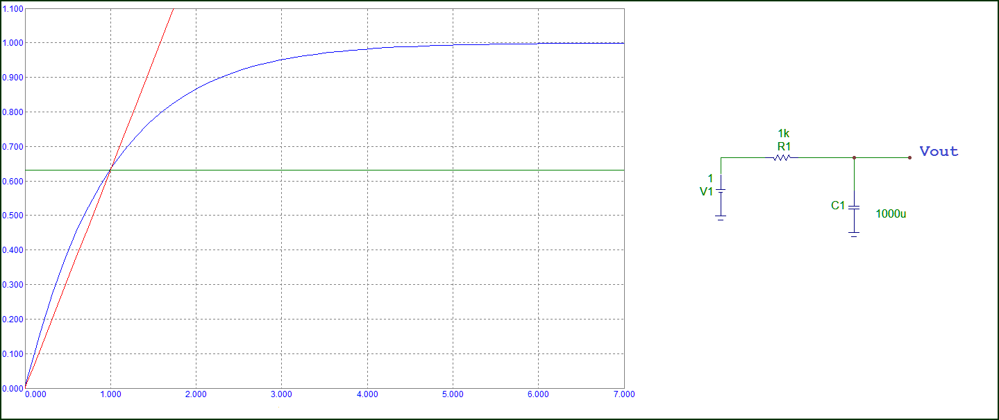

Attached you'll find a graph of a capacitor charging through a resistor excited with a voltage source of 1v DC. The time constant of the circuit is 1 second because R*C is equal to 1000 times 1000uf which comes out to 1.
The first time constant tells us the time it takes the cap to charge to 63.2 percent of the maximum voltage and because the max is 1v during the first time constant the cap charges up to 0.632 volts here. That number is directly scalable so if the max voltage was 2 volts it would have charged to 2 times 0.632 volts (1.264v) after the first time constant.
The blue curve is the actual cap voltage, the red line from zero to the blue curve shows the approximation we often use to approximate the cap charge during the first time constant.
You can see that if you follow the blue line, as time goes on the voltage gets higher and higher and so a higher trip point means a longer time period.
The green line is just the 0.632 volt line which is 63.2 percent of the max voltage and the max voltage here is just 1 volt.

Note that i included a graph of the cap charging in post #51 i think after you already read that post so you can look at that for more information too.
The formula for the cap charging from zero volts is:
Vc=Vmax*(1-e^(-t/RC))
and solving this for t we get:
t = -RC*ln(1-Vc/Vmax)
where
t is the time,
Vc is the capacitor voltage after time t,
Vmax is the max voltage usually the source voltage,
RC is the RC time constant R*C,
"ln" is the natural log function.
For the example i plotted in post #51:
Vmax=1
RC=1
Vc is plotted in blue.

Well, no, the time constant again is R*C and that is the time it takes the capacitor to charge from 0 to 63.2 percent of the max voltage. 63.2 percent is not 100 percent.
The capacitor is said to have charged to very close to the max voltage after 5 time constants which is 5*R*C. After 5 time constants the voltage reaches about 99.3 percent of the max charge voltage. After 6 time constants the voltage reaches to about 99.8 percent of max, which now is very close to 100 percent. After 10 time constants it is up to 99.995 percent of max which for most purposes could be called 100 percent.
The timer period is the time it takes the capacitor to charge from usually 0 to whatever the trip point is set at, which can be anything. So the trip point voltage can be 1v, 2v, 3v, or anything less than the max charging voltage.
If you look at the graph i posted you'll see how this works a little bit better.
So the timer period and the time constant are not the same in general, but in the case that the trip point is adjusted to 63.2 percent of the max charge voltage then they would be the same, but that's only for that one specific adjustment.
Look at the graph i posted and see if that makes more sense.
