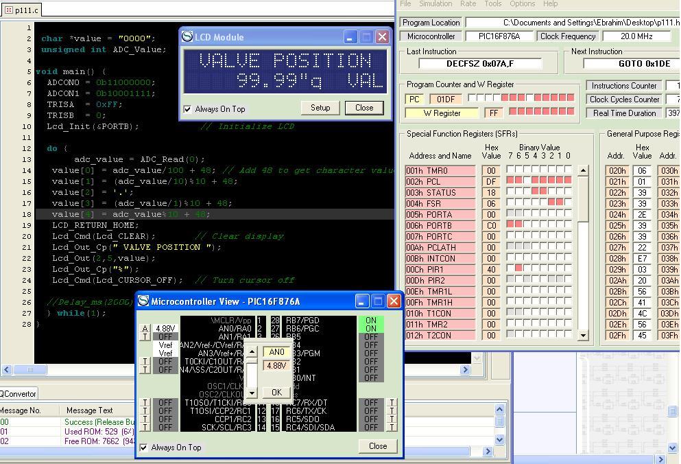

Hi be80be,
I let myself to play with your code as per your recommendations :).
I tried to change the range 0 to 5 volts indication into 0 to 100 %, I did part of that by adding '.' and % sign but failed to change the range.

The code gives a value of 0 to 1023 you have to change it to read volts
Thank you be80be, I've managed to change the reading into 0-100 % range.
I'll use this as Motoroized Valve Opening Indicator. Now I'll try to raise the zero reference from 0v into 1v. Eric told me once it can be done in the software, or shall I make the hardwaew Ref- = 1v instead of 0v ? which will give me range of 1 to 5volts.
my latest resutl is attached

Change the part
adc_value = ADC_Read(0);
To
adc_value = ((ADC.Read(0) + 1) * 500 / 1024);
It works fine using OS simulator ( see attachment in post #25 ) but in real circuit, it shows just black blocks filling the first raw of the LCD. Tried to play with the delay but not succeded. BTW, all the fuses desabled excpt for WRT which set to WRT_HALF and the oscillator set to HS.

The problem was a Hardware issue. The R/W has to be connected to ground, the -Vref (pin#4) has to be connected to the voltage bottom Ref ( in my case Gnd ) and +VRef ( pin# 5) has to be connected to Voltage High Ref. ( In my case 5V ), everything went fine.
I'll post some pictures as soon as I BlueTooth them from my mobile into PC.
Thank you be80be, Eric for your patient and help.
