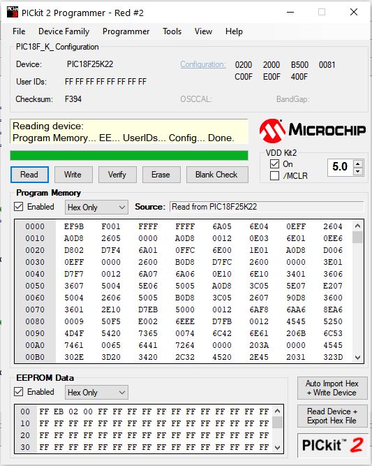

Disregard the image for the time being.
I assume that SFB reads/writes words as you would expect (little endien) and the reading is confirmed by your code. Can you confirm that it writes words as expected?

I'm getting some screwy results that I can't explain as I go a little farther into this. I'm going to remove the post for now until I can verify my results.
