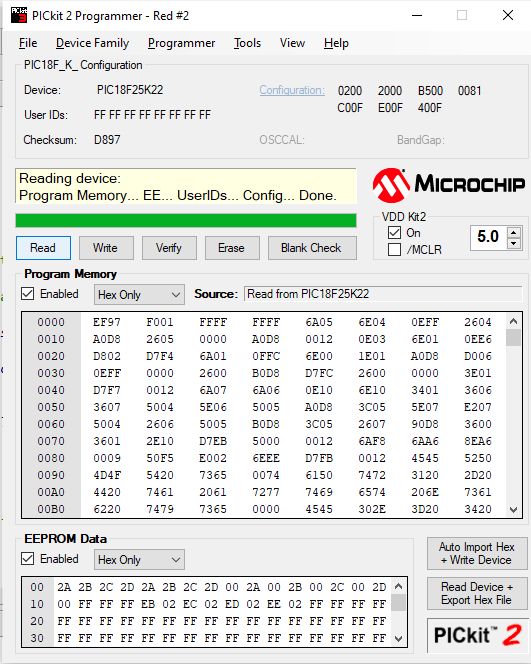

Since MrDEB couldn't be arrsed to try the simple experiment I suggested in posts 46 and 50, I did them. Why? Because I wasn't certain how things would work, and it was easy enough to give it a try and learn a few things in the process.
In part 1, I saved byte values in 4 adjacent EEPROM locations. Reading the values back into a byte variable yielded the results expected. Reading the values back into a word variable yielded garbage of course, because each EEPROM location is byte-sized, and when a word is read, two adjacent bytes are read as a word.
In part 2, I saved word variables, each containing a byte value, into adjacent EEPROM locations. This is of course wrong, as a word requires two bytes. Reading these locations back as bytes yielded the expected numbers, but this is a happy circumstance of the order in which they were written, because stored a word writes in two EEPROM locations. It might look ok during a quick test, but it will yield unexpected results.
Reading these values back into a word variable resulted in garbage, as this reads adjacent cells as a word.
In part 3, I wrote a byte-sized word variable into every other cell. Reading back the values as bytes shows the expected result, the byte-sized number in one cell and a zero in the other (since the value stored was less than 256). Reading the word value from the expected location yielded the expected results.
When word values were read from the wrong location of the pair, garbage was the result, as byte values from two diffent words were combined un the wrong order.
Part 4 repeated part 3 with values greater than 255 (i.e., greater than byte-sized) with the expected results.
Thd output of the tests is shown here. This picture shows the EEPROM values as read by the PICkit 2.

What happens if you do,
dim test as word
test=$1234
EE.write(0,test)
test=0
EE.Read(0,test)
(forgive syntax - may be wrong).
Surely, the value read back is hex 1234.
You seem to be convinced that the EE routines only deal with bytes.
I think they deal with whatever type of variable you use.
Microcontroller EEPROM read and write library. Note that TAddress is byte size for devices that have less than 256 bytes of onboard EEPROM. For devices that have more than 256 of onboard EEPROM, TAddress is a word.
Write multiple items to microcontroller EEPROM. Valid argument types include boolean, char, string, byte, shortint, word, integer, longword, longint and floating point.
Not at all. If a word is saved, a word will be returned as long as nothing else writes over its EEPROM locations. The same should be true for any type of variable.
You can get into trouble in two ways:
¤ If you save a variable of one type and recall it as a different type. For example, if you store a byte variable (one byte) and read it into a word variable (two bytes), you'll get garbage.
¤ If you don't allow enough space for whatever type of variable is being stored (i.e., 2 bytes for a word, 4 bytes for a long word or float), depending on the order things are saved, some of the EEPROM locations will be overwritten and the returned values will be wrong.
Finally, reading the byte values will always show what's stored. The value of whatever variable type was stored can be calculated.
So, what it boils down to is 'garbage in, garbage out'.
The libraries read and write the different variable types as you would expect.
Nothing extra needed except a little upfront planning for what you're saving where just like in any other system.

Am i missing something here , your code can write byte word to EE , then via PK2 or whatever read it take a look see what it wrote ( as the Visitor post #81 ) The SF note states SF defaults to longword for EE write . If SF automatically stops GI interrupts , why does the EE library note state to stop them for other than bytes ?
....The SF note states SF defaults to longword for EE write......
Where did you see this? This isn't what I observed but that may be because of how I did my tests. I set variables dimensioned as bytes or words equal to the values I wanted and then explicitly saved the variable as opposed to a raw number.

Its in a note top of the SF EEprom library ... I loaded SF yesterday , and wondered ..
That'll be if you send constants.. The compiler won't be able to classify it... EE.write( 0, 23) will be the default... The trouble here is the read will have to be a longword even though the amount is tiny...
Mrdeb should test raw numbers
And format the Result for printing
Code he posted was saving everything
His last code posted was much better
But I would only read and write as needed pull out old value at start of game save at end there no use of using eeprom while playing game you get the writes in loop you'll ware out the eeprom
It doesn't work that way. It evaluates the const and calls the appropriate routine
EE.write( 0, 23) uses a byte write, EE.write( 0, 1234) uses a word write, etc.
EE.Write() is a generic routine and calls different underlying code based on what you pass it.
If you want to write constant values like that it would be a lot safer to use the specific 'WriteByte, WriteWord, WriteLongword' etc calls.
Let me try this again.
When it does the low-level 'write a byte to eeprom' routine, it automatically:
- saves the current GIE
- disables interrupts
- writes the byte
- restores the GIE setting that was in effect when the routine was called
All of the upper level routines end up using that low-level function at least once and maybe multiple times.
For example, writing a longword (4 bytes) will call that routine 4 times.
If interrupts are enabled before the "EE.Writexxx()' call, then they'll get disabled/reenabled, disabled/reenabled, etc four times as it writes the four bytes.
That means that you can get an interrupt in between each of the 4 individual byte writes. That can cause issues or not, entirely based on YOUR code. If it's important that the entire 4-bytes is written without interruption then disable interrupts, call ee.write, and then reenable interrupts.
Make sense?
