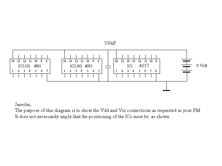

As promised in the reply to your PM, here is the Vdd, Vss connection diagram

Jaseslin,
As I said in my PM, I only have a old version of Electronics Workbench and it cannot open your file.

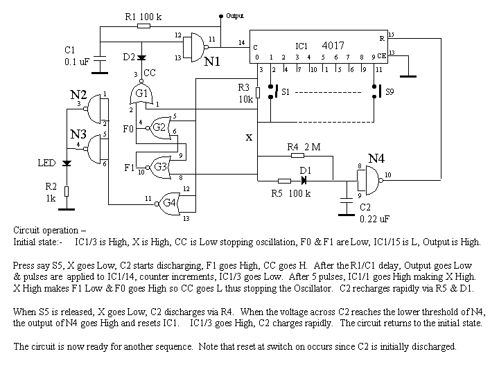

The file is a layout of the circuit I posted above on May 15 - Pulse Generator1.png

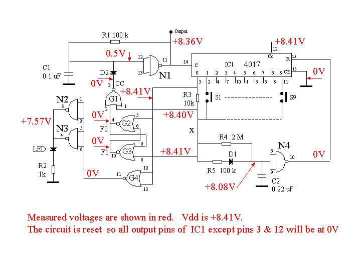

Jaseslin,
As I said in the PM, here is the circuit I am using. Your voltage measurements do not reconcile with the pin numbers shown in this diagram which is based on the bit map you posted on May 22 as pulse_generator_1.bmp.

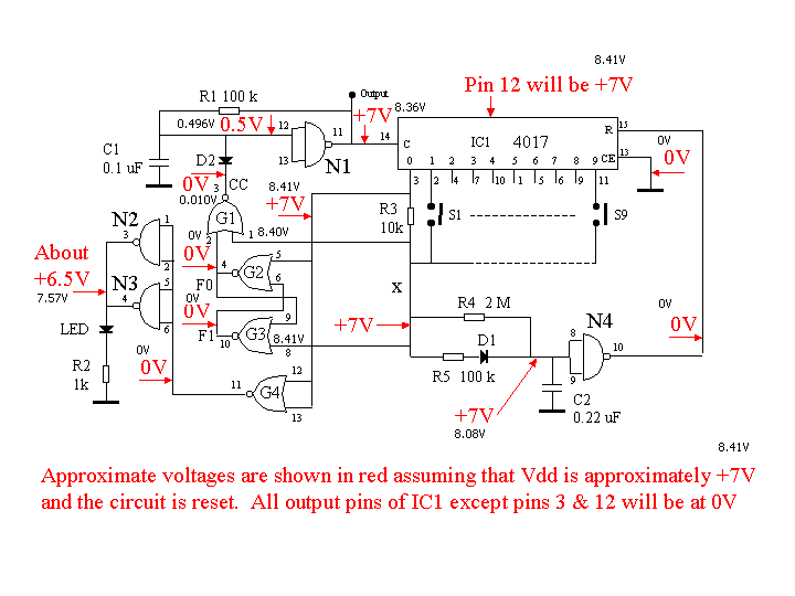

Jaseslin,
I have altered the drawing to reflect the voltages you measured (as posted on 24 May).

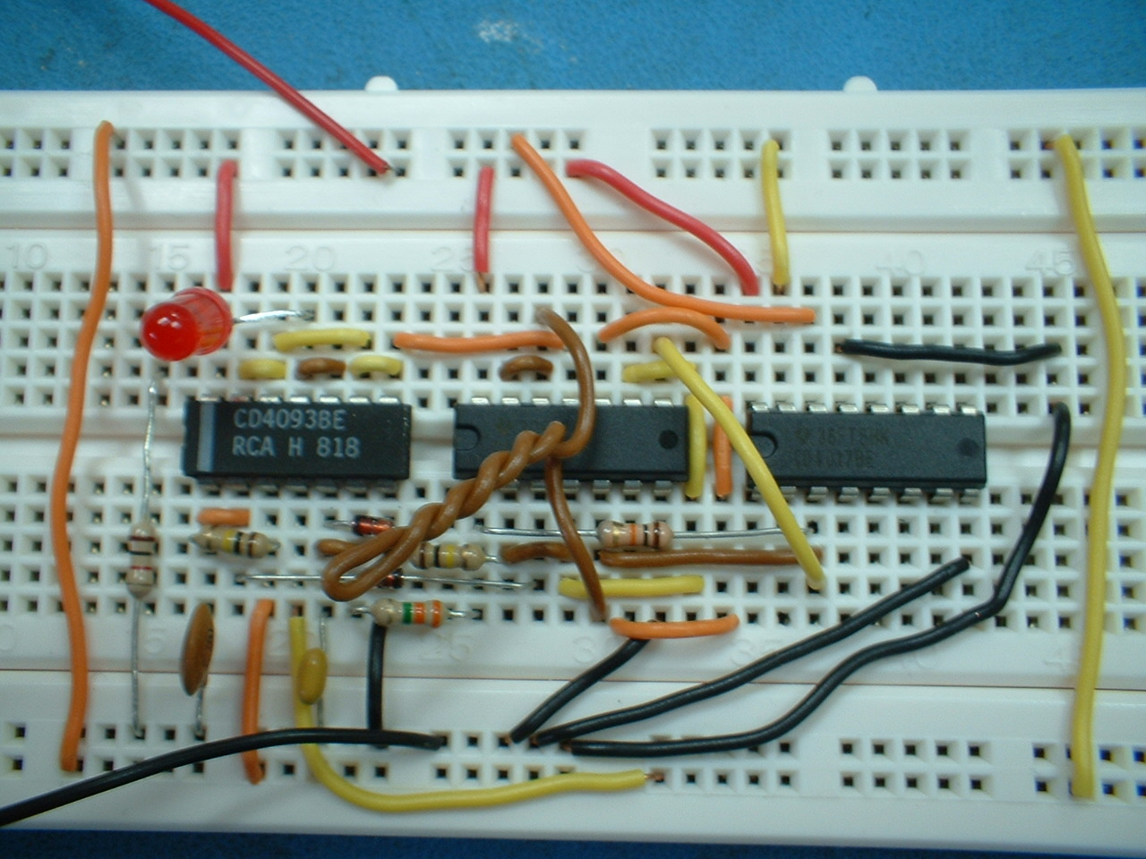

Hi Len :)
Here is the picture.**broken link removed**
Hi :)
I've tried on the oscilloscope but all i get is just noise..
may i know wat's is still wrong with the ckt?
thank you...
really desperate,
Jaseslin,

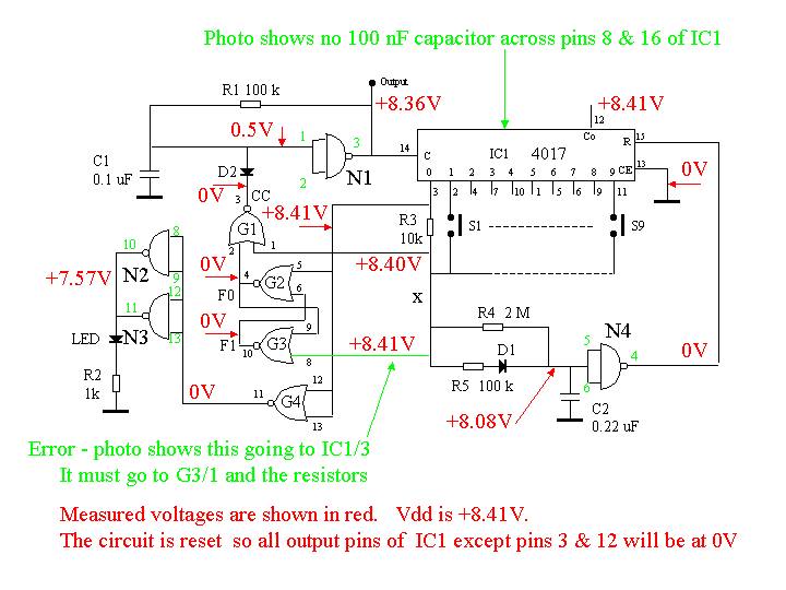

Your photo shows that you have made some errors in the wiring. So I have altered the circuit to show the differences in green.
Differences in pins numbers (compared to what I posted last time based on my understanding of your earlier post) won't matter but the errors will.
Note there is an error in the diagram, I should have written G1/1 not G3/1.
