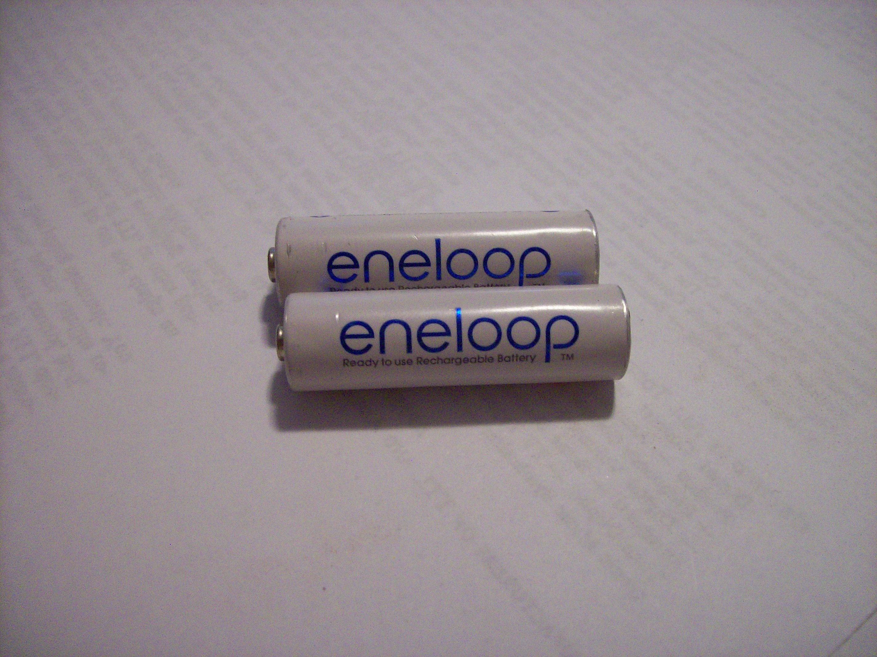

Guess what caused the improvement in the capacity of your batteries?
1) Overcharging or undercharging like when they were bad.
2) Charging until fully charged.
3) Discharging then fully charging.
DAMN #$%& I forgot about my batteries they charged for 22 hrs. I absolutely need to buy a charger that turns off automatic. Batteries are slightly warm, meter reading 1.483v each. Batteries are working good.

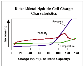

Good quality chargers use a Ni-MH charger IC that detects the voltage bump at a full charge then shuts off.

A modern Smart Charger for Ni-MH batteries knows that the cell heats as it charges then it heats a lot more when fully charged so it adjusts the current and shuts off to take care of heating.
Did you know that a Ni-Cad cell actually cools as it charges then heats less than a Ni-MH cell when overcharging? That is why a Ni-Cad can be safely trickle-charged at 1/10th its capacity.
