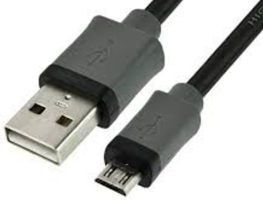

USB type A is the rectangular connector that typically plugs into a computer, USB power supply (line voltage AC or 12VDC types) or USB battery packs. The picture shows a cable with a type A plug on the left and a micro-B on the right.

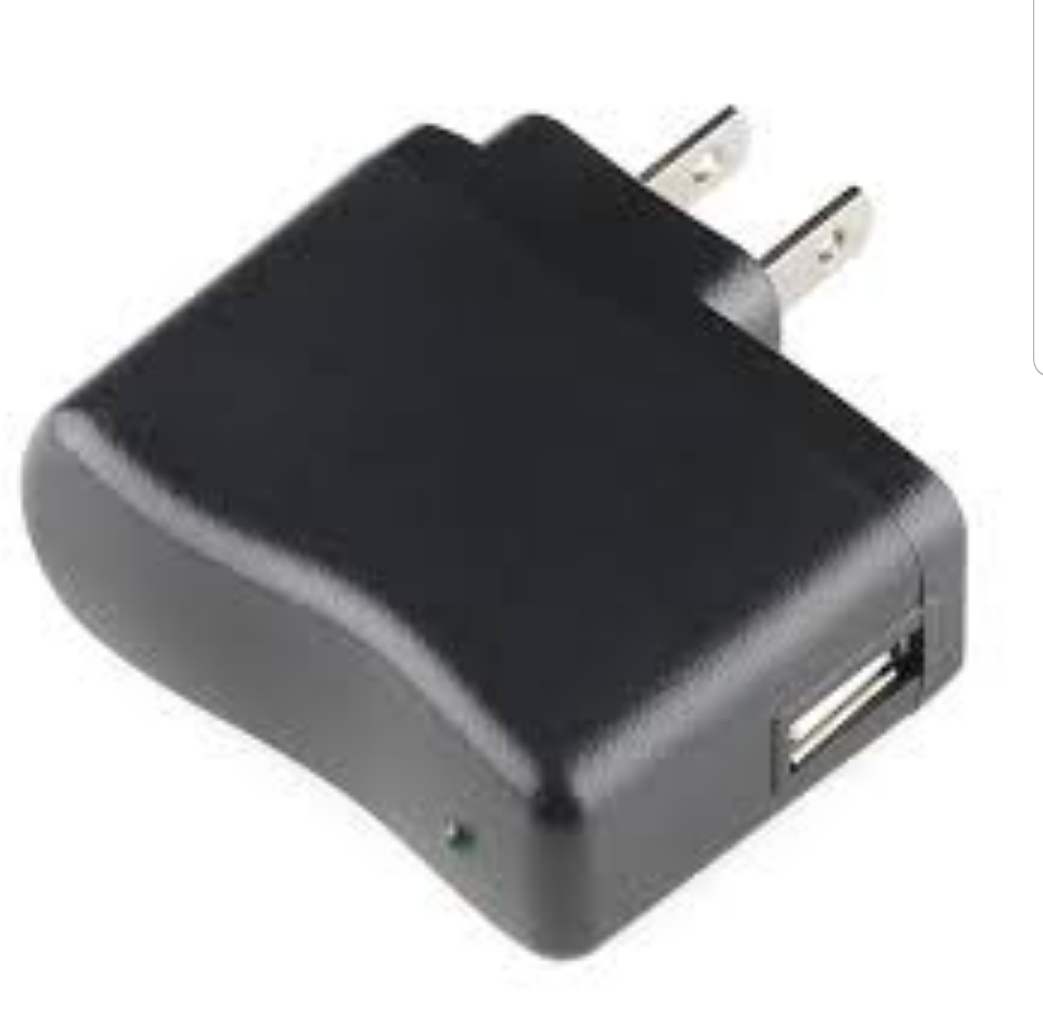

A USB wall wart is shown below - this is a typical 120VAC version.
Plug the cable type-A plug into this power supply and the micro-B into the battery charger.

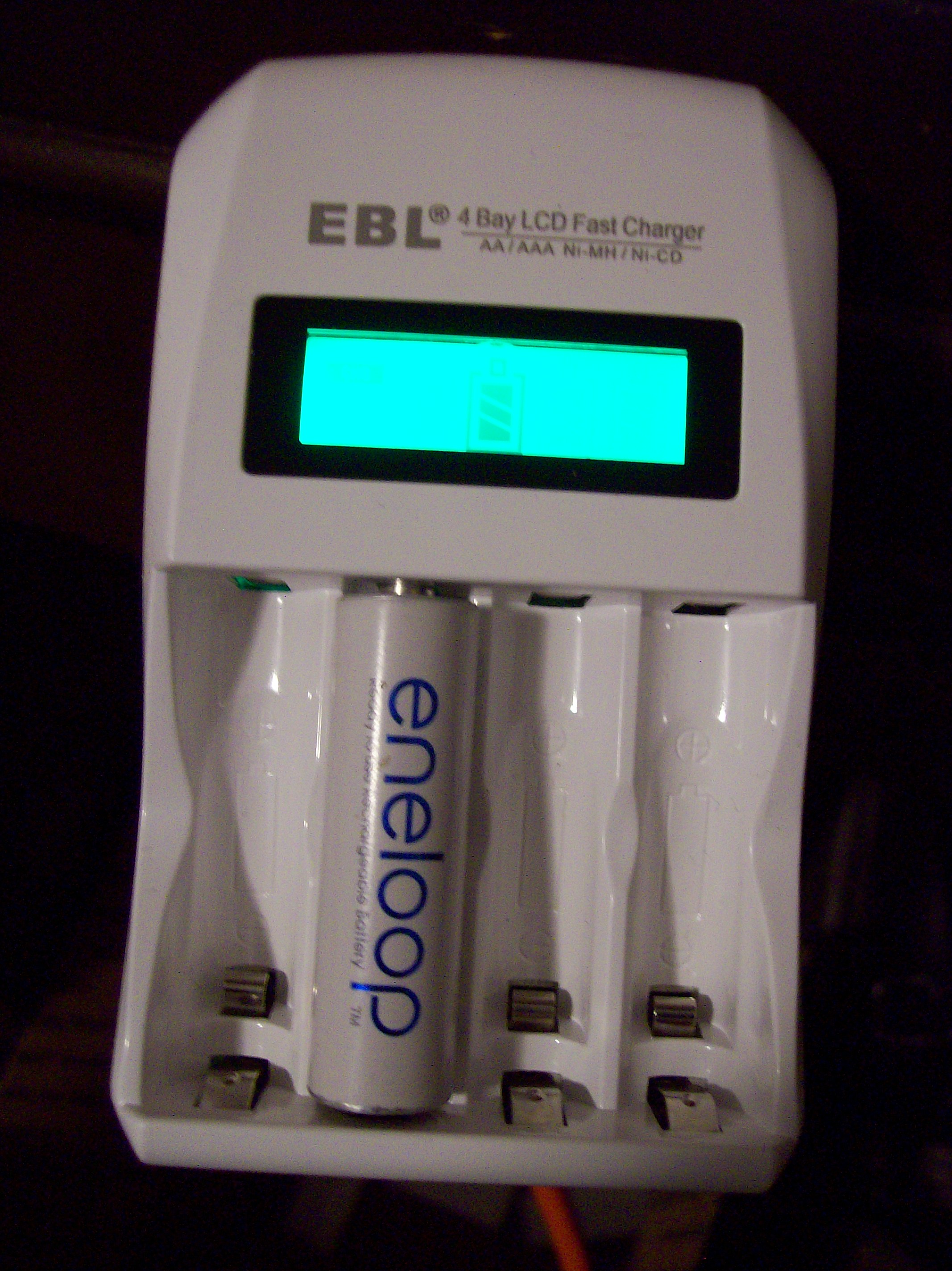

I like this new battery charger it shows me how much charge each battery has, how low they are, how fast they charge. when they are fully charged. I have marked my batteries, A B C D and have noticed while using these batteries A C D go dead but B does not go dead. I use C D in the camera they lasted about 2 weeks charge shows them both dead. I use A B in the camera they lasted about 1 week charger shows A is dead B has a full charge. Question is does B have a problem because it does not go dead OR does A have a problem because it does dead first?
Next thing to try is put B C in camera to see if B stays charged and C goes dead first?
But maybe A C in camera will snow A has a problem if it goes dead first?
Volt meter shows A=1.32v B=1.48v C=1.33v D=1.34v
All 4 batteries in charger shows A C D need to be charged and B does not need to be charged?
Batteries appear to be in series in camera how can 1 battery use all its power while other battery stays fully charged?

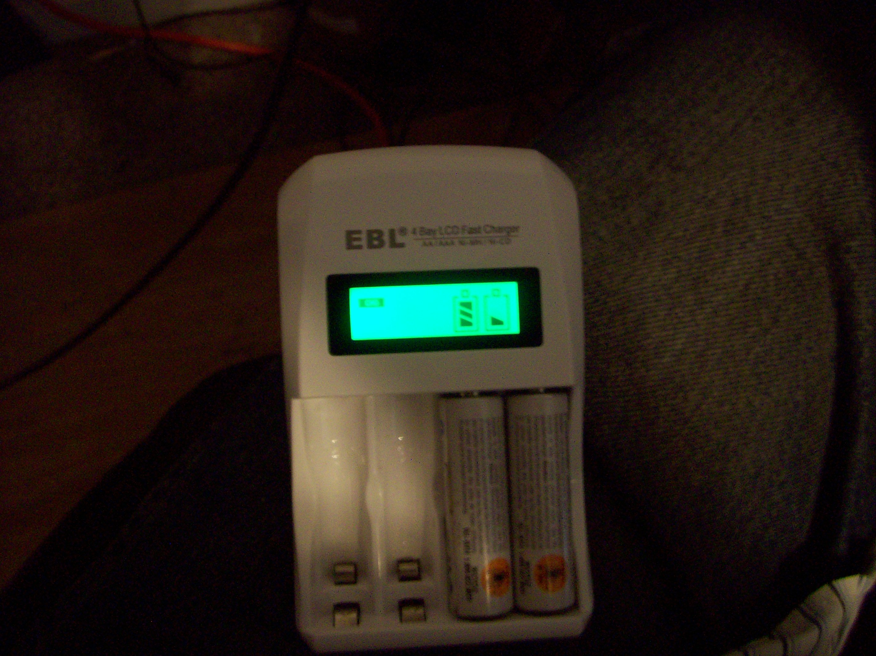

The reason there are only 2 batteries in the charge is because I have to use 2 to take this photo.
118966
It looks like your new charger has a problem showing or detecting battery B voltage.
I have learned if I discharge a battery too low the new smart charger will not recognized the battery as being a battery. I have to use the old stone age battery charger to charge batteries for 20 minutes to get the new smart charger to recognize battery is not a block of wood so it will charge it.

I would disagree :D - it's 'smart' enough to know that the battery has been discharged below what it should, so dismisses it as a ruined battery.
It is a Ni-MH battery, not a lithium battery. A Ni-MH battery is fine when completely discharged, but a lithium battery is ruined.
