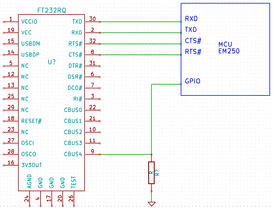

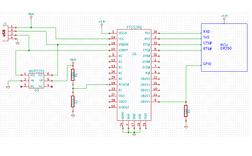

I have a PCB that (among other electronics) contains a EM250 ZigBee module connected over the UART interface with a FT232 FTDI IC, as shown in the second attached figure.
The problem is that due to this connection the power consumption of the PCB is higher than I expected. The FTDI is power from the USB bus (and not from the power supply of the PCB) which is however not all the time present. Thus, I assume that the high power consumption that is measured only when the USB supply power is not present comes from current throwing from/to the pins of the EM250 to/from the pins of the FT232. I have tried all possible states of the pins of the uC but could not go too low in the power consumption (the best is around 700uA, while around 200uA was expected).

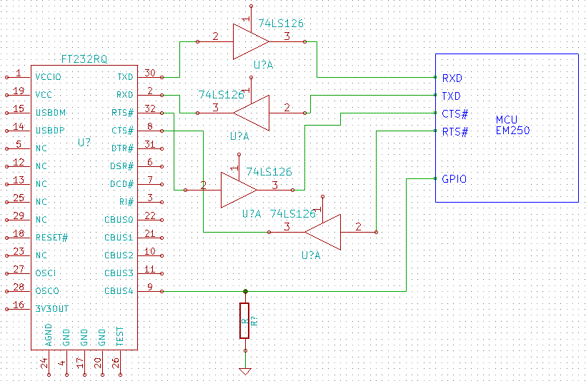

To reduce the power consumption further, I was thinking of making the modification shown in the first attached figure, thus adding some buffers between the two ICs that are going to be activated only when communication is required (when the USB supply power is actually present) and remain deactivated otherwise.
Do you think that this will work? Do you have any other alternative to propose me?

Fairly obviously if you switch any output lines feeding the FTDi chip to ground, then no current can flow that way - and if you ground any input lines (just to test it) then that will prevent any possible CMOS input problems (assuming your processor is liable to such problems?). If that doesn't reduce the current, then it's not a problem with the FTDI chip - and you need to look elsewhere.
Have you tried it with the FTDI chip removed?, try that and see what you measure.
Certainly in my experience it's VERY, VERY hard to approach the claimed consumption figures.

I'm sorry Nigel, I haven't understood your suggestions, that first part of your post talking about switching the lines to ground. You mean to switch all UART lines between the two chips to ground? But how to do that? By driving them from the uC to output direction and LOW state? There are some input lines, going into the uC, as well. What should I do with them?
Yes, exactly that.
Solder a temporary wire down to ground from each input pin.
But just do the outputs as above first.

That's massive overkill, and really a very poor solution :D
I'm assuming you're leaving pins output HIGH on the processor?, which would be the default position if you're leaving the UART running. If the FTDI chip has protection diodes?, then it will power itself via those protection diodes.
Curing it 'may' be as simple as disabling the UART?, but disabling it and setting the pins LOW should prove it quite easily.

There is no way that the power consumption comes from anything else on the board, because the problem is solved when I remove completely the FTDI chip. I have attached my complete design regarding the FTDI.
Is it possible that something is cause by that protecting diodes between the USB plug and the FTDI? I should try to remove them and see what's happening.

Well, just to update you. I've solved the issue.
The secret was that during sleep, the internal UART module of the uC should be deactivated and the relevant pins (TXD, RXD, RTS, CTS) should be configured at input direction with no pullup/pulldown. With this settings, I have managed to achieve the lowest possible current consumption (~100uA).

Nigel I'm sorry, I had forgotten to reply to that question.
In fact, I had configured the outputs to LOW state and then measured the voltages on these pins. Well, it was a little weird. Sometimes it was 0 and then some other times it was HIGH. And I think that this had something to do with the RESET state of the FTDI. And whether I had previously connected the USB plug or not. In fact, I had read in some application note of the FTDI for some previous version of the chip that during reset the output pins (from the side of the FTDI) were pulled-up weakly. I had the same problem in a previous design too. I had tried then all combinations for the uart pins (outputs with HIGH/LOW, inputs with pullup/pulldown etc.) but in the end my mistake was obviously that I didn't disable the UART at the uC.
