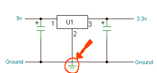

Things are starting to look quite promising, I like the look of that new diagram a lot. I presume the chap which I've circled in the diagram (below) is the 5K Pot- my understanding is that this is basically a variable resistor, is this right and is there anything particular I should know about them?
I'm afraid not!.
The diagram is for a fixed regulator, the symbol you circled is a 'ground' symbol - also the diagram should have a 'dot' just above it, to show the horizontal and vertical lines join.
oh yeh
Ok, now I feel stupid. I'm just going to print myself out a list of circuit diagram symbols so that doesn't happen again...

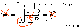

..right, I'm back in the game. I've taken the original circuit diagram (for a variable output current) and just crossed out what you suggested might be unnecessary capacitors and circled the 'Pot' (hopefully I've got it right this time). Is what I am left with (i.e. without the 2 extra capacitors) a suitable circuit to use if I want to adjust the output voltage? and back to my point pre-getting-the-circuit-symbol-wrong, is there anything particular I should know about 'Pots'?

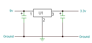

lol, sorry, my fault.
as you had said you were going to go for a fixed regulator, thats what the diag was for, I just though it might tidy up all the bits and bobs that have been brought up the thread. I should have pointed that out.
Not sure why the dot didn't appear (I really need to get a different circuit drawing package, Tina is rubbish...)
Yes.
There isn't much to know about pots, except, which legs are which! lol, on the diag, the part with the arrow is the middle leg, it doesn't matter which way round you connect the other two (one of them is unconnected anyway). But hang on, if you are going for the fixed regulator, you don't need the pot, thats only in the circuit for the variable regulator...??

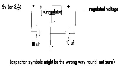

Not sure if my 'advisors' about this topic are still out there, or will read this thread again, but things haven't worked out quite as I thought so I need some advice again if that's ok...
Whilst the 5v voltage regulator was working ok in terms of producing the required voltage with a normal 9v battery, when I tried it with a bigger 8.4 volt radio-controlled-car-type battery the output from the voltage regulator was actually higher which meant it didn't work the device I am building. Anyway my conclusion was that one of those 3 volt voltage regulators might be just the ticket for my needs (even though the posting from RS is a bit on the steep side) so I ordered some and tried wiring one up in exactly the same way as the digram given before (see diagram at bottom of this post) with two 10 uF capacitors, but didn't get 3volt output, in fact didn't really get any output at all, all a bit weird. Is there something I'm missing here, or does this voltage regulator require a different wiring set-up? the voltage regulator I'm talking about can be found at the RS website, and has the stock number 349-4543

The purpose of a voltage regulator is to regulate voltage. In layman's terms, it outputs a fixed voltage as long as the minimum input voltage requirements are met. The input voltage may change drastically, but as long as it's above 7V, the output should be around 5V for a 7805.
1. Ensure that the correct terminals of your 8.4V batt are connected to the 7805.
2. Ensure that the batt is giving out the correct voltage.
3. Ensure that your 5V and ground are not shorted.
4. Change a 7805 if all the above are satisfied.
Anyway, go to **broken link removed** and download the datasheet for the LM1086. Ignore all the crap but the diagram on very 1st page. You can see that the pinouts are different from a standard 7805. Modify your circuit and it should work.
Go ahead and dip your feet into some beginner electronics. I believe that's what got all of us started. :D

Ah, right, I think the different wiring set-up is where I went so massively wrong- didn't even realise the top of a voltage regulator could be one of the inputs/outputs! In terms of my previous circuit diagram would I therefore connect the following bits to the following pins:
Vout= This is where I take the +'ve regulated voltage from
INPUT=This is where I put the +'ve unregulated voltage IN
'OUTPUT' and 'ADJ/GND' = Not sure what to do with either of these- is GND short for 'Ground'? If so is this where I connect both the input and output ground terminals to? sorry, I'm all confused because what do I then do with the OUTPUT terminal? It may be explained on that sheet you suggested, but I feel that I may not be able to understand the way it's presented and some of the terms used
i'm a bit supprised that you have an output terminal... I shall have a look at the data sheet when i have a free moment
'ADJ/GND' GND = Ground (as you suggested), ADJ = Adjust.
Normally, with a fixed regulator (as you had originally), the 'gnd' pin is connected to ground. Ground (in this instance) is the 0v (or negative) connection on the battery. This should also be connected to the 0v rail in the circuit you are powering.
However, with an adjustable regulator, this pin is connected to a pot (usually), which is used to adjust the output voltage - hence the pin is renamed 'Adjust'

err, had a look at the data sheet, and it says that 'Vout' is the tab, and the 'output' is the middle pin. Someone may say that this is wrong, but personnally, I'd be tempted to try it using the 'output' pin as the regulated power, and leave the 'Vout' tab unconected. If it doesn't work, I was wrong!! Then if you heatsink it, make sure it is isolated from any other regulators.
I am assuming that your regulator is a T0220 (looks a bit like a flat transistor)? Because in my experince, having the tab as one of the conenctions on this style of case is quite rare. (You see it all the time on TO3 style cases, but not so much on T0220)
Good call Tim, you were right- tried it last night and the output pin does appear to give the regulated voltage output, so thanks a lot. Supposedly then if I want to attatch a heat sink I can attatch it via the Vout tab at the top which should conduct the heat into the heat sink?
