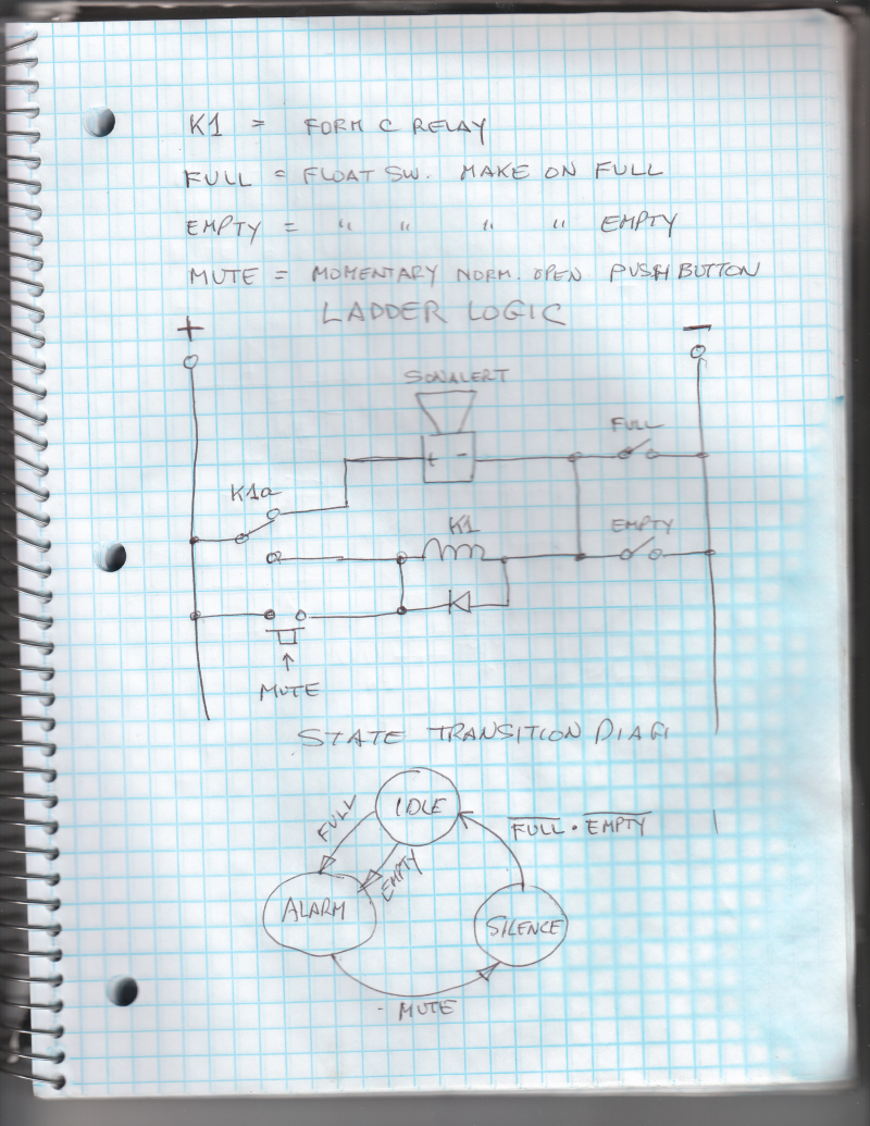

Dear Sir,
I have same type of small relay circuit requirement. My requirement is described as under
What I need is connection diagram for 3PDT relay in order to solve my trouble.
Project Description
1) I have a tank with float switch fixed on it & I need High & low level alarm box, i want a common buzzer and common muting switch for the both the level alarms
2) I have float switch with two levels high & low, both floats are NO type. i can reverse it to NC also
3) i want a buzzer to buzz if the low level switch is closed. This will happen if tank is getting emptied
4) I will mute the alarm by a muting switch, the alarm should be reset with this action.
5) If the tank is getting filled and high level reaches then high level alarm should buzz
6) I will mute the alarm by a muting switch, the alarm should be reset with this action.
Please let me know what additional information is required from my end.
Welcome Parag,
you can do it with a single pole relay as shown:
On the State Transition Diagram, there is an implied return from ALARM to IDLE on the (notFull and notEmpty) = somewhere in between condition.
Welcome Parag,

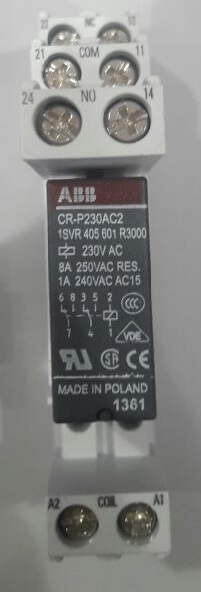

Hi Mike,
Thanks for quick help but my circuit is 230 volt. I wan to use a relay which is as attached. Please advise me if i can still go with your diagram, else suggest me based on my reply. I am not so expert into electrical, hence want to clarify before I proceed.

Hi Mike
Understood your concerns. Just want to let you know that this is relay ratings (220 volt AC), Signal from the level switch is low voltage only coming as NO or NC. The reason I don't want to use power adaptor or transformer is I don't want system to fail because of failure of Transformer OR power adaptor.
I have diagram from supplier but I am looking for common buzzer & common muting switch.
But I appreciate your reply and concerns, I will think in that direction also. Letme know if you can support me in my direction of working on this project.

If you put your float switches in series with a 230V relay coil as I show in my diagram, what is the voltage across the float switches when they are open? The voltage across the float switches will be "low" only if the primary power to the circuit is low.
So use a high-reliability "control transformer" as the power source...
If you elect to go with 24Vac, then do not use the diode, and get a "buzzer" or "sonalert" that works on AC instead of DC
