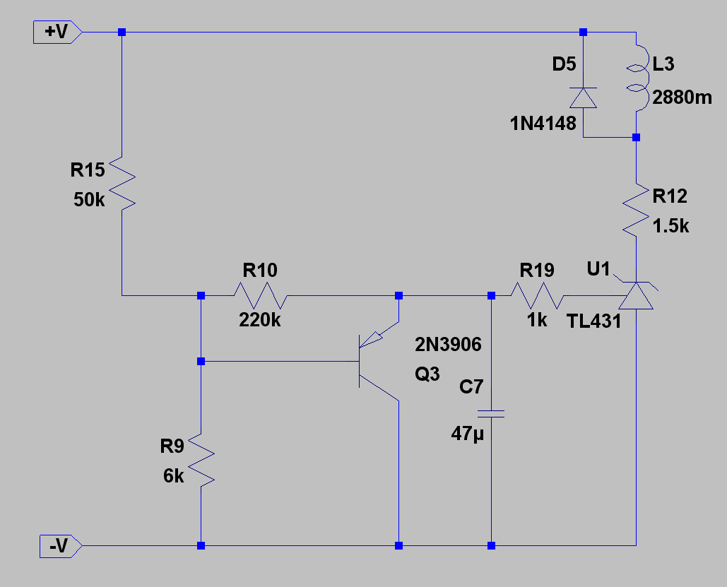

I'm wondering if you could double check this circuit.
I would like a delay before relay turns on, and a fast 'reset' time. Less parts the better, due to space restrictions.
I'm using this for reference, **broken link removed**
Will I need an extra 1k resistor between the 47uF and Vref pin? On simulation I'm only getting 3uA max. (not sure how 'real-life' this is)
Any 'tips or pointers' much appreciated.

Your ref link says the 1K is required, if the cap is charged and the main power rail disconnected its possible that the cap could discharge thru ref pin.!

Ah ok, I'll try and squeeze him in there.
Also, on a related note, I also want to use this circuit over +-16V. I assume the reference pin is 2.5V in reference to anode?
So would this circuit work ok? Again, simulation seems ok.

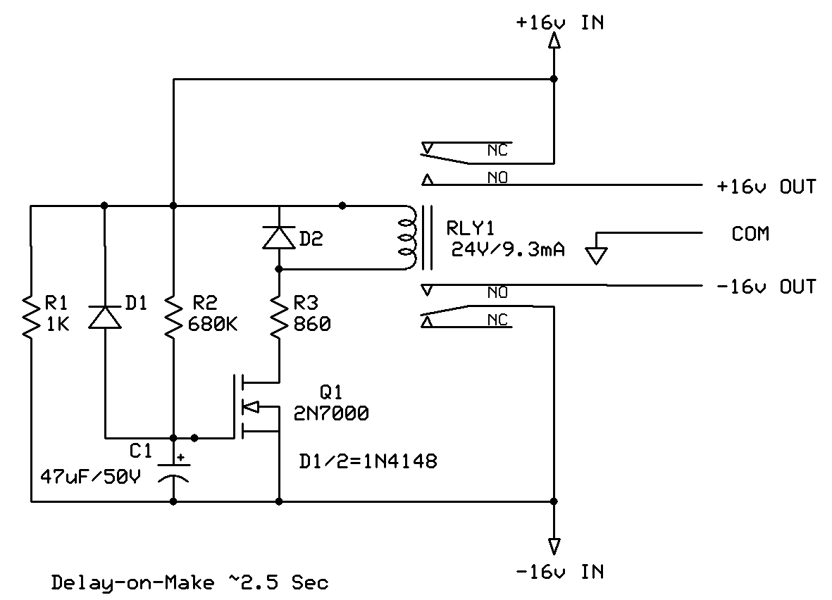

This has worked for me.
Should work on a 16VDC supply with a different relay. Play with R2 and C1 for the specific time delay you need. A non-logic level MOSFET might give you a longer delay.
Ken
Yes! But there was no indication that a precision delay was needed. Variations due to temperature will likely be present in all RC timing circuits.

In your LTS sim circuit you are showing a 2880m relay coil inductance!, thats 2.88Henry.???
haha.. yeah coz I wondered since BJTs are extremely sensitive to changes to the base current.. so I thought that MOSFETs might be so too in the case for it's gate voltage... so when the capacitance changes and so on.. well you know.. :)
mrd,
By "+-16V" do you mean +16V>Common>-16V...so there is 32V between +16V and -16? Or do you just mean that the supply is 16VDC?
Ken
Hi. Sorry for vagueness. Its 32V between them.
Power supply is dual 16V. +16V and -16V with ground in between.
So, can the delay circuit be powered off of one side of the supply...+16v to ground? And, does the delay to the relay occur when the +/-16V supply is turned on? Or, is the +/-16v supply always on and there is a switch between it and the delay circuit?
Ken
Hi. Thanks. No switch. Its more that I'd like a delay to let the powersupply up before putting my load on. Ideally I'd like it across +16 and -16 rather than one side and 0V but if this can't be done then sure. Is it possible to use it over +-16V do u think?
Thanks again
Not bench tested, but I think this should work.
Ken
